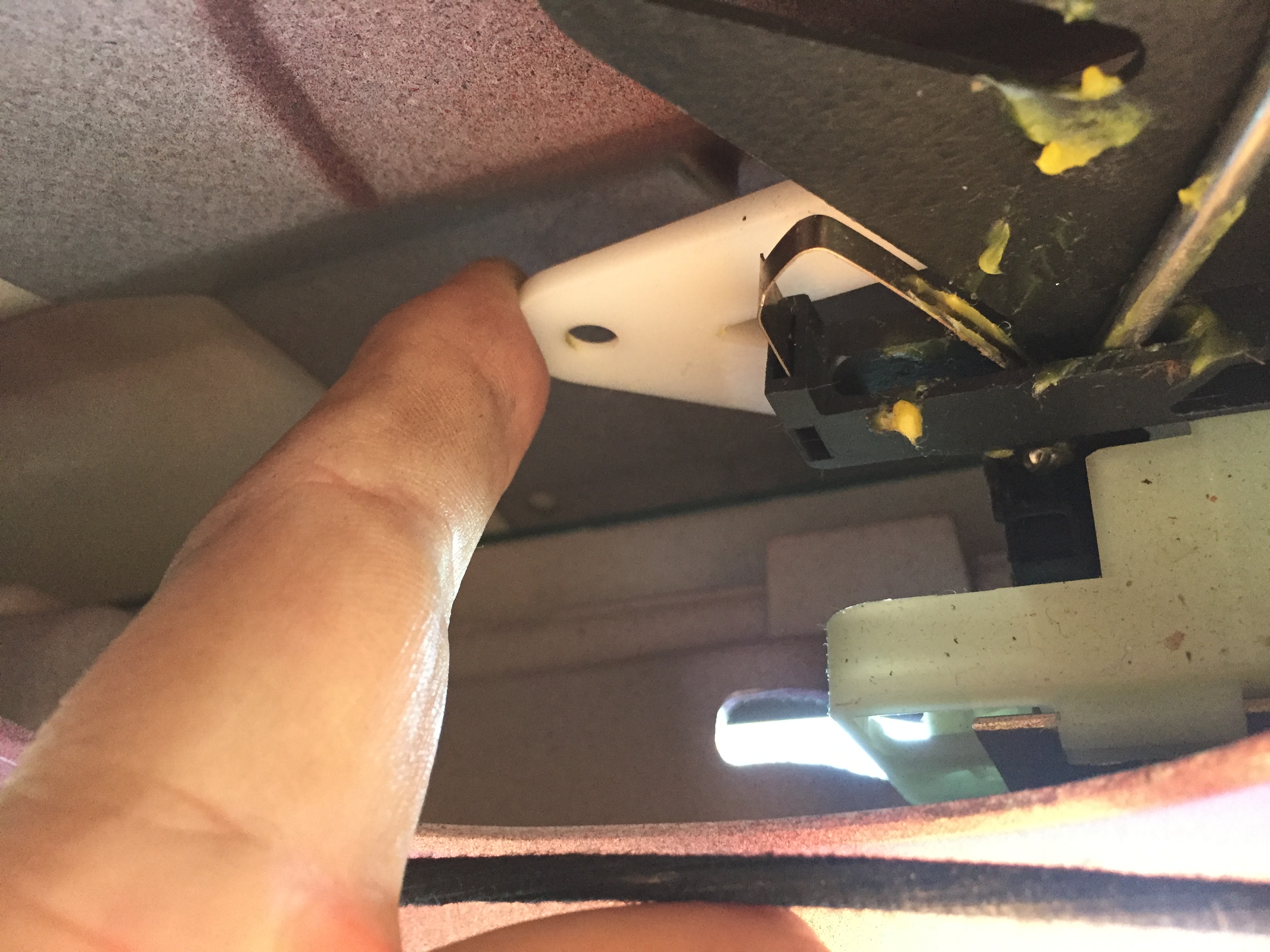

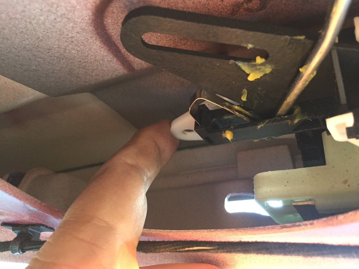

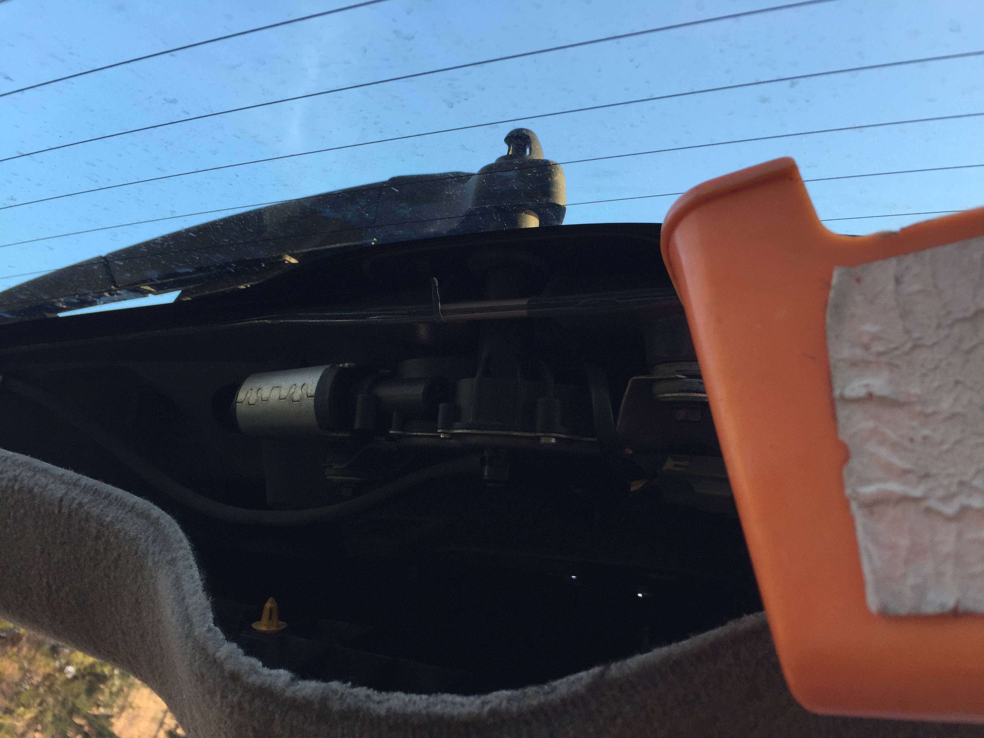

Nope, bad solenoid. By coming in from the top, using a wedge, I was able to ease the trim down, and push the lock latch from right to left to unlock the tailgate.

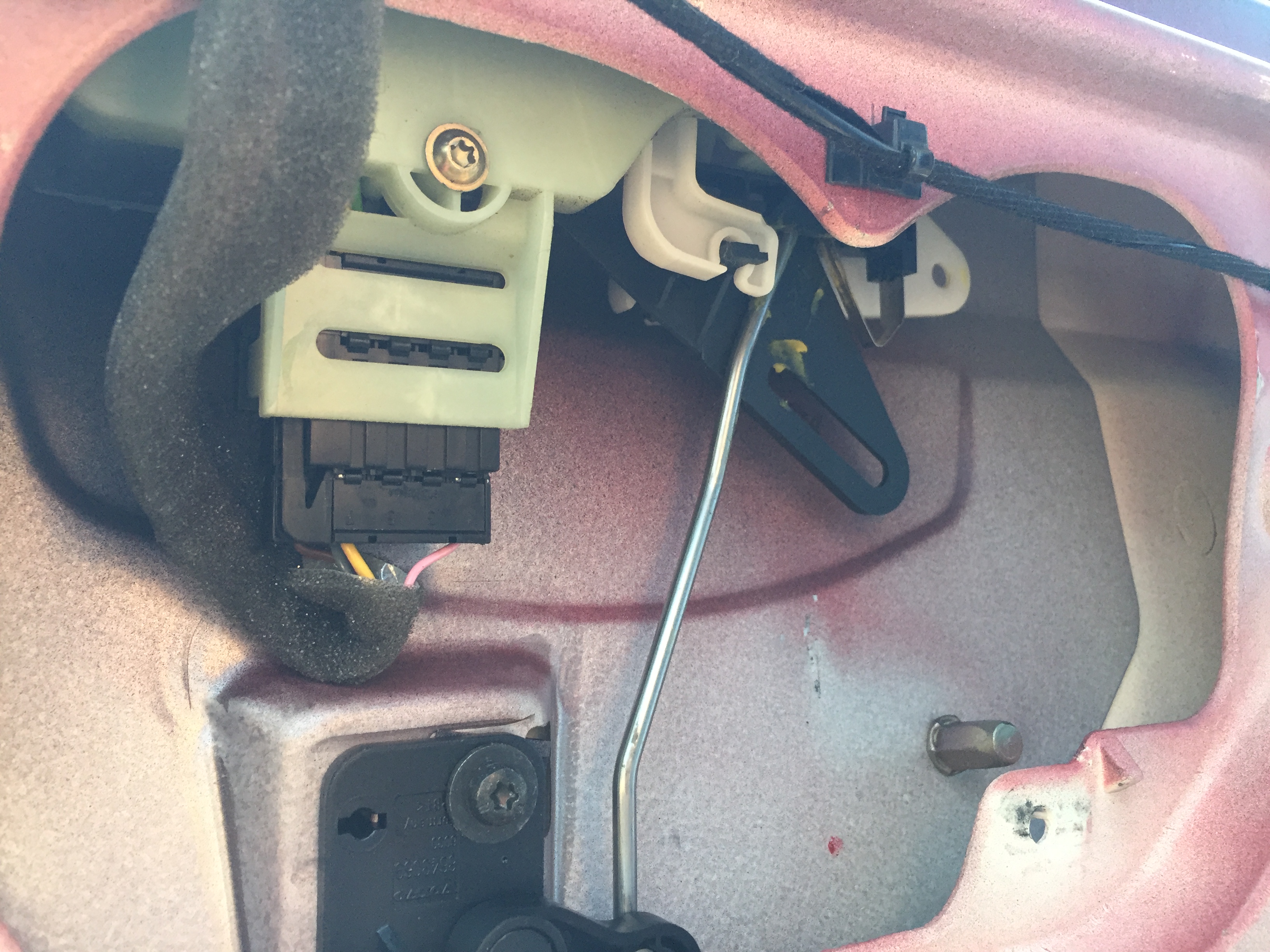

RickHaleParker wrote: 06 Apr 2019, 23:31 While you got it all open, Is it possible to route an emergency pull release?
It sure is, and great minds think alike...here is the action you have to perform. You are blind doing this from the trim loosened as above , so you have to feel for the white plastic triangular piece and push it from right to left ( car coordinates)
What that does is bring the release latch into line with the plunger, red arrow. You will hear a gear sound when the plastic part moves then a thunk when it’s in place.
You then push the plunger down from up top (easily visible) and Voila!
I might just put a 2 cm hole and plug in this so I can move the white locking lever with a screwdriver if needed, I’ll put dimensions on this up of course
