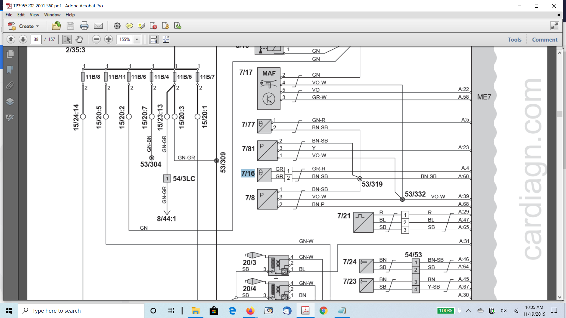

Thanks Rick, I will do that. Do you know off hand if the harness that the sensor plugs into has two prongs? I notice that the sensor has 2 female connections but the harness had just one. I was figuring it may just ground to chassis but perhaps that is the issue.

The wiring diagram shows two wires going to the ECM. One of the two is shared with three other sensors. Keep in mind if any of the four sensors pulls down that line you loose all four.highmiles wrote: 19 Nov 2019, 08:05 Thanks Rick, I will do that. Do you know off hand if the harness that the sensor plugs into has two prongs? I notice that the sensor has 2 female connections but the harness had just one. I was figuring it may just ground to chassis but perhaps that is the issue.
7/16 Coolant temperature sensor.
7/18 A/C pressure switch.
7/77 Air intake temperature sensor.
7/81 Intake manifold pressure sensor.
