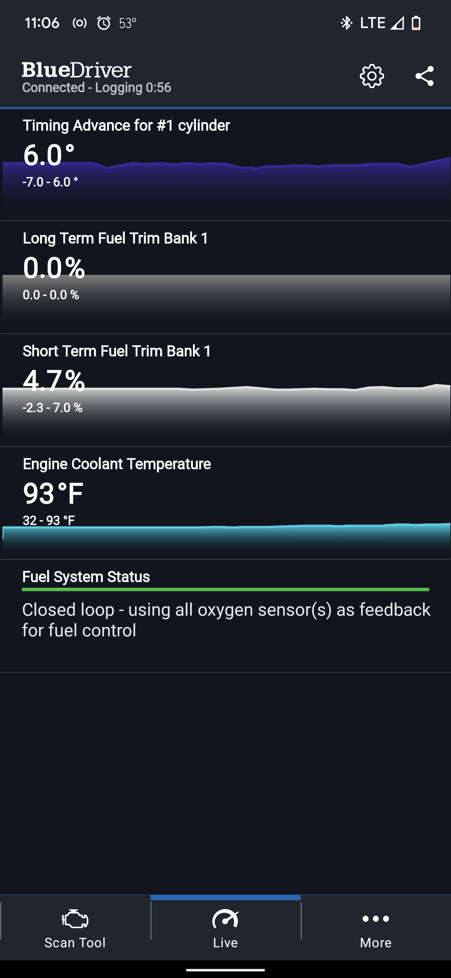

9. Blue driver Data : Code P0328, knock sensor bank 1, which as I understand it is a sensor code not a mechanical code, eg sensor is bad or picking up something it shouldn't, however engine IS knocking.

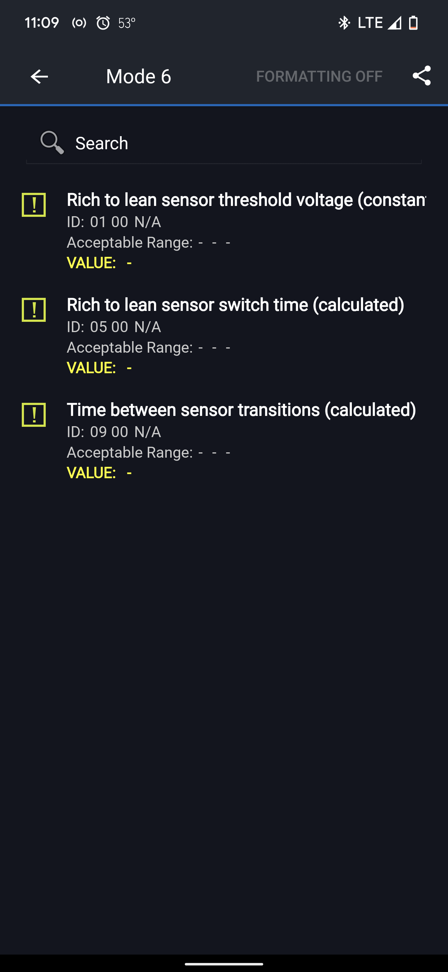

I've attached screenshots from the reader, what is this on the "Mode 6" screen? I've read about lean fuel mixture causing misfire, but these line items I can't click into or even read the full title.

If you have sparklies then something has gone wrong. If you are getting a rod knock then the mains are probably toast.
Probably cheapest route is a used engine.

Upload a short video of starting and running. I’ve learned descriptions of engine noises are not reliable for troubleshooting
