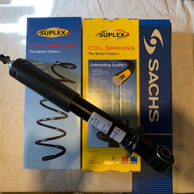

Starting to collect parts and tools for the rear suspension service. Suplex coil spring was recommended for its quality over Lesjofors.

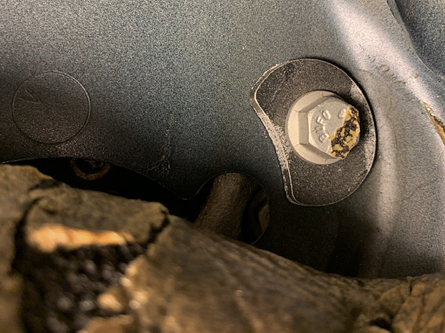

Rear wheels are off, and ratchet strap is installed keeping the control arm in place before loosening the bolts.- Pete - wrote: ↑14 Apr 2020, 06:59
The only bolt you need to remove from the top to free the strut from the car is the one with the “half moon” shaped washer. The other 2 large bolts you remove from underneath. Once the strut is out & on the bench, get your spring compressors positioned & tighten them down until the top hat is free from tension. Then and only then can you remove the center top hat nut to replace the shock.
Does the rear strut assembly mounting on 2001 V70XC has the top bolt with the "half moon" shaped washer. I am not seeing any from the cargo area -- with third row-seat.
- - Pete -
- Posts: 960
- Joined: 6 December 2013
- Has thanked: 80 times
- Been thanked: 175 times
It should have it. You need to remove the “front” lift-up panel/third row seat back, then remove carpeting/noise damping insulation underneath. Then you should see some (2) gray circular foam pieces on the L & R. Pull those off and underneath you should be able to catch a glimpse of the half-moon washer & fastener heads.

Found it -- nicely hidden under the layers with Volvo quality. It has never been exposed.- Pete - wrote: ↑22 May 2020, 07:24 It should have it. You need to remove the “front” lift-up panel/third row seat back, then remove carpeting/noise damping insulation underneath. Then you should see some (2) gray circular foam pieces on the L & R. Pull those off and underneath you should be able to catch a glimpse of the half-moon washer & fastener heads.
