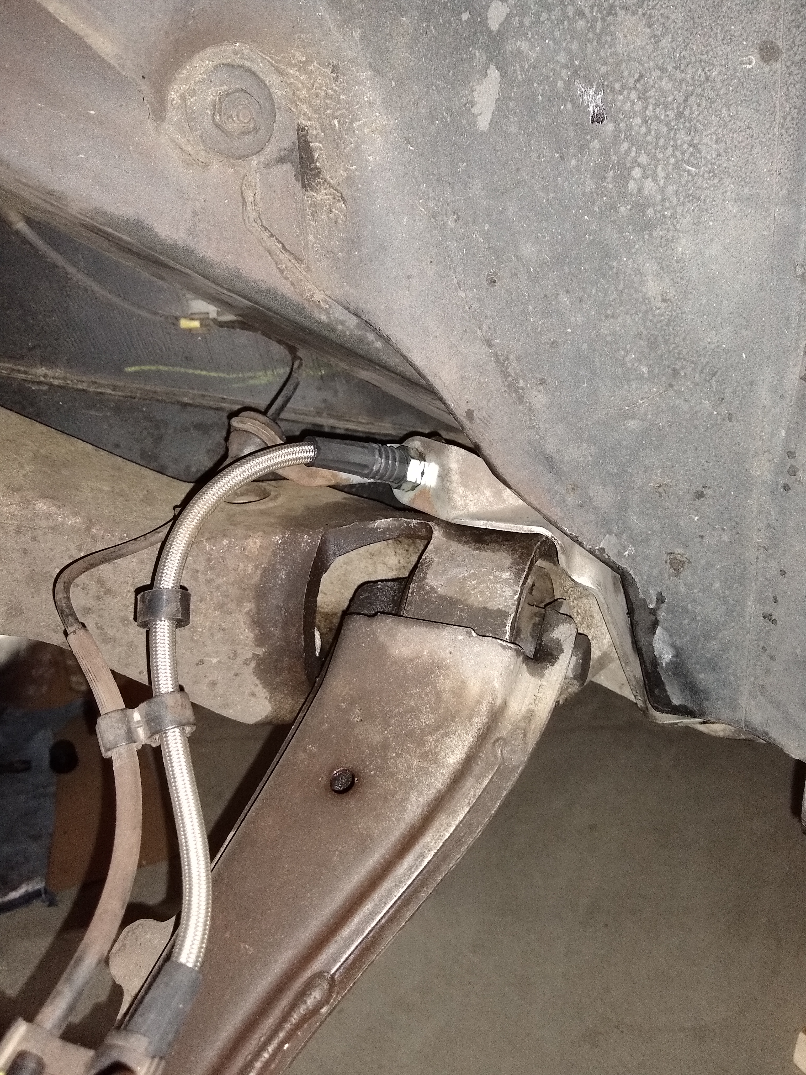

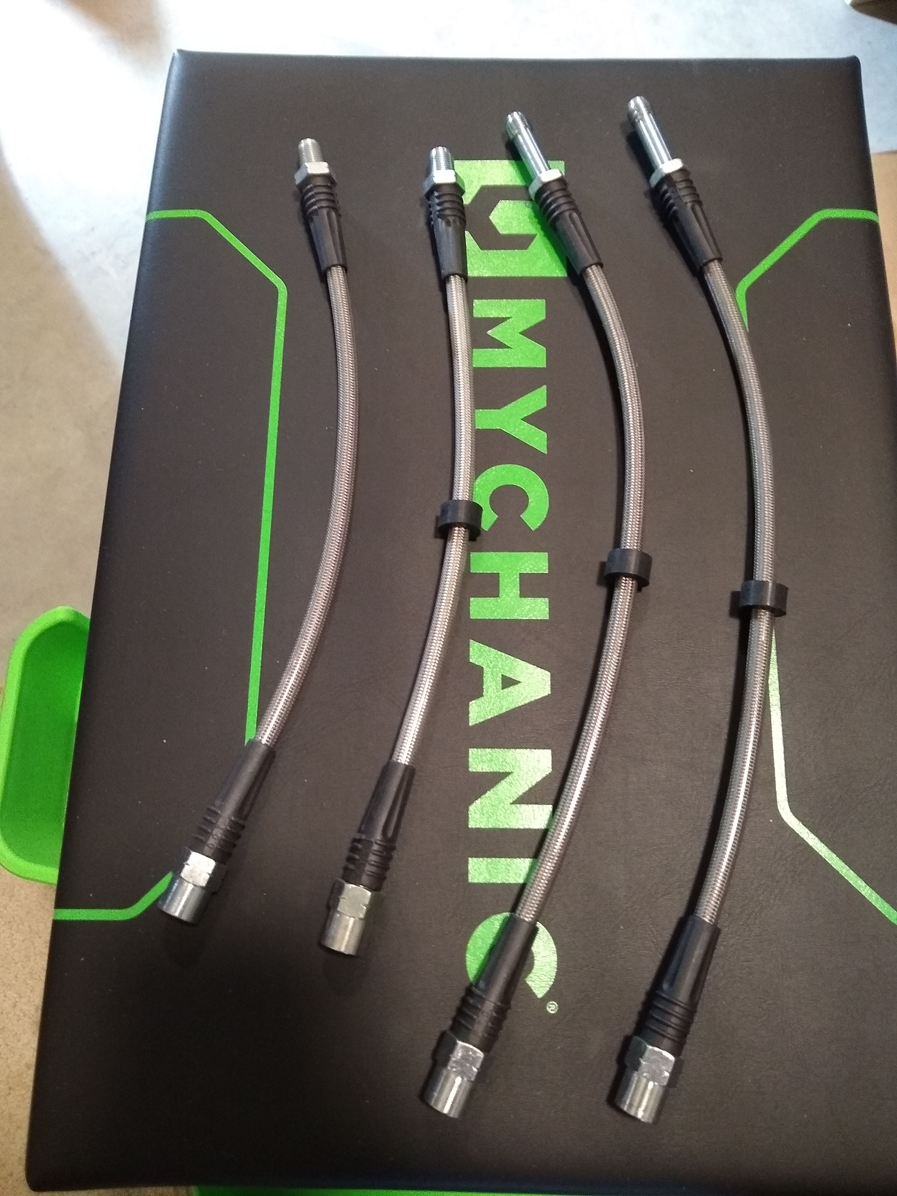

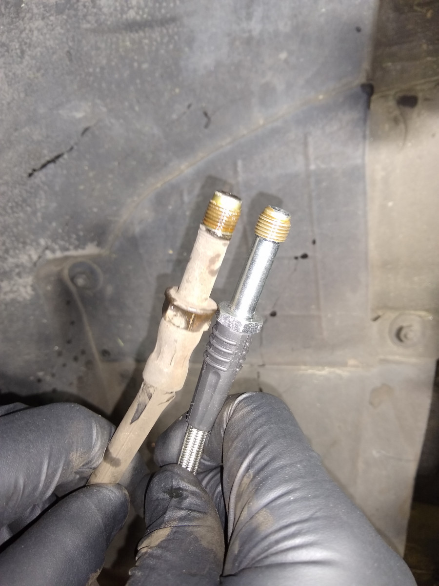

03 S80 T6 - Replaced all brake hoses with Stainless from FCP and used 1 qt. of fluid to flush the entire system. When the hose was disconnected on the opposite end of the caliper, I compressed the caliper piston fully using the metal edge of the brake pad with a large pair of channel locks (EDIT: Without removing the calipers) to see if any rusty colored fluid came out. Only one was a little dirty at the very end of the compression but all were good.
The rear was time consuming due to space limitations but the fronts were easy.
https://www.fcpeuro.com/products/volvo- ... fit-517732
Missing a bumper? Had to cut an old one off and trim so it will fit snugly on the new hose and then used a zip tie to hold it in place.
Sometimes you have to have that light right in middle of the work. Not from behind, not from the side, not on the ground and not wrapped around your head. Iron Man has got nothing on this cheap Costco Snap On light?
Front Hose at caliper. Dirt is going to fill the small space above the threads in the caliper.

I also replaced all brake hoses and the back was quite a headache, even with small asian hands like myself. But its a fullfilling job, once you are done.

What made the rears difficult? Is there room for tools?

Have never change the flex hose before or even looked at it so thought it would be daunting but being it's my eldest college car away from home I thought I won't procrastinate on that. To be honest I don't think it's critical but I will cut one of the older hoses to see what it is made of. I'm thinking it's probably like any other rubberized hose under the engine but with a much heavier weave.
