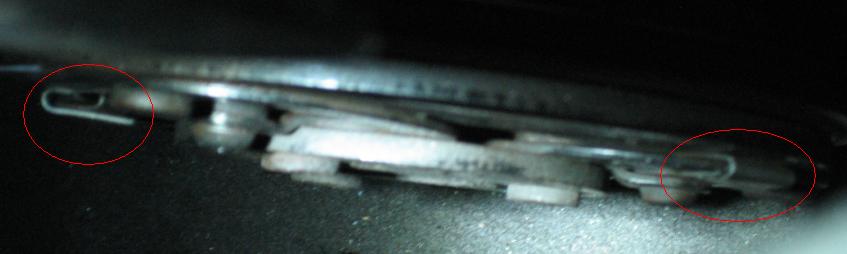

I did the zip tie fix last year, however this summer the AC stopped working again. The compressor just does nothing, not sure if the gap opened up or something else failed. System has pressure.
Pic from last year, I ended up using 3 more to close the gap.
They are not impossible to install from below, robert has a video where he does it from top, but I don't think I could do it from top.

Just from this angle, the gap seems quite huge. The gap should be 0.3-0.5mm all around the plate with cold engine so that's about 0.01"-0.02"
- View from above with two metal shims wrapped around the plate springs
- gap.JPG (21.39 KiB) Viewed 5515 times

I agree, that gap looks huge. You have to measure it. I install them from below.hausmeister wrote:I did the zip tie fix last year, however this summer the AC stopped working again. The compressor just does nothing, not sure if the gap opened up or something else failed. ...
