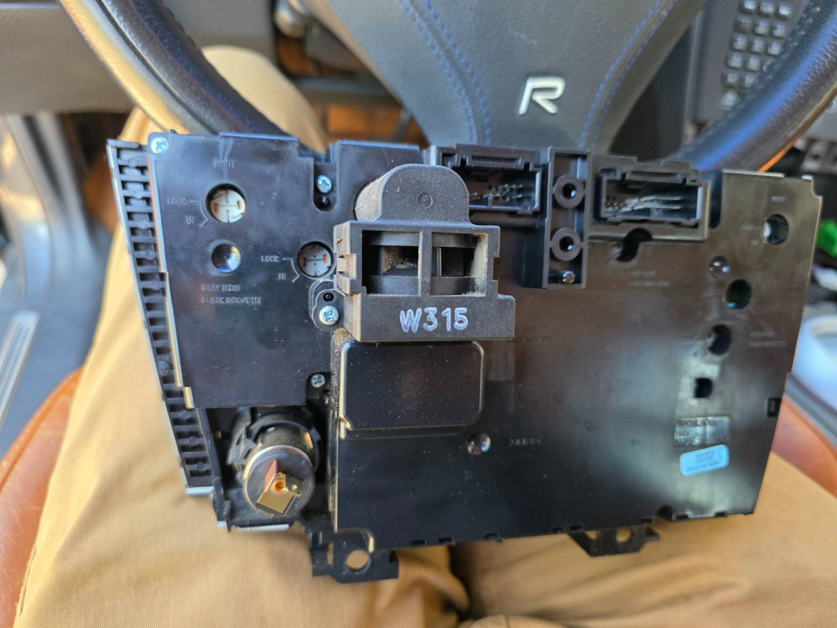

Back of CCM
Back of CCM
Back of CCM. This would also be a good time to replace the backlighting bulbs if some of yours are burned out
Remove 2 Phillips screws holding the cabin temp sensor fan in place and pull fan assembly straight out. Clean the dust out of this fan as well
Remove all the other silver Phillips screws. There are plastic tabs on the top and bottom of the back cover holding it in place. Carefully unclip these with a small screwdriver and remove the cover to expose the main board

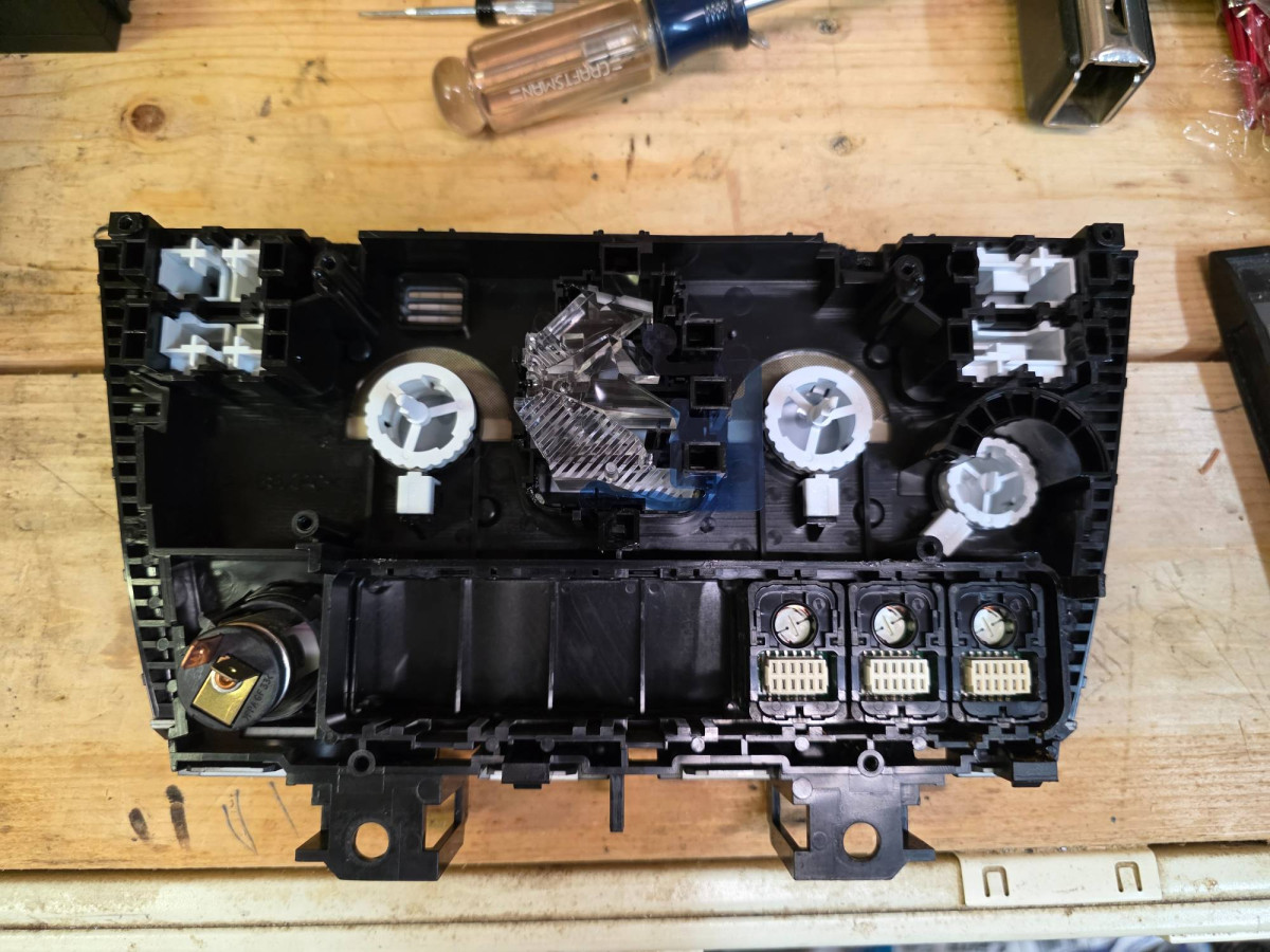

Front of main board
Front of main board
Broken thermistor on its own separate PCB attached to an air duct
Remove thermistor PCB from air duct and remove air duct from main board. You could remove thermistor PCB from main board by desoldering the 2 wires if you wanted to, I didn't do that though
Melt the solder joints and remove remnants of the old thermistor. Tin the leads of the new thermistor (that is, melt some solder onto the leads of the new thermistor) and solder new thermistor in place. Leave a little slack for placement into the air duct
Place air duct back into main board and place thermistor PCB onto air duct
