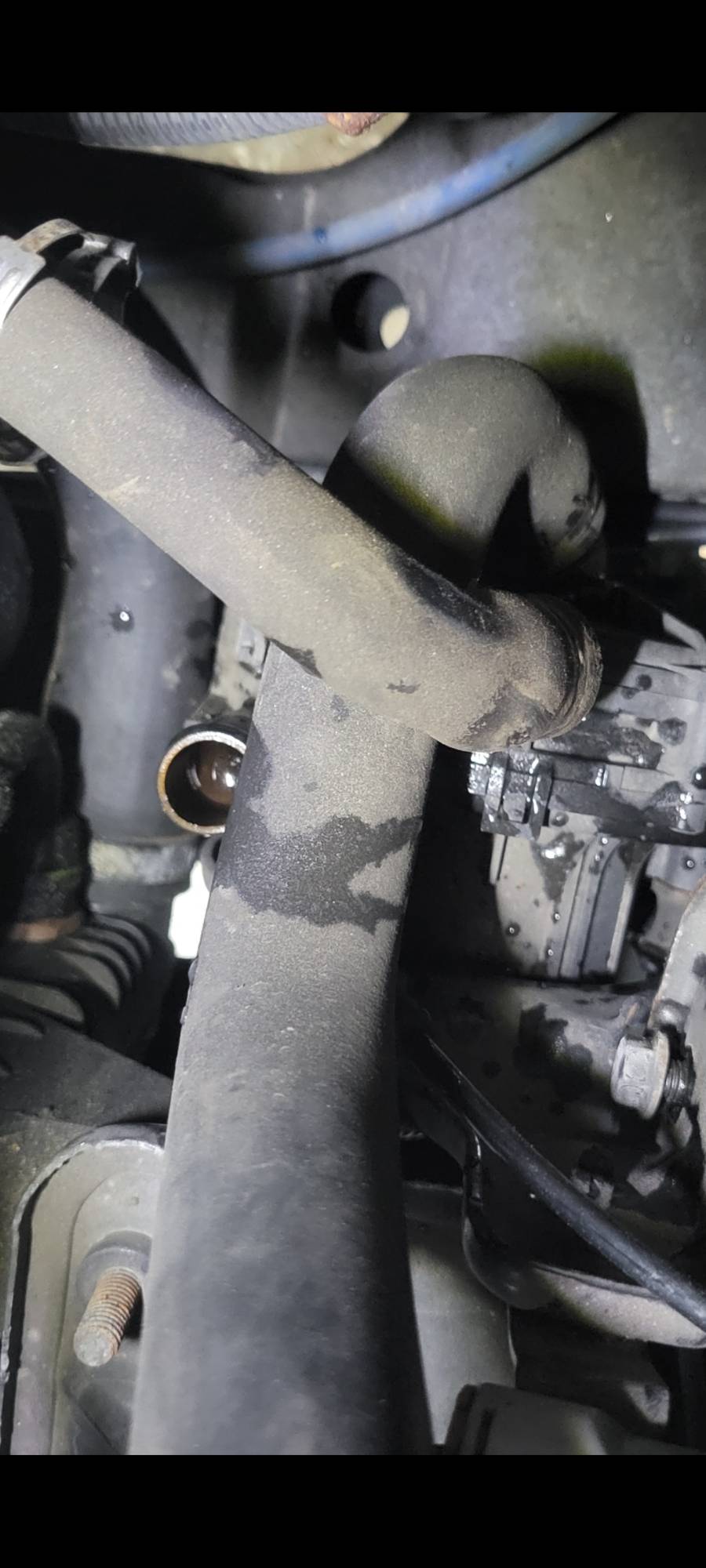

Not a volvo week for me. After vacation we had a busy schedule. My partners 08 Acura RDX decided to spring a pretty sizeable coolant leak from around the turbo area. She took it to a mechanic as i was busy and they said 4k for a new turbo. Car runs great, air fuel ratios are nominal, boost is built, and no white smoke is laid down on acceleration.
Funnily enough it uses a TD04H turbo with coolant and oil cooling. Did a late night diag yesterday and answered 50% of my questions. There was a leak on a water cooled exhaust manifold but it does not seem to be active. I need to get my inspection camera to the backside of the turbo where the coolant pips connect to it to see if that area is leaking. If its not then i get to deal with rusty bolts.

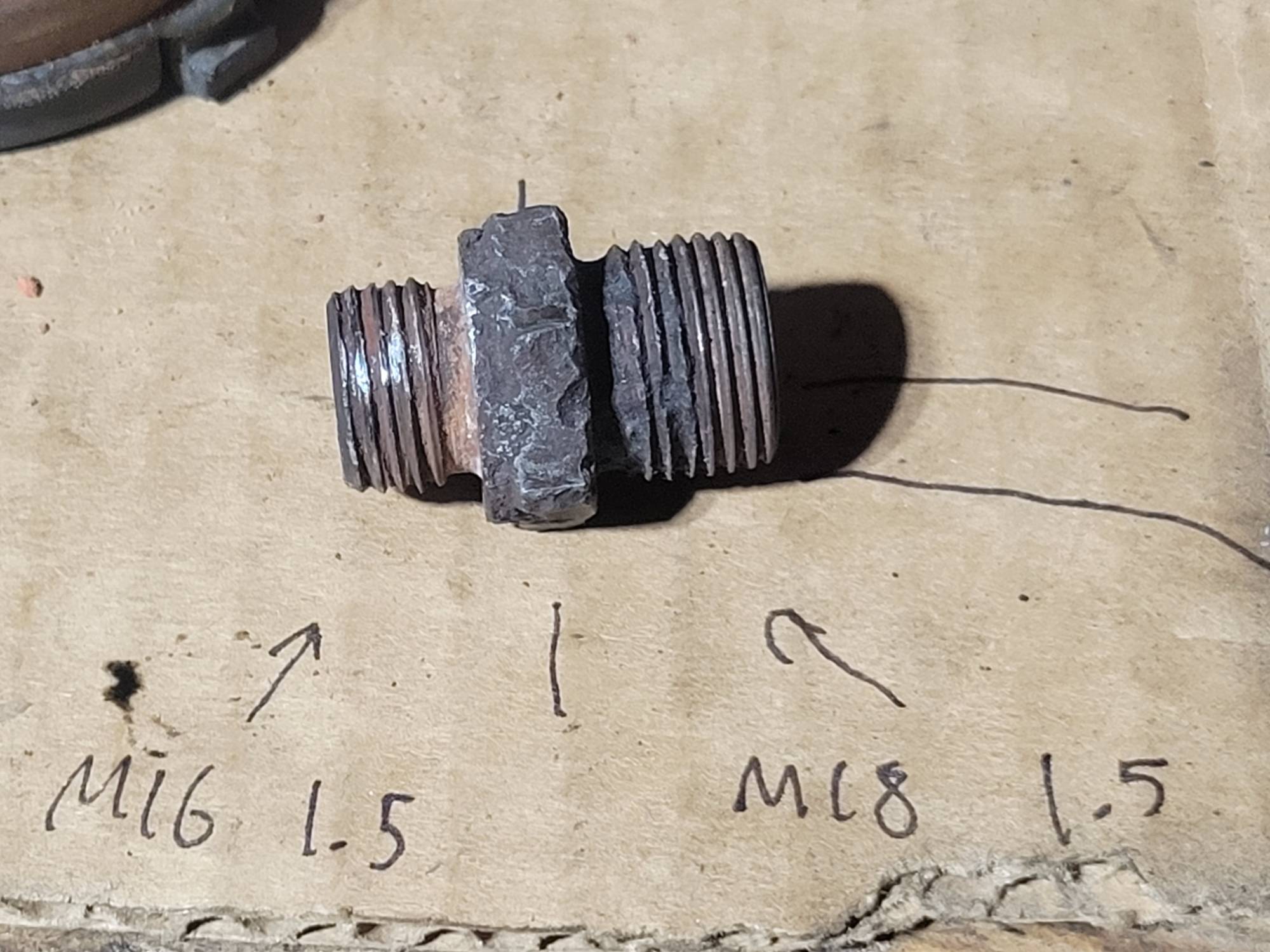

This was in a box in the back of the car when purchased, doesn’t seem to belong to this car 98 v70 speaking of my car, the Vin tag is a date of manufacturer of 03 97 But when I did a Vin look up, it told me it was a 98…
Looks like I’ll be needing this.

5underpressure wrote: 30 May 2024, 16:20 This was in a box in the back of the car when purchased, doesn’t seem to belong to this car 98 v70 speaking of my car, the Vin tag is a date of manufacturer of 03 97 But when I did a Vin look up, it told me it was a 98…
So anyway, if someone can identify this and wants it for the price of shipping, let me know.

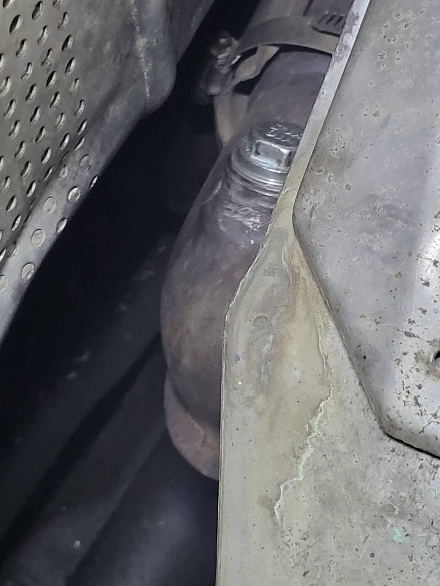

Let it run and blasted it with the pressure washer. Then pulled the wire cover and the plug boots, sucked the oil and water out with the shop vac and 5/8’s hose, hand spliced. Pulled the lower air box to remove and dry out the distributor cap. While it was running with the cover off I felt the compression through the #4 plug, it was loose, 100 miles by me alone beating up the threads ugh. They looked ok but while warm I wasn’t super confident in the feel of it snugging up. We shall see. Maybe thread sealant is in my future.

My SAS pump was so full of water, it was up into the hose that runs from the pump to the valve on the exhaust and spilled all over when I took the hose off.
You can see it here up to the brim.
Purely for testing and not for on-road use of course.
For anyone who wants to do this, I didn't find the info online about the coupler threads when I looked, but the coupling for the SAS valve into the exhaust has an M16 1.5 thread into the exhaust bung, and the nut from the SAS valve threads on to an M18 1.5 thread.
The SAS valve nut came off with just a 22mm wrench and a bit of force, the actual coupling needed to be persuaded with a stubby impact wrench and zipped right out, the hex is also 22mm.

yanga001 wrote: 29 May 2024, 22:49 Not a volvo week for me. After vacation we had a busy schedule. My partners 08 Acura RDX decided to spring a pretty sizeable coolant leak from around the turbo area. She took it to a mechanic as i was busy and they said 4k for a new turbo. Car runs great, air fuel ratios are nominal, boost is built, and no white smoke is laid down on acceleration.
