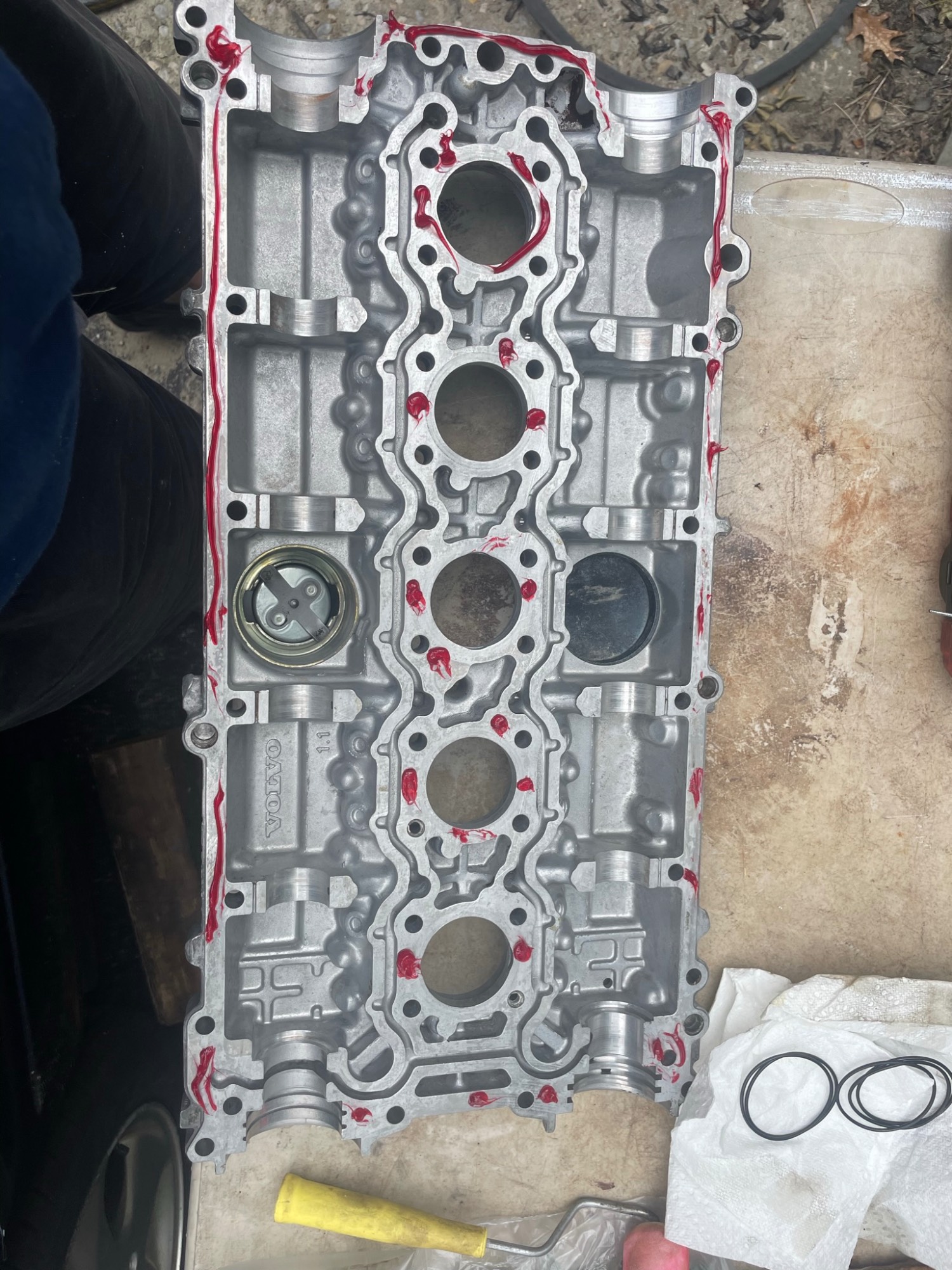

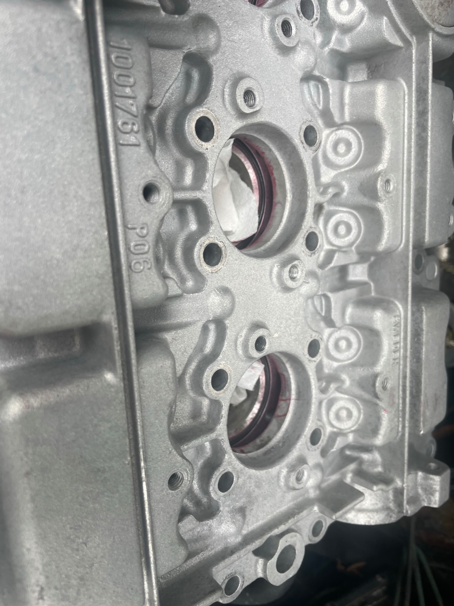

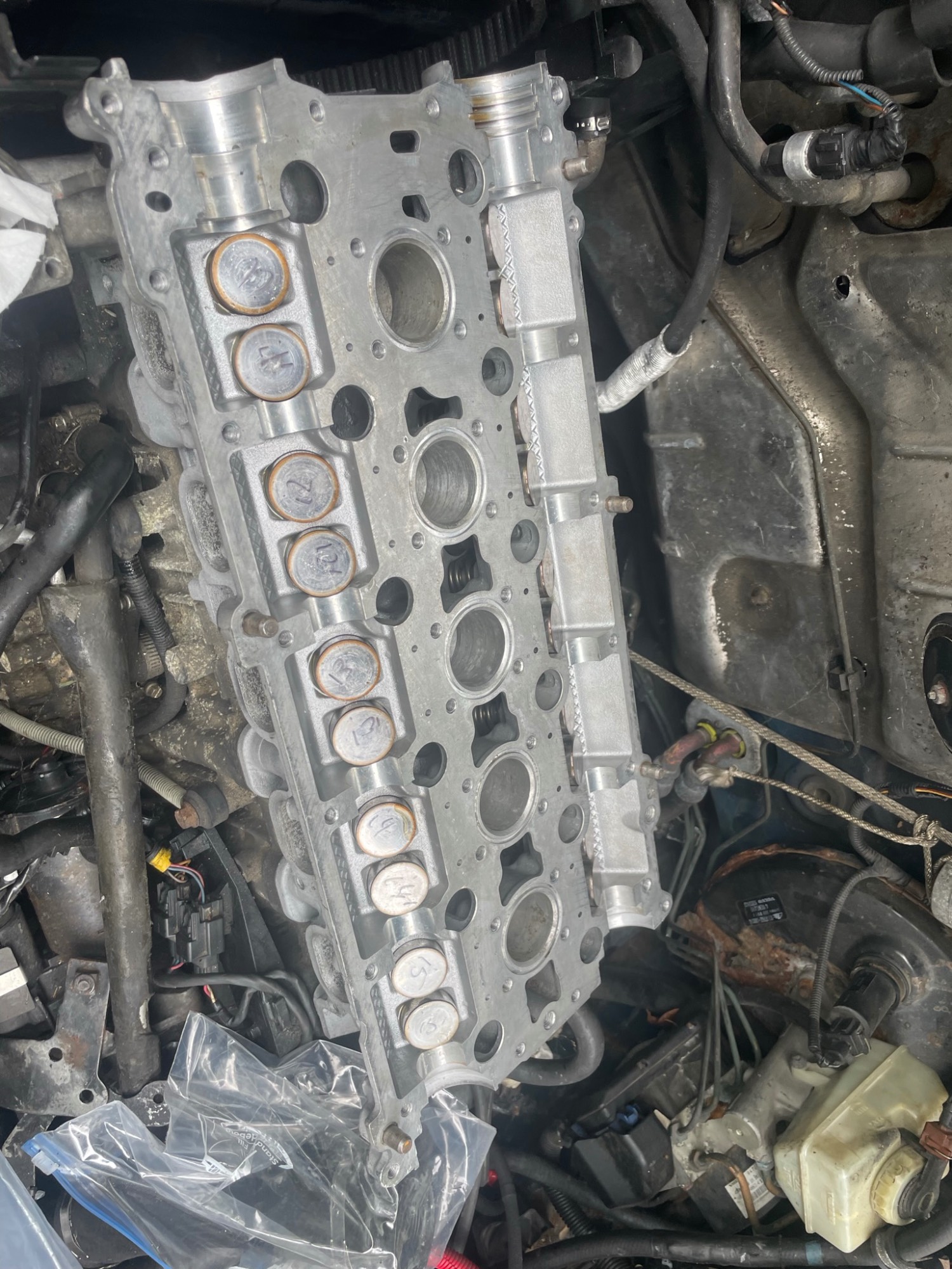

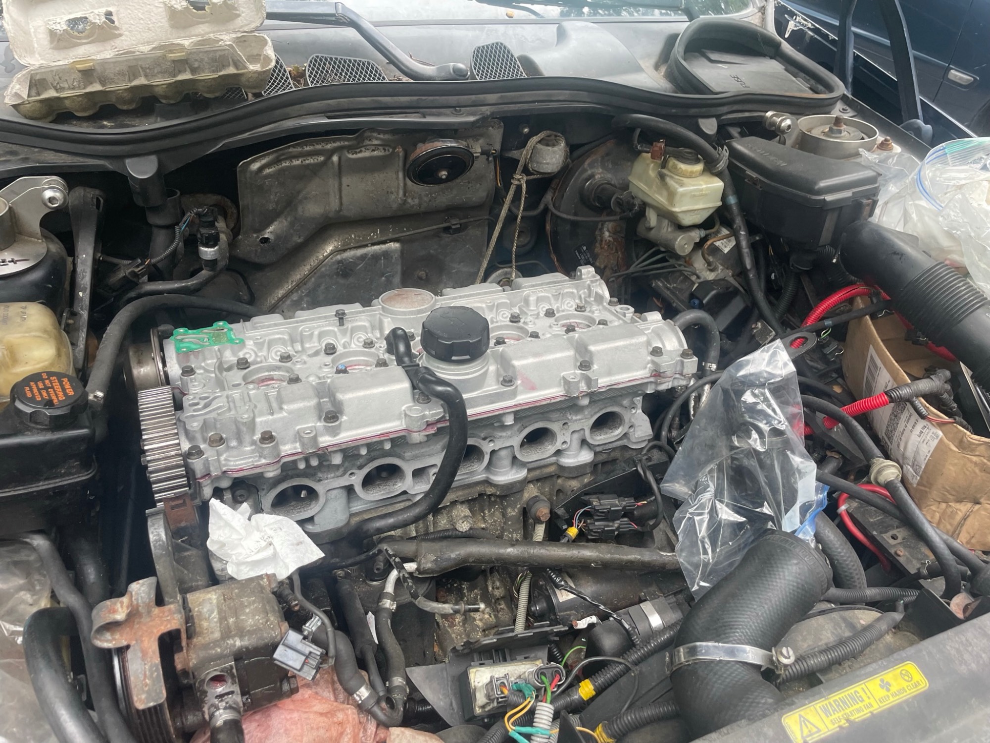

…and Elizabeth progresses….one really good hour+ today
Dipped lifters into a cap of oil then dropped into place.
Make sure plug holes are paper plugged
Dab and prep both cover sides to Barbie pink with Permatex and foam roller
Install cams , exhaust notch down, intake up
Lube cam thrust bearing with grease
Confirm crank mark
Install spark plug orings
Install cam cover
Bring down cam cover with cylinder 2,4 bolts …4 each cylinder
Install rest of cylinder bolts
Do rear side
Do front side
Confirm cams rotate with reasonable force
Confirm crank mark
Install cam cover
Do rear side
Do front side

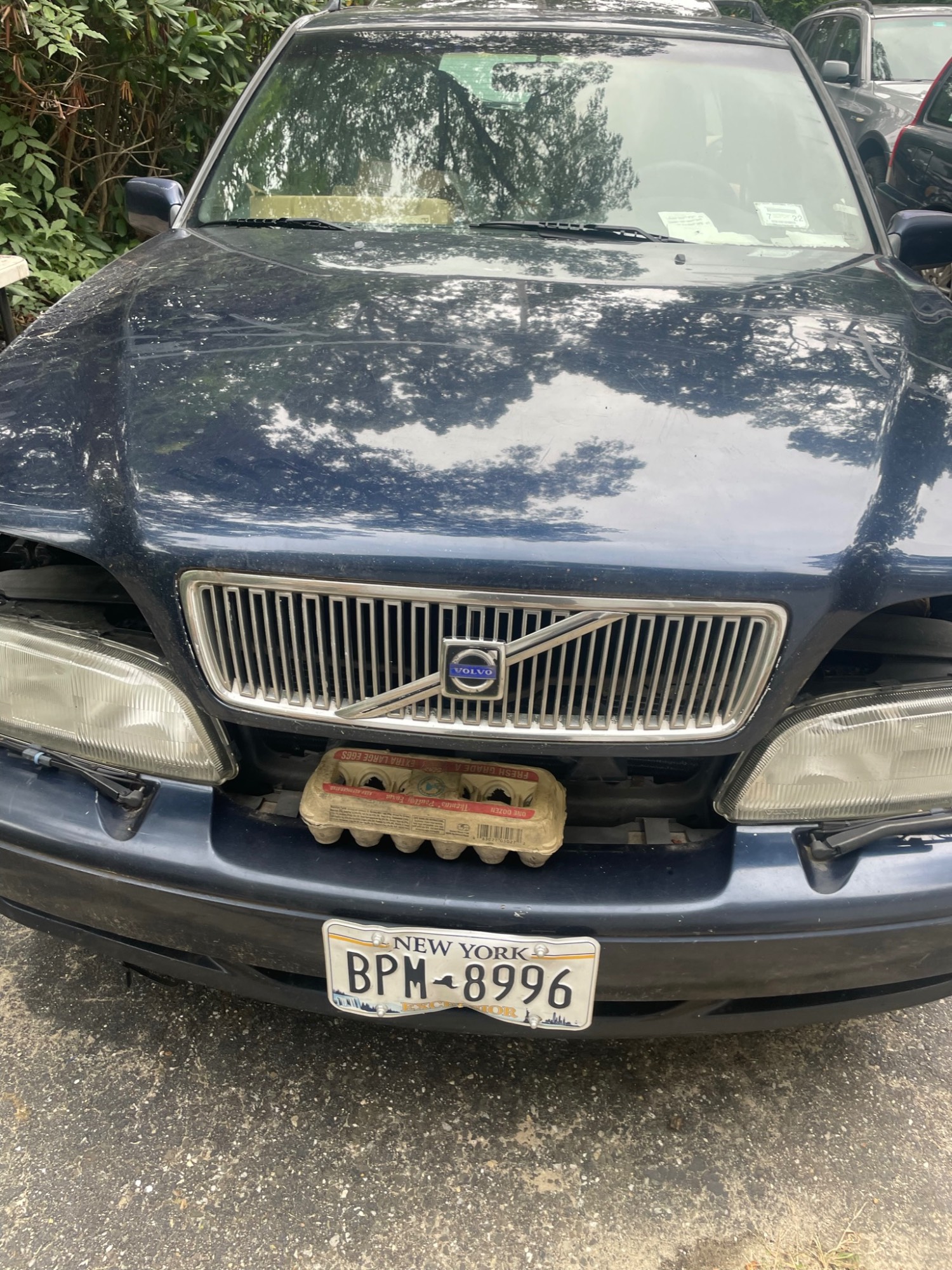

That is not the correct 'eggcrate' grille!
Well remembering how the challenge was last time with the binding cam issue, you clearly learned the tricks for this time! Long may it continue!

Abscate, when installing the cams and cam cover, do you try and seat the cam seals during assembly or leave them loose and tap them in after the cover is bolted down?
