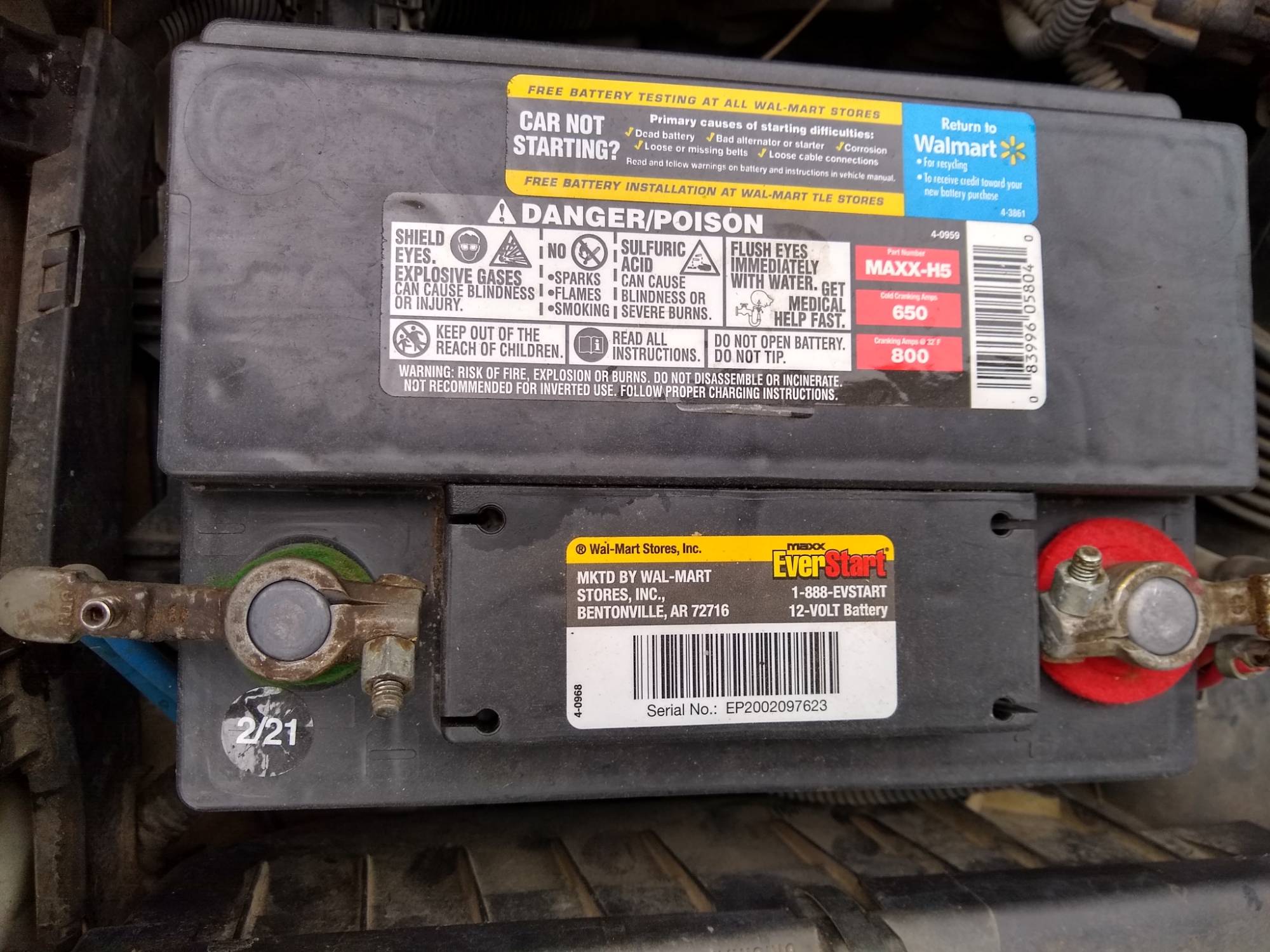

Check battery voltage, i had my 99t5 project throw all lights when a dead battery was present. Ran like a nut but the dead battery did not help.

Thanks yanga001, I'll disconnect and do a full charge. Hope it didn't sit too long as the battery is fairly new.

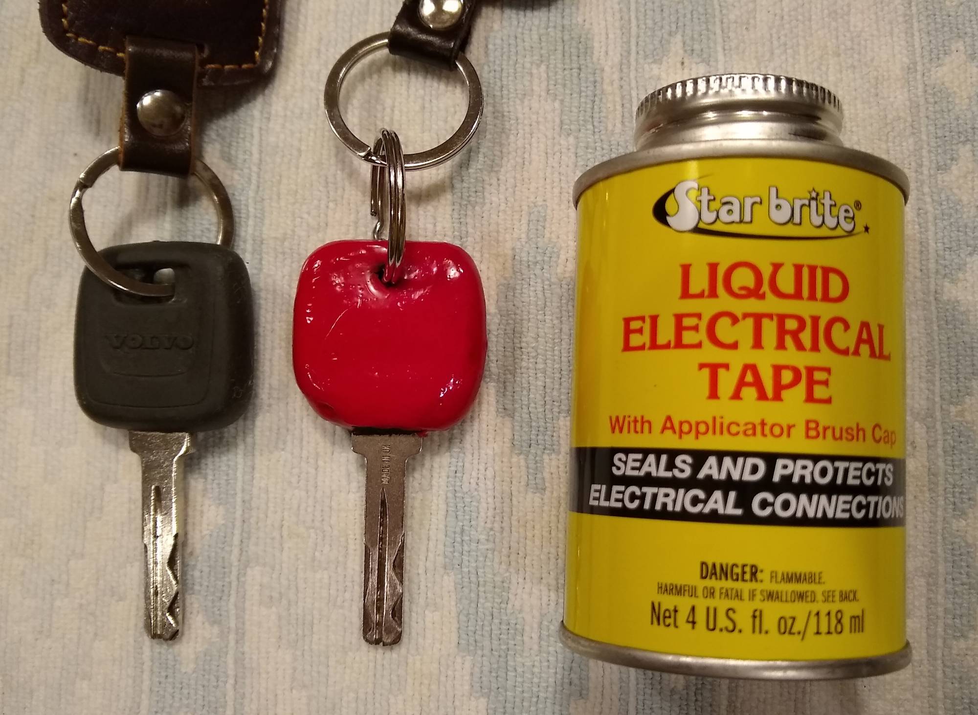

May have posted this before but had to work on some SticKey business. Really gummy, gooey and rubbing off. Used some dish washing soap and rubbed clean with paper towel. Sprayed with 97% rubbing alcohol and rub down again. Allowed to dry for a day or so and then brushed on.
The product is old so a bit thick rather than flow. Best just to turn it around and around till to takes shape and stick the key in a straw and let it stand upright in a cup to dry. Since it was old stuff and didn't brush on evenly, as soon as it was touchable I went ahead and tried to reshape it. Helped a little but it was best to just let it dry and it will shrink to fit. Will be loose and floppy while drying.
