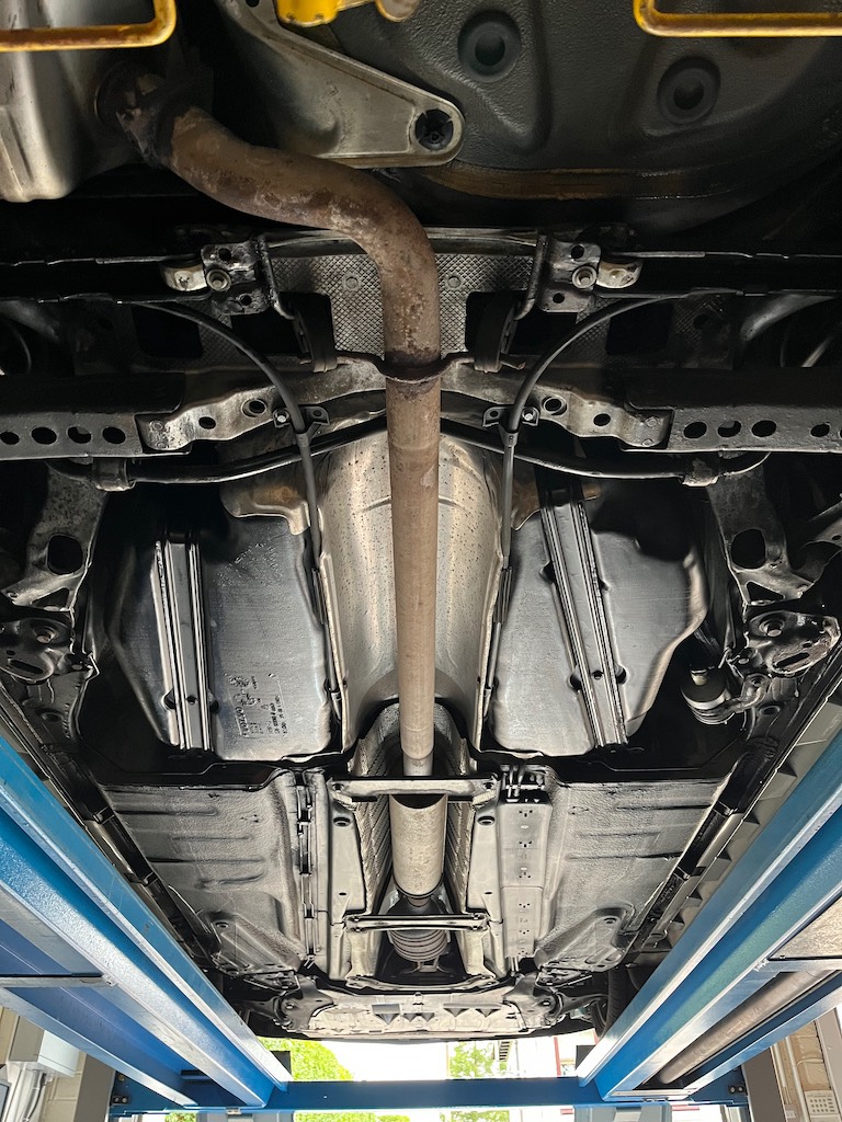

The exhaust is the original that the car left the factory with (now almost 27 years old) I painted it with high temperature paint in 2021 and when I was applying the Lanoguard I held cardboard up to prevent it getting covered in the liquid

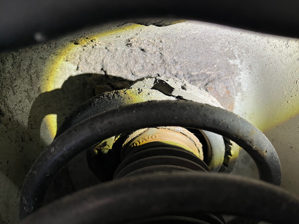

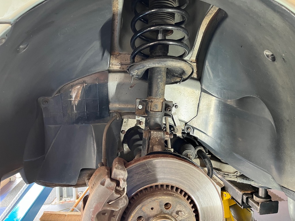

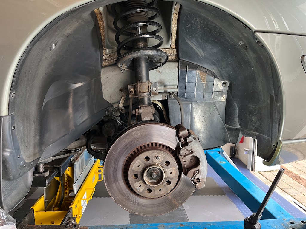

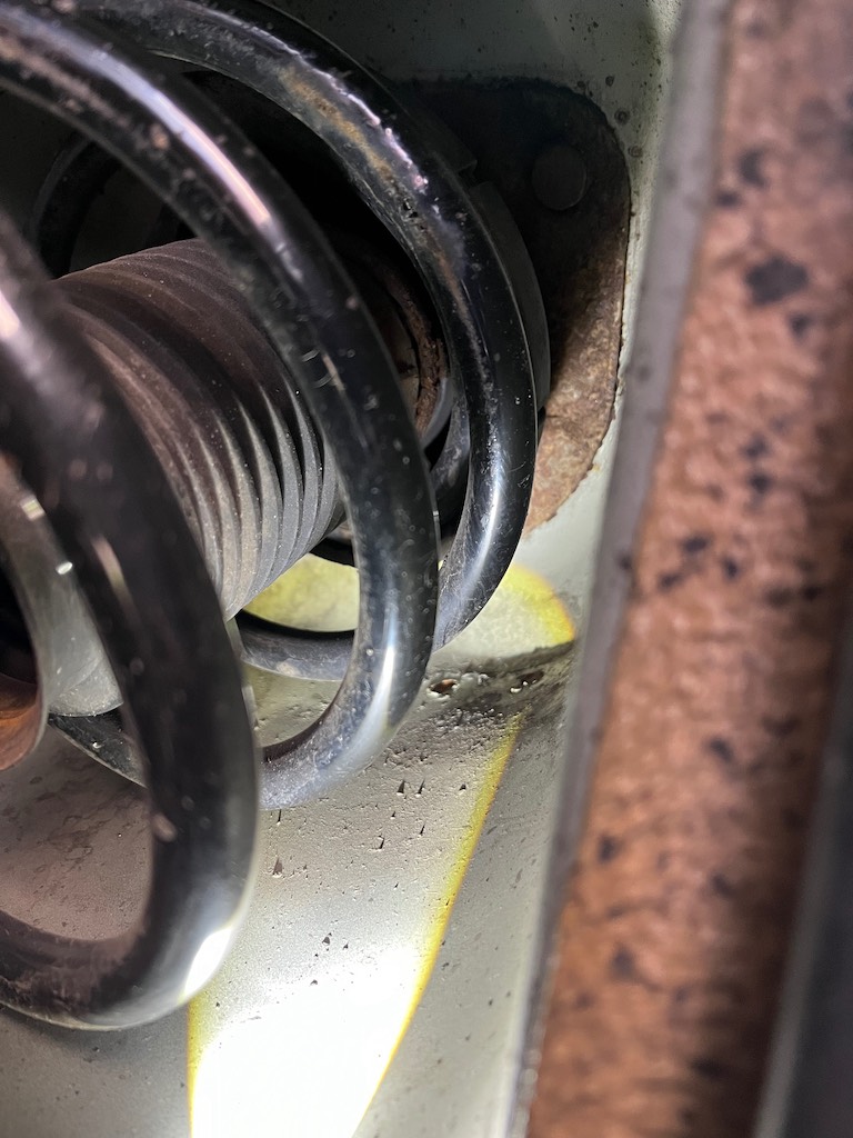

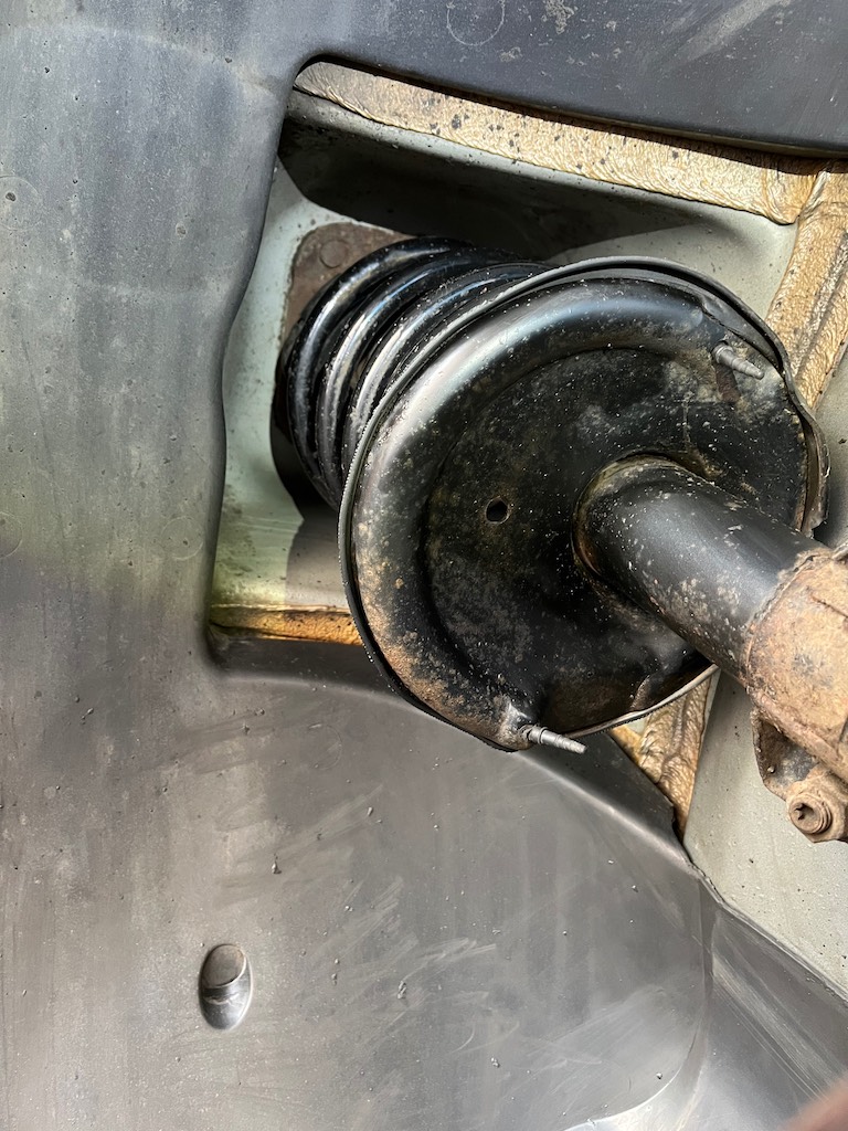

That’s the front end cleaned ready for Lanoguard. I was surprised at how little muck there was at the top of the strut towers and once cleaned I was pleasantly surprised at the lack of rust up there as it’s a known weak spot on the P2 V70s

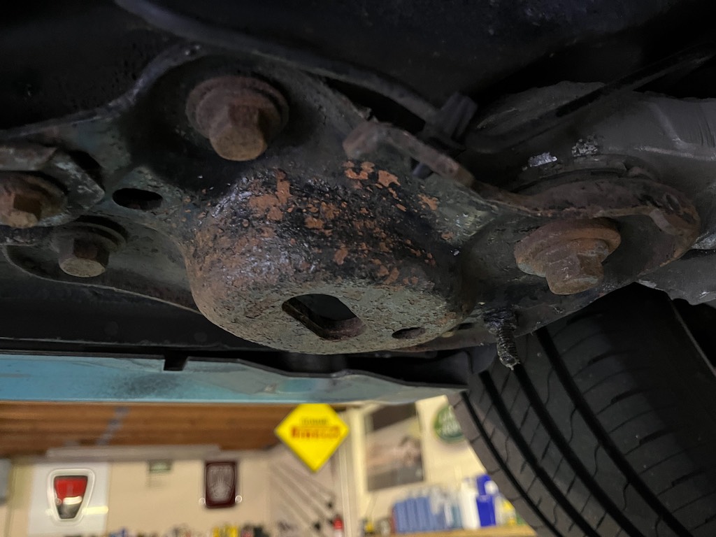

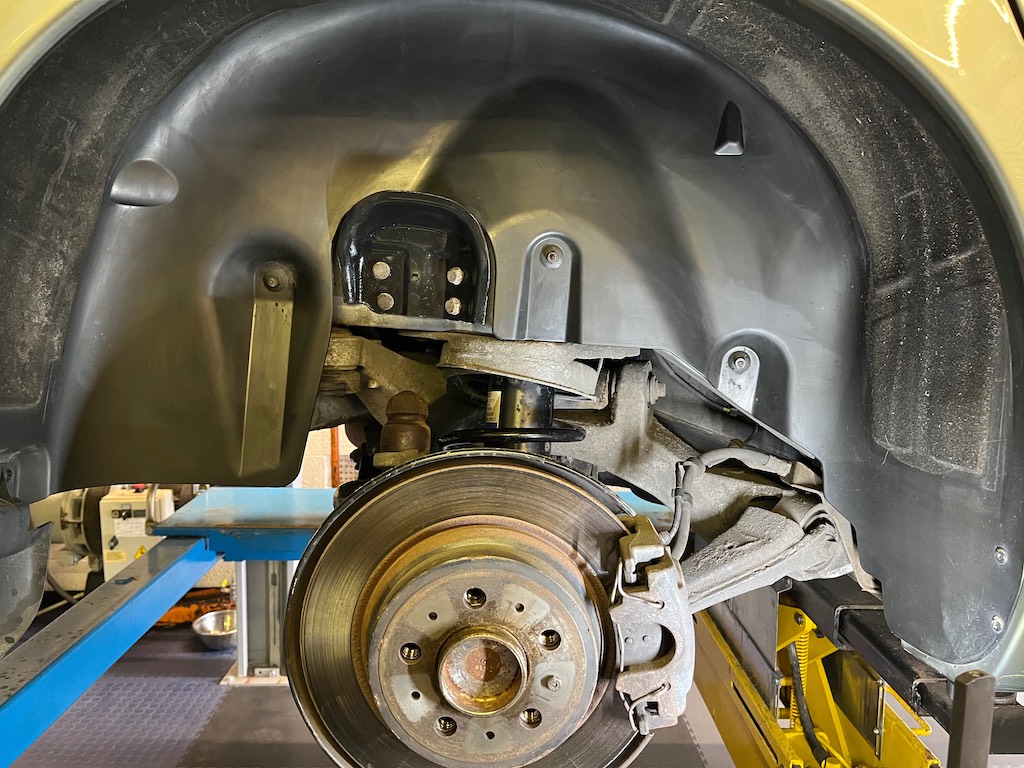

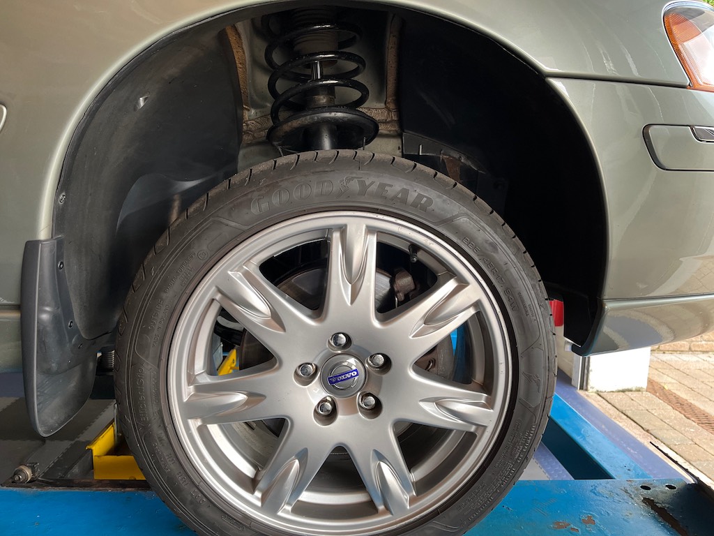

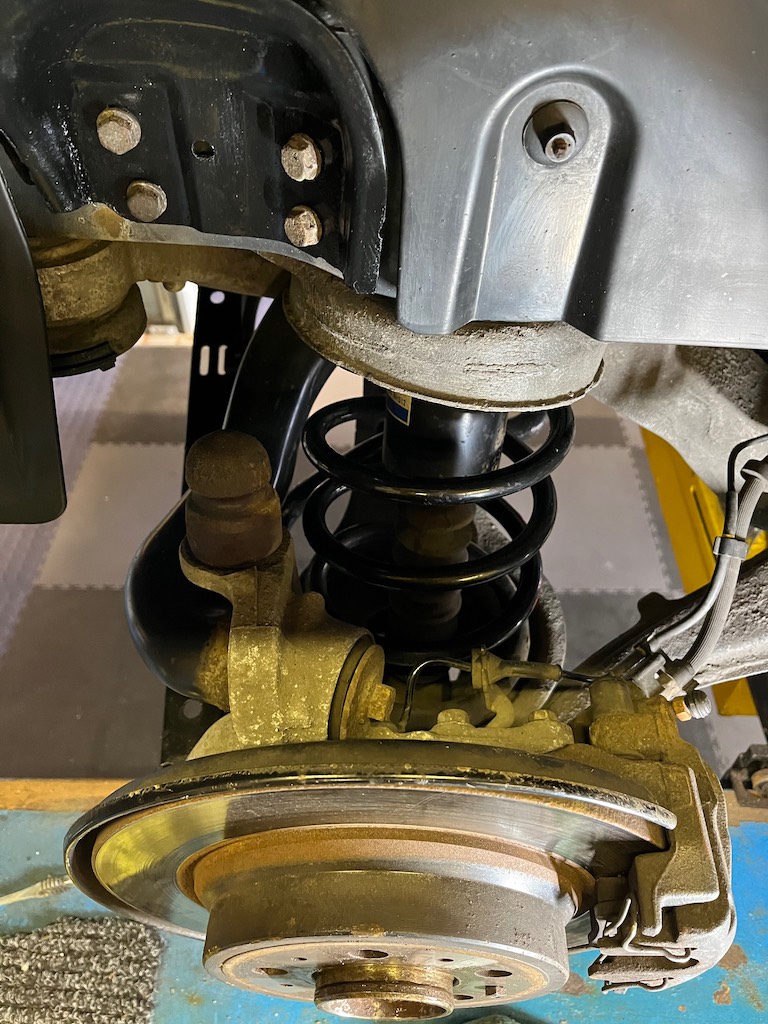

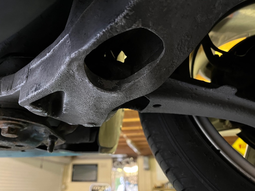

Removed the back wheels today to get better access and managed to find a load more muck from inside some of the suspension arms.
Most of the muck was in this part, quietly sitting waiting for the next downpour so that it could rust a little more. A good douse in Lanoguard will sort it out

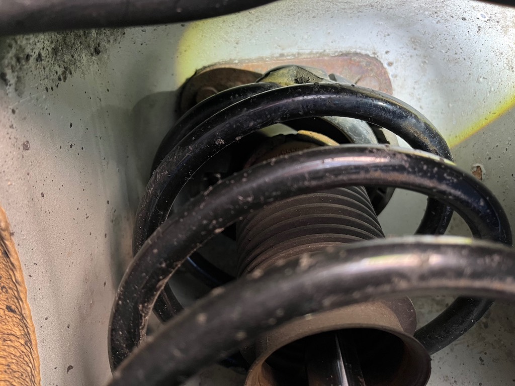

There was also quite a bit of muck in this arm but it looks to be a non ferrous metal so not as much of a concern

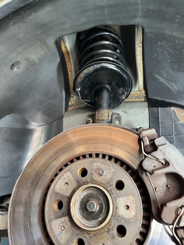

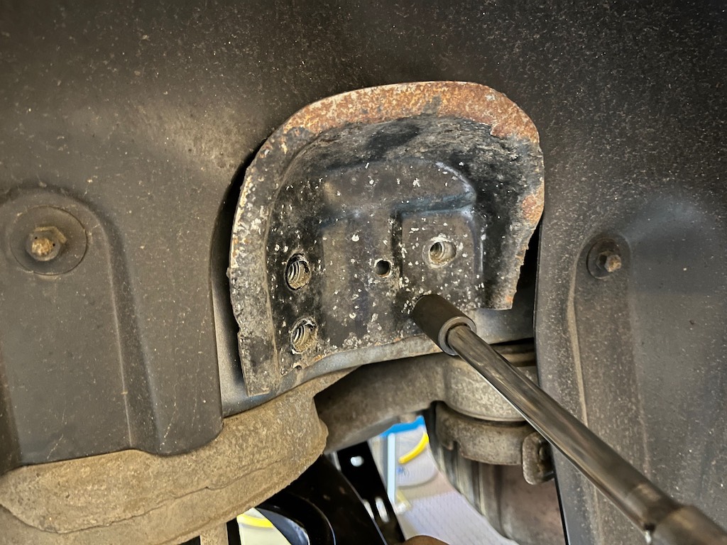

Bump stop plates were a little ragged round the outer edges
Good time to check behind them for rust
Painted and refitted, wheel arch liners de-tarred and will apply some Chemical Guys Bare Bones once the Lanoguard has been applied

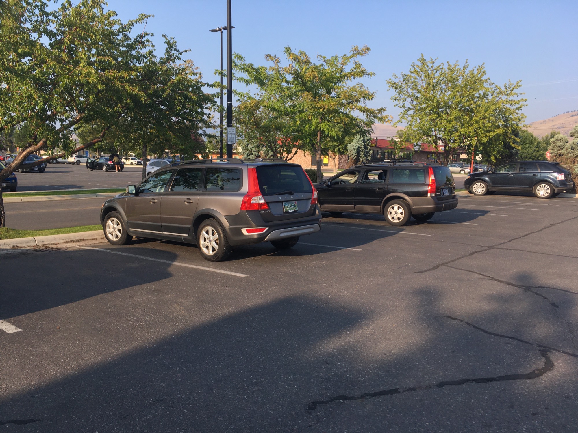

I hang out with the right sort of people at my hardware store.....

BlackBart wrote: 25 Aug 2023, 13:36 I hang out with the right sort of people at my hardware store.....
Sure Bart but that’s a P3 :twisted:

TisMe wrote: 25 Aug 2023, 17:09
That Ford Edge in far spot is also technically a Ford's version of XC60. Or, perhaps, the other way around.
One of the three cars on that picture does not have subframe rust ;)

Post by BlackBart »
Mine....?
Volvo wagons - they’re my people!

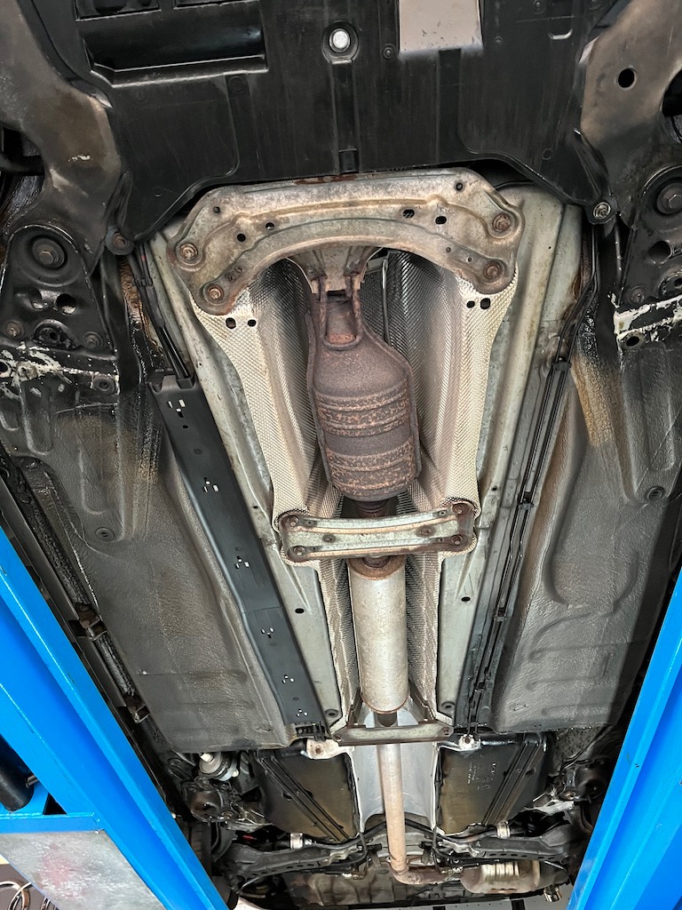

got my car inspected this morning, now I have 12 more months to fix the exhaust.
in the uk it would have gone to the crusher before now.
