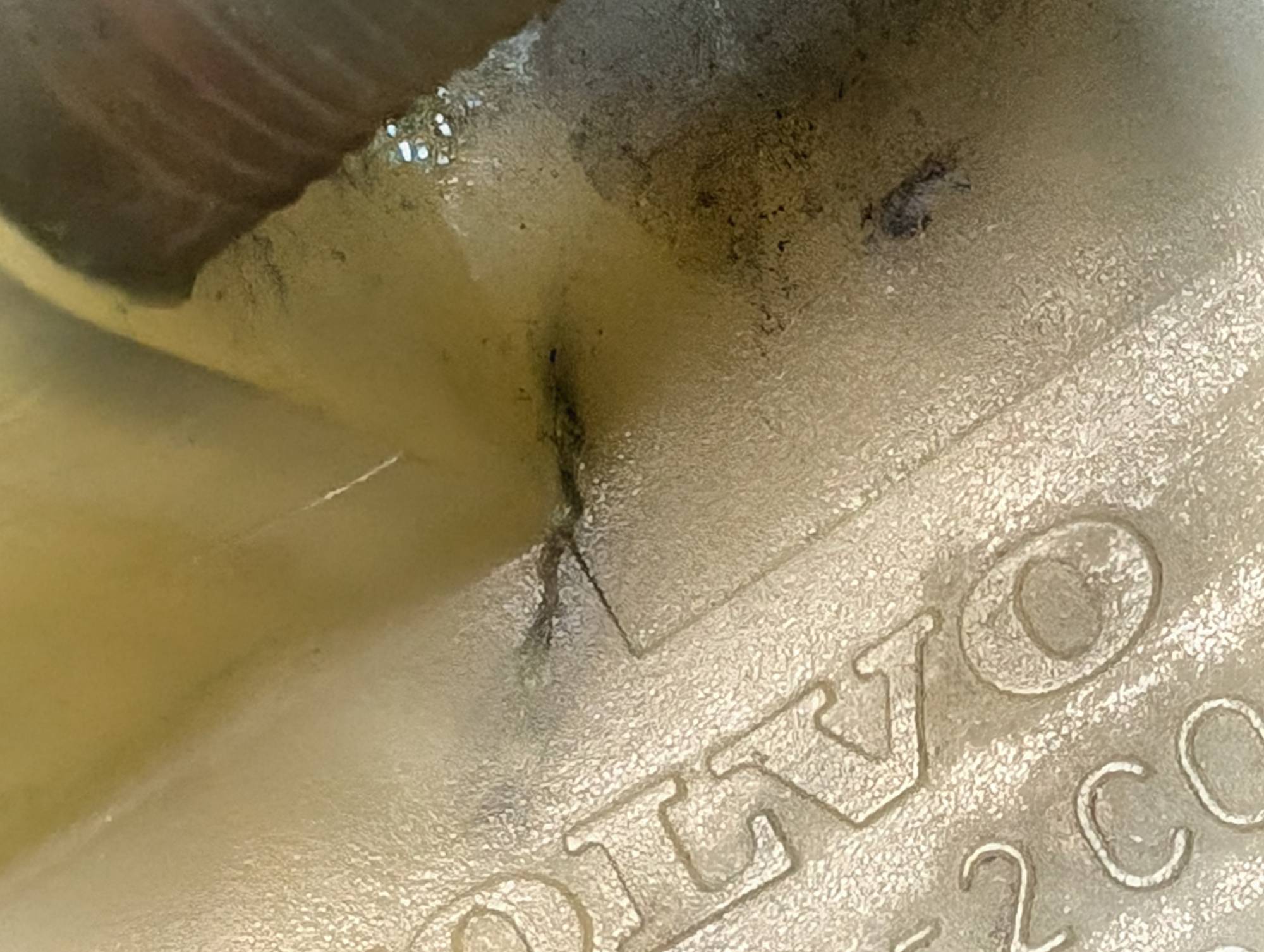

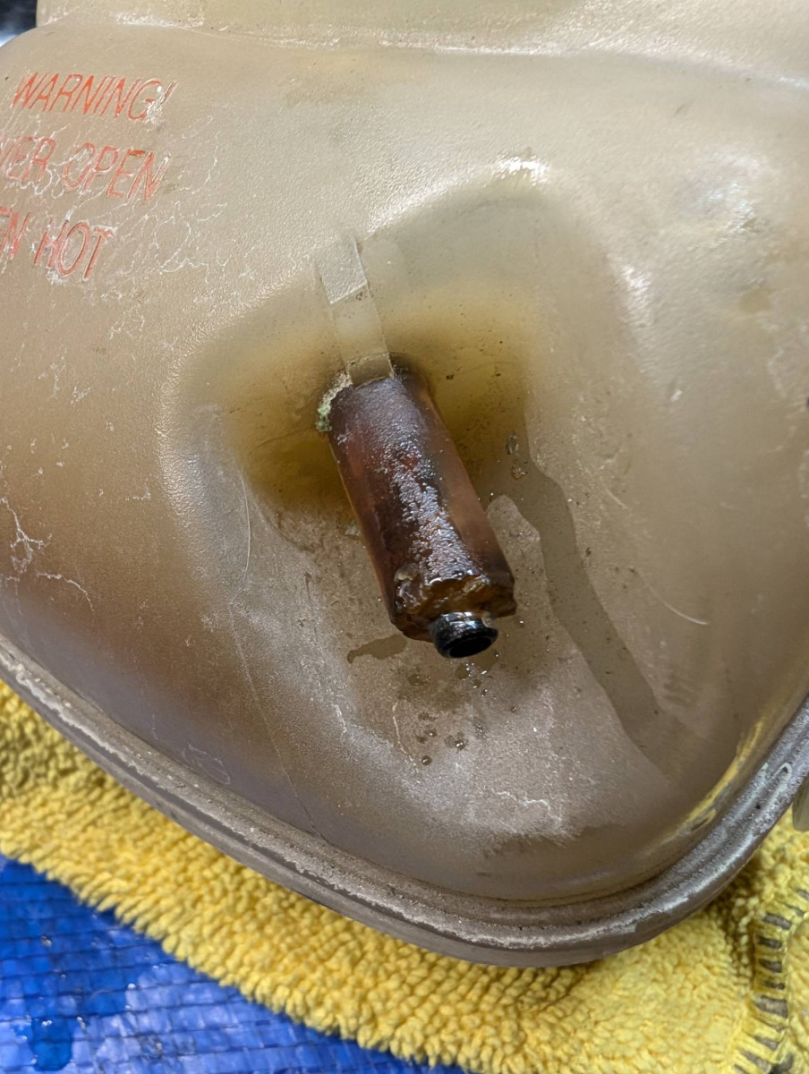

Well Gus my mechanic friend back from his travels arrived this morning to tackle the timing belt on the 00 R. It is 10 years old and although the car has only done about 10k miles in that time, rubber perishes all the same.
I was planning to watch the belt swapping or even do it myself, but he was in a rush. As quick as I got the tools out he needed, the job was done. Probably from getting the car on the hoist to done was less than an hour and probably much less. It took me longer to find the tools he needed than he did working! I did get a brief instruction, but not sure 100% I would try this again without being hands on while under supervision!
Glad we did this before the car was being used, as when he lifted the coolant header tank we found evidence of leaking coolant from the base of the tank. Gus hardly stopped laughing the whole time as he would as for a art and I would produce a used or new replacement. He just kept shacking his head!
Naturally a nice cleaned used tank was found and swapped over and hopefully all is now good.
Old tank bottle below:
Above this was more worrying as this could have blocked the line as the bits of plastic were broken inside the pipe!
