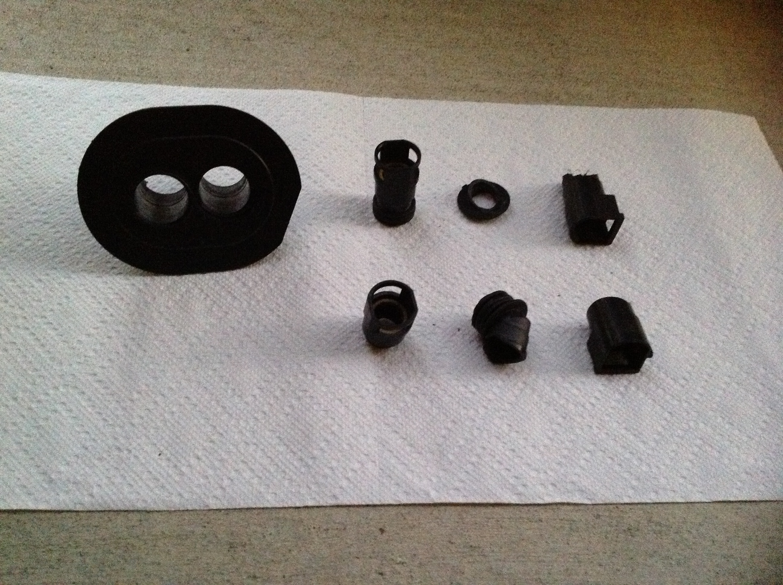

I wanted to see how that Volvo (IPD 120323) - Heater Core Hardpipes & Firewall Junction Coupler was made and how easy it was to remove but in doing so I BROKE IT :roll: . As I mentioned in earlier posts I was going to try the alternative of running just hoses through the Junction Coupler as found on another website and got my wish, unfortunately. After it was all said and done I would say DON'T MESS WITH or REINVENT VOLVO's mouse trap. Here is what I started with and then finish with.

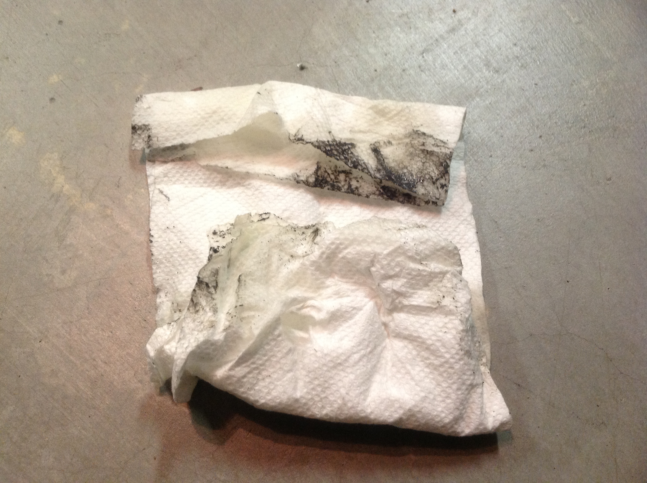

However, An Important Note Before (You :D) I Begin: I purchased the Ebay Heater Core from Swedish something with the Lifetime Warranty early last year (yes no heat all last winter) which I just installed and so far so good but you should absolutely flush the inside of metal grit and spray the outside with detergent of the manufacturing oils. Found all this metal in the bottom of the Coolant tank and at this time it smells of grease when you turn on the heat. May have to remove it to clean the Fins of the oil.
Metal Shaving - Seemed like a lot more on the bottom of the Coolant Tank

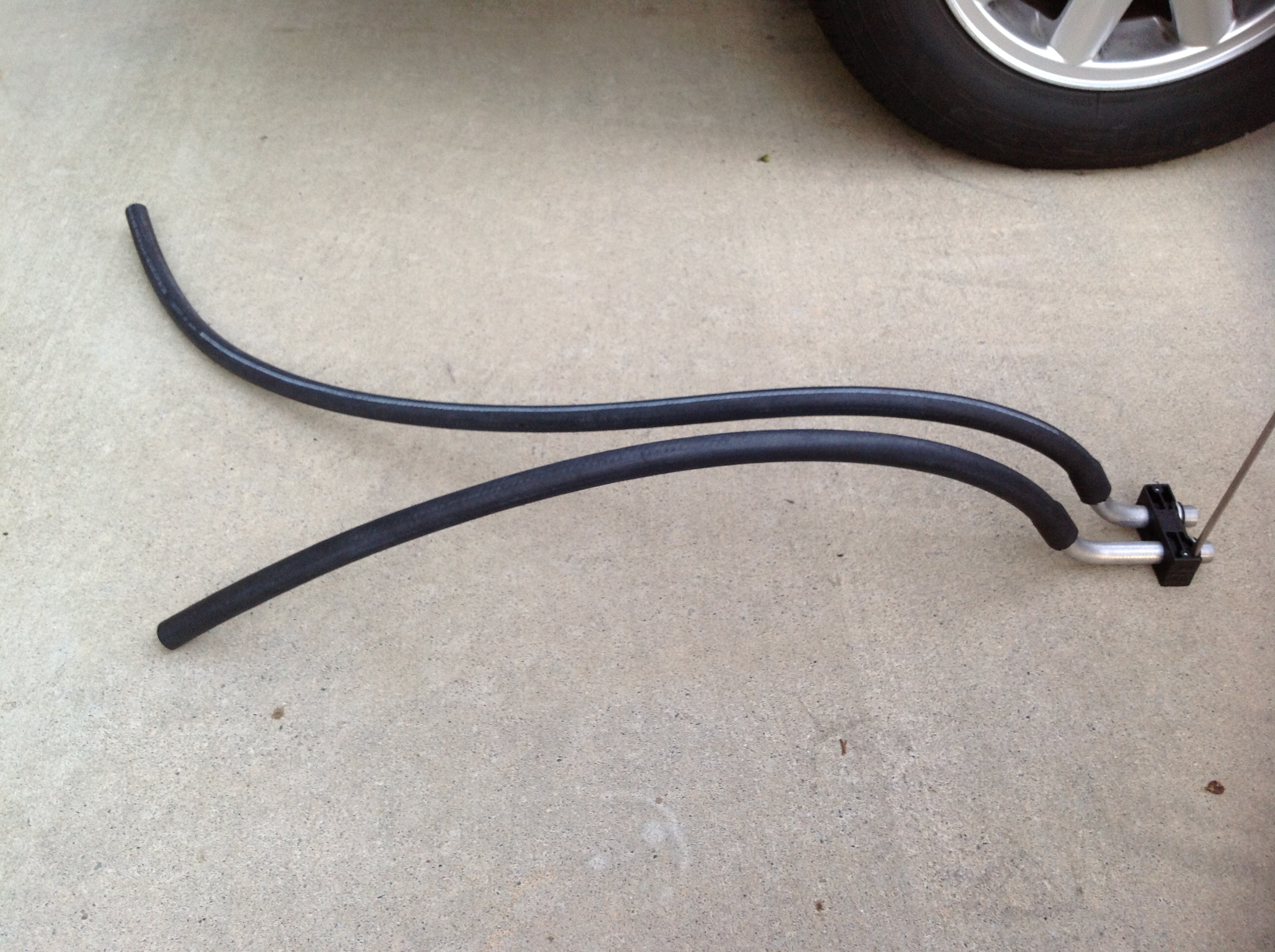

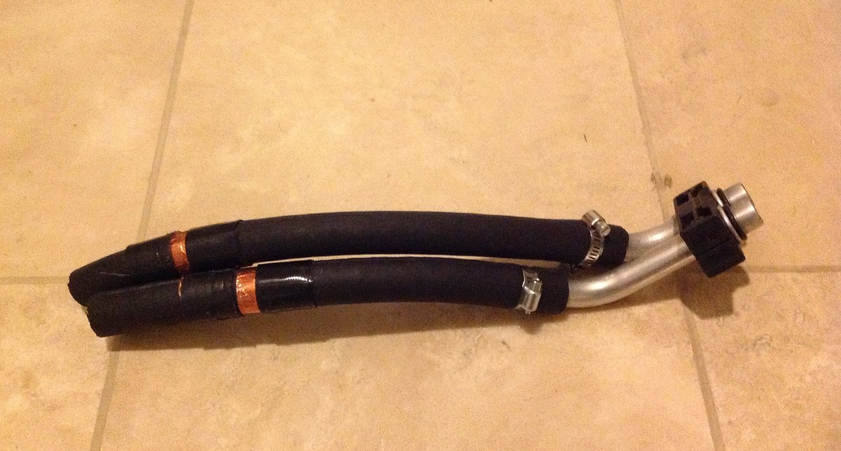

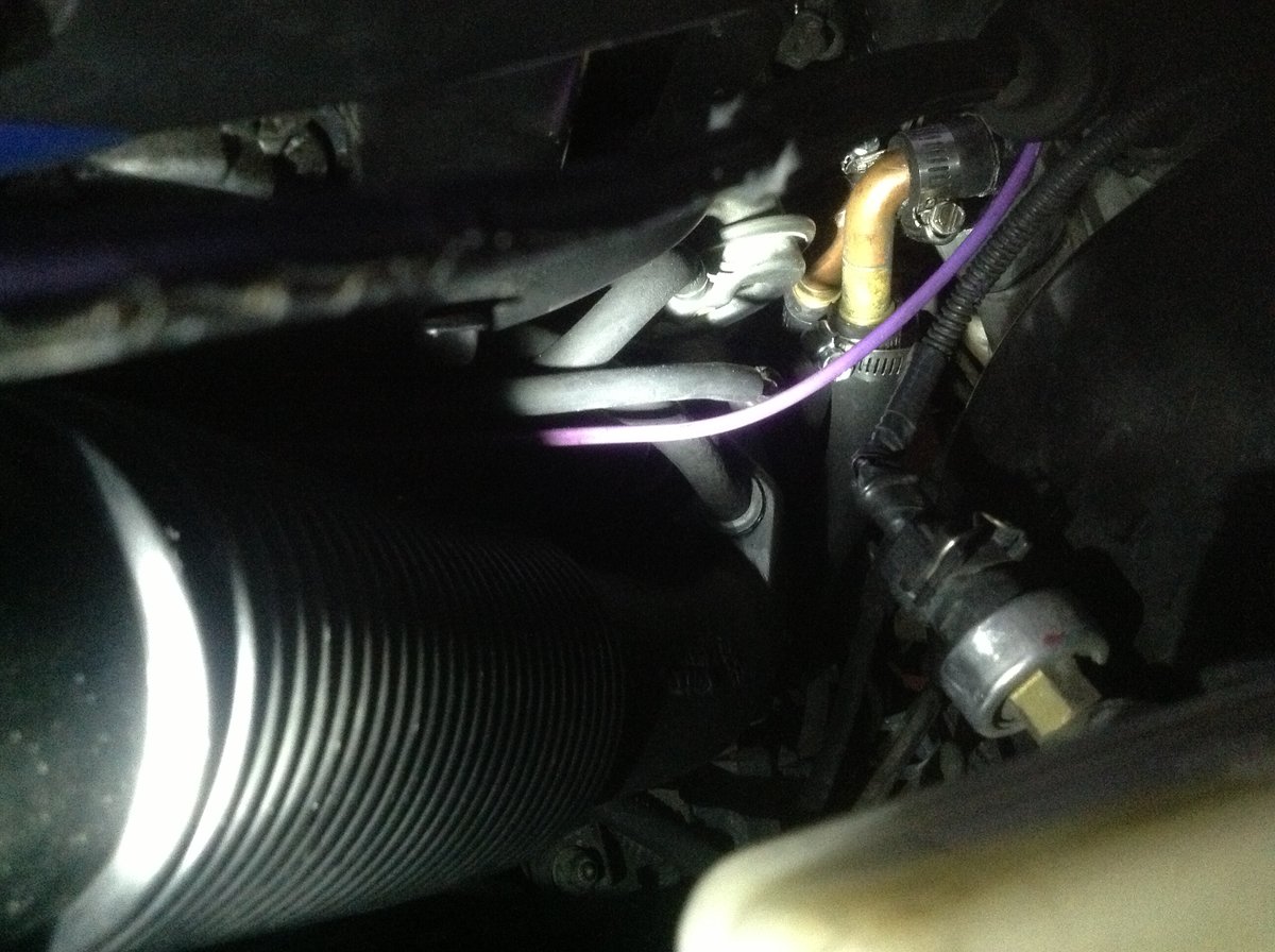

Started out with 1/2 " Gates hose in one run but decided it was too tight to push the hose onto the 2 fittings on the engine so I went with 5/8" in a different configuration. In retrospect a little grease could have done it.
Single Run 1/2" Gates Heater Hose - Could Have Made It Work
5/8" Gates Heater Hose Cut To Length To Protrude Into Engine Bay From Coupler For Attachment

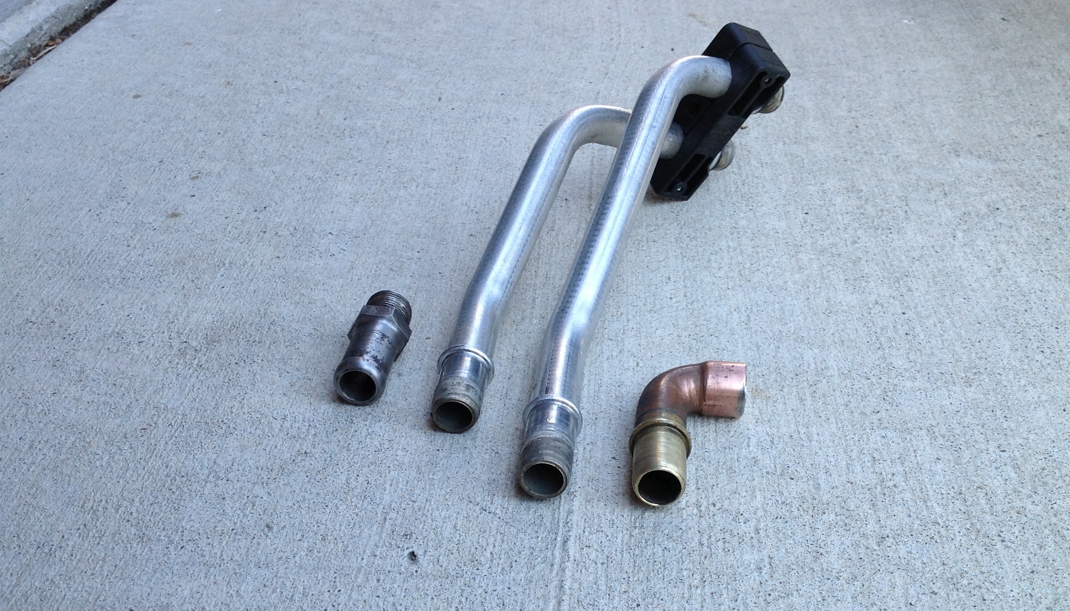

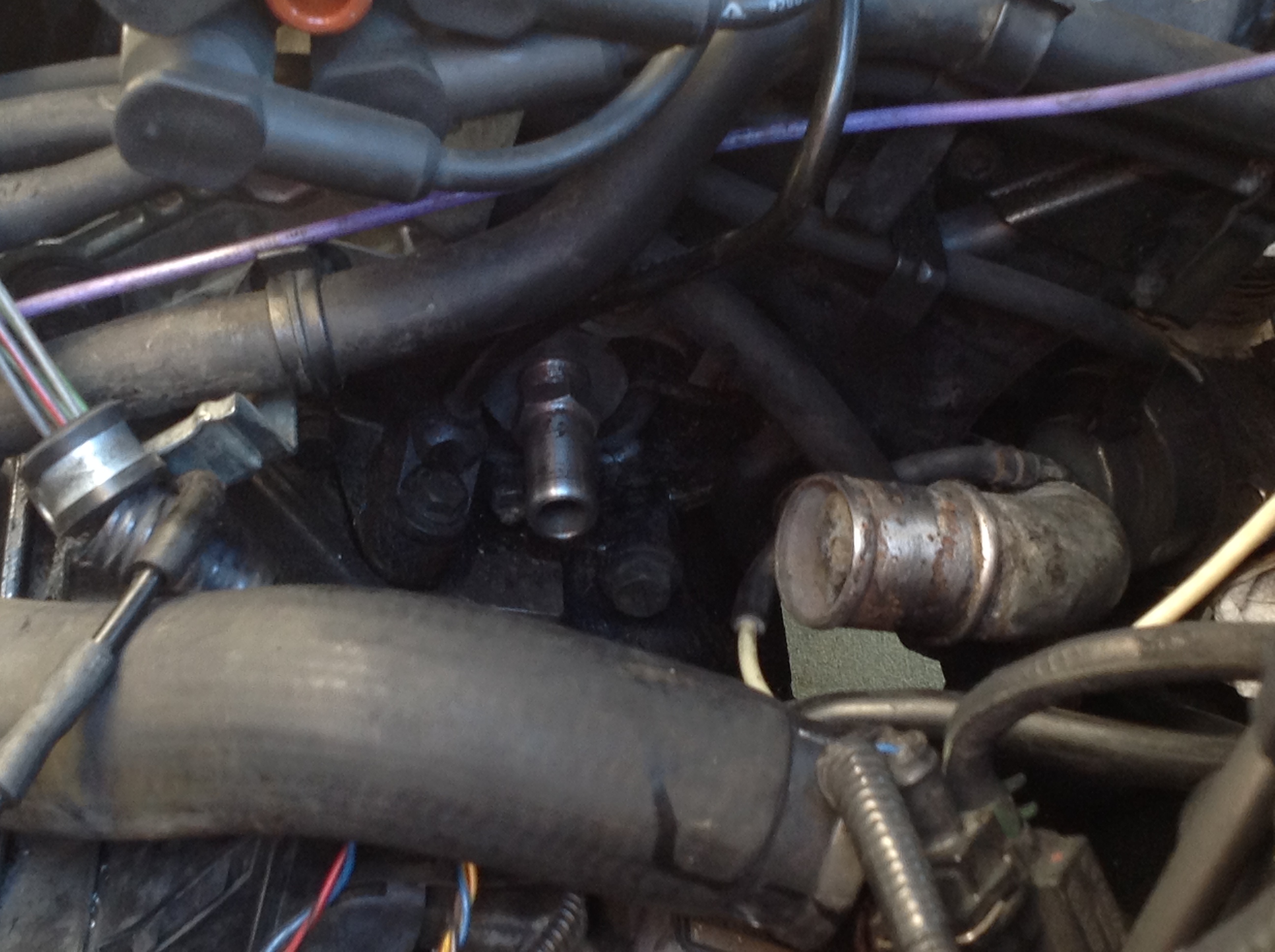

The Heater Hose Fitting and Engine Block Fitting and Heater Core Hard Line are about the same size
Removed Fitting, Sanded and Copper Anti-Seized
Heater Hose Fitting To Side of Engine Block Left Lower Side of Distributor Cap

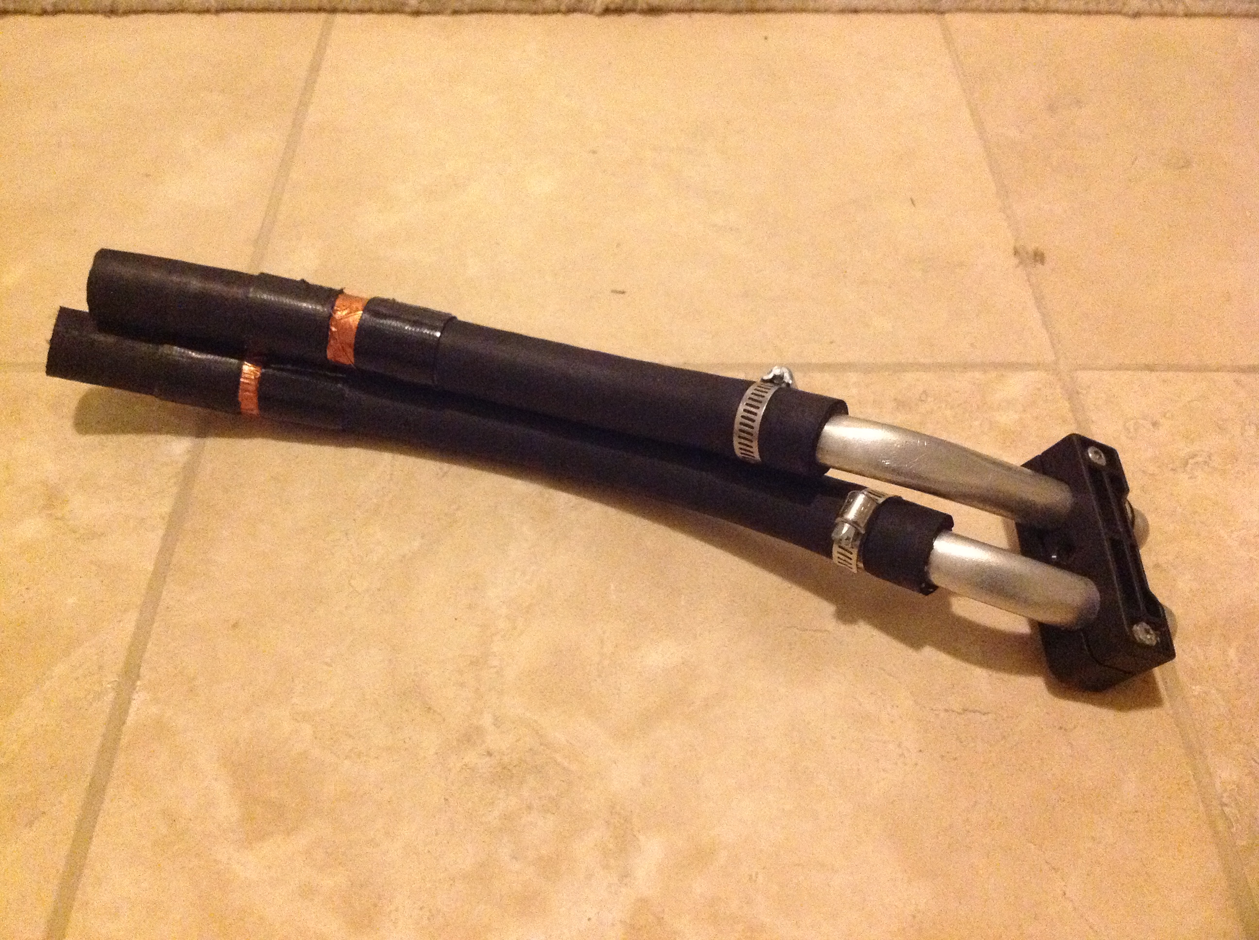

The 5/8" hose is a good fit through the Coupler opening. I used some Copper tape someone gave me and some Gorilla Duct Tape to stiffen it and fill the opening of the Coupler. The Coupler needs to be gutted by breaking the ends and sliding everything out.
Should NOT Have CUT The Tube So Short. It Did Bend / Bind When Attached To The Core Though Not Bad

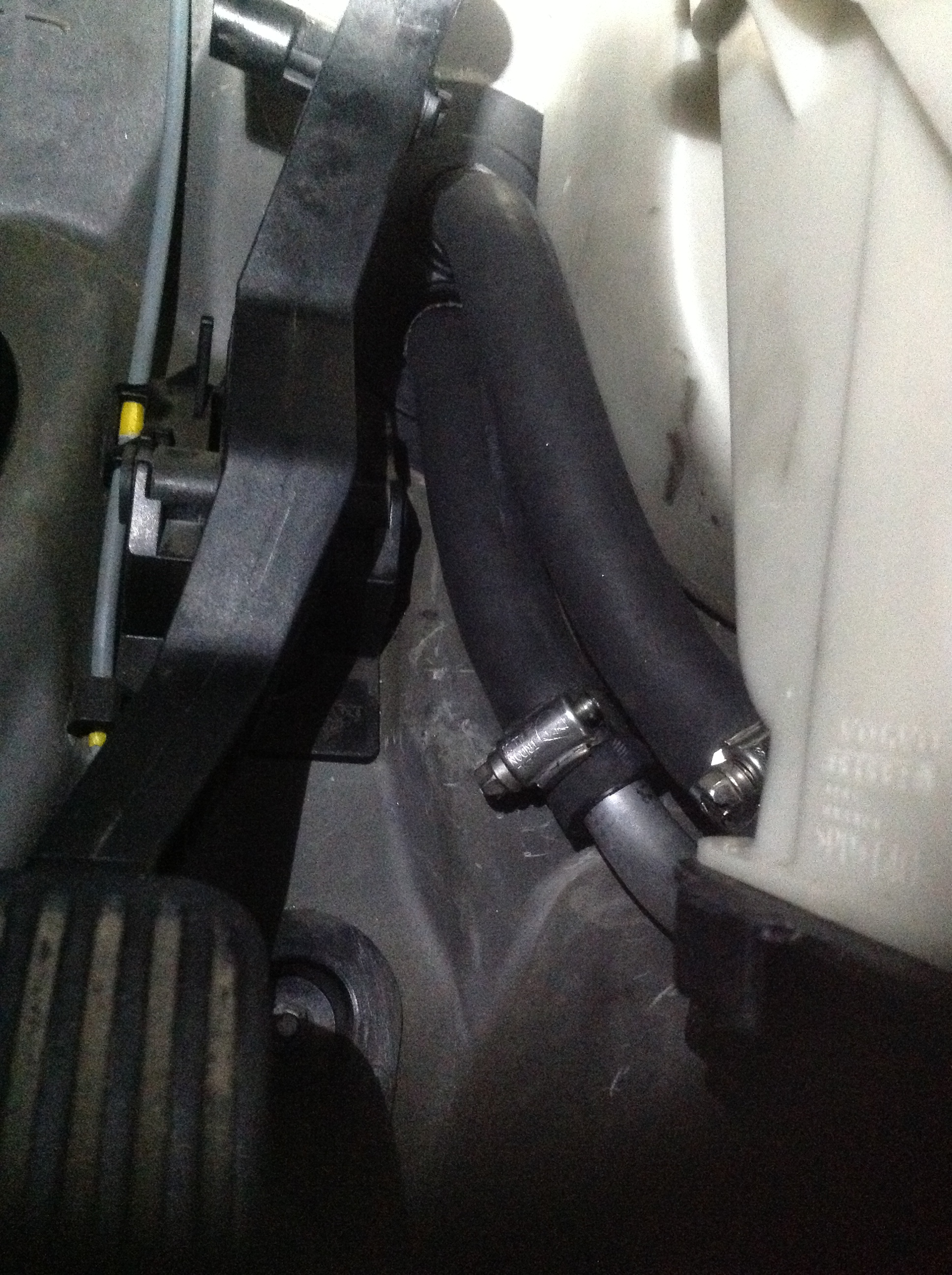

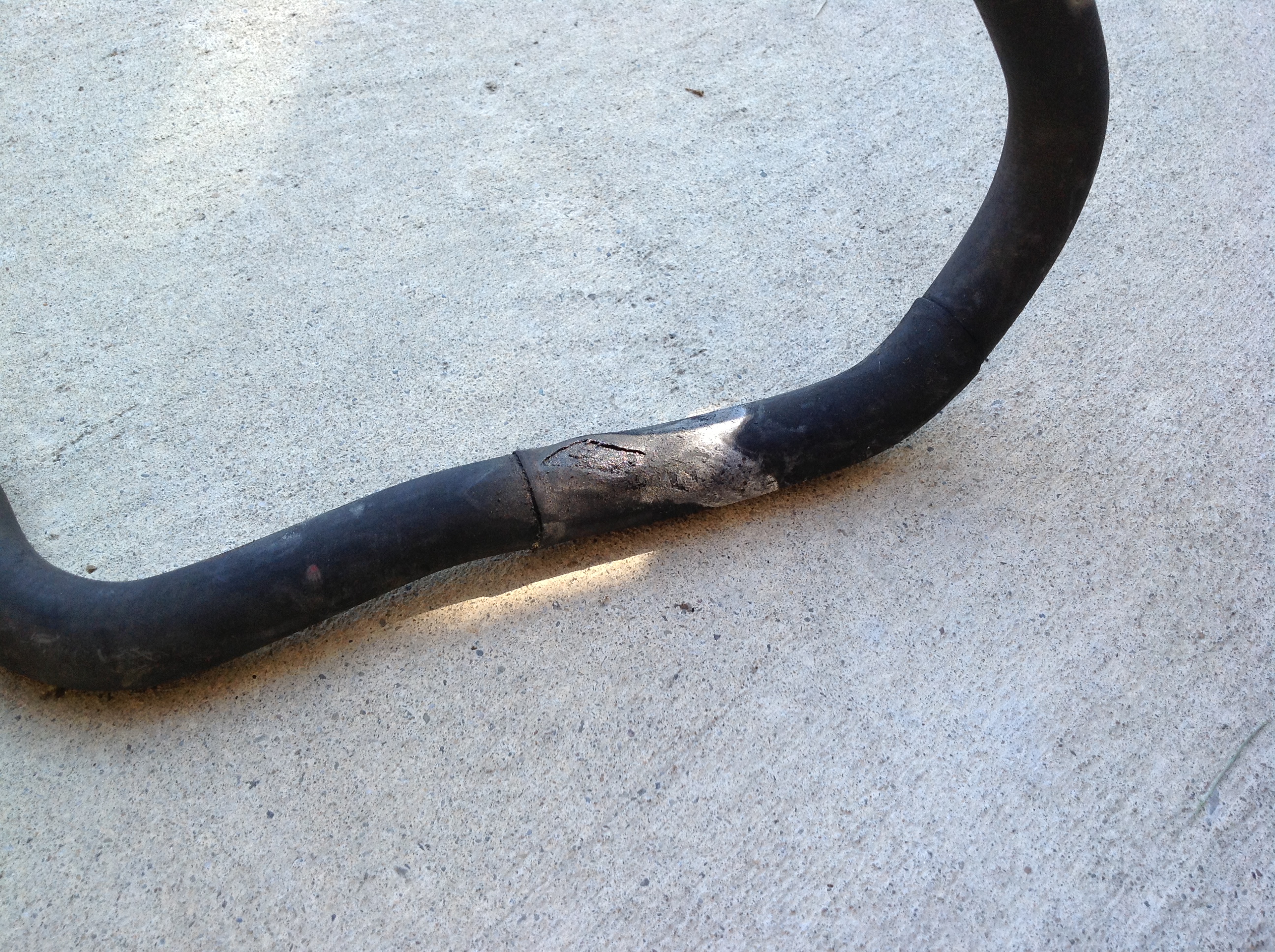

Final Product: 5/8 " Gates hose was too stiff for a single run so I had to cut it down and used the old factory Heater Core hose end fittings to make the turn. Also, due to the bending of the 5/8" hose to the engine attachments I cut the old Heater hose and split it open and wrapped it around the new 5/8" hose with a zip tie as a protective cover where it rest on the body of the vehicle (not shown). Since the hose has a natural curve I would try to see which way flexed best in order for it not to kink (not shown).

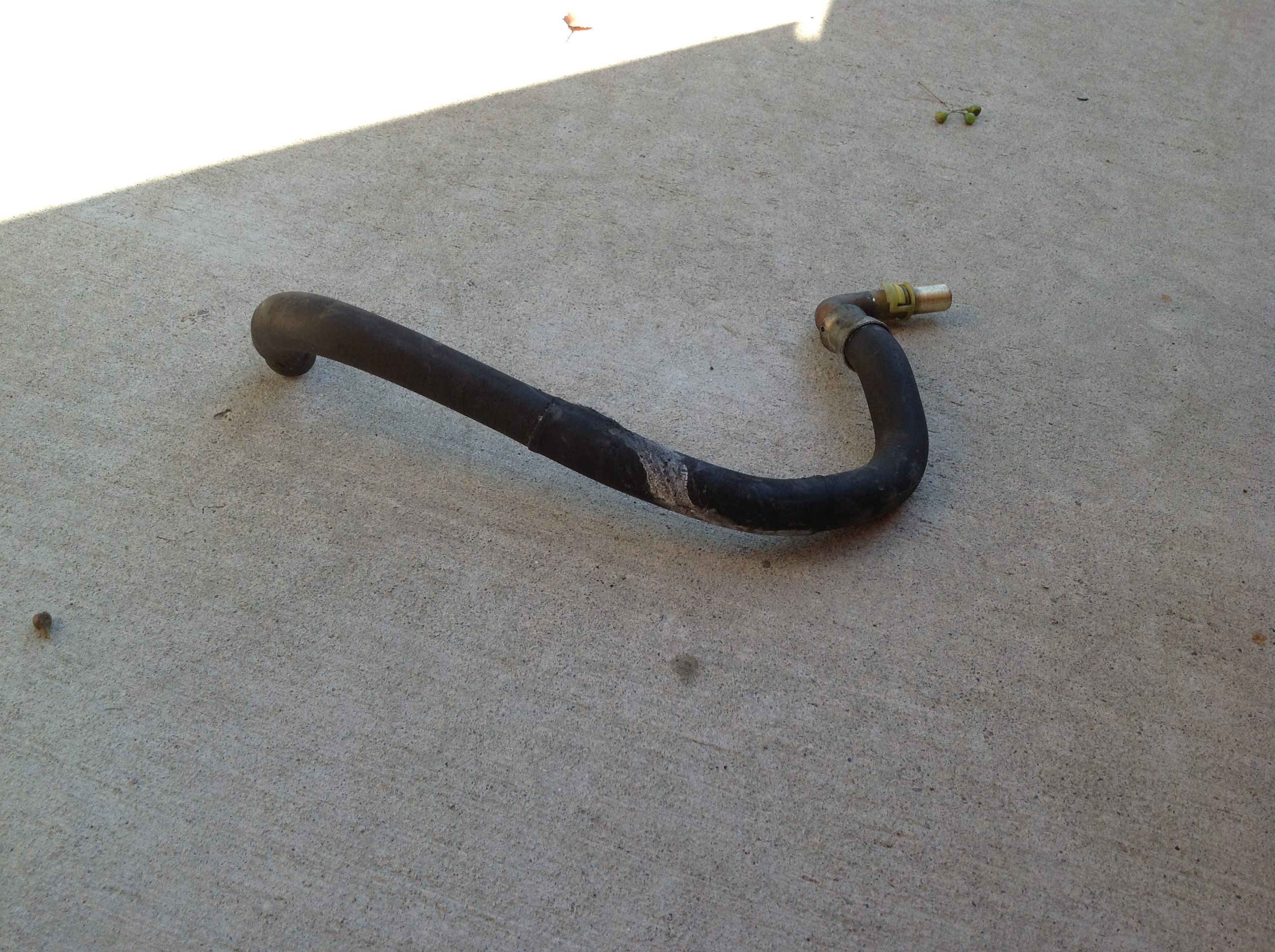

OE Courtesy of "jblackburn"
jblackburn_Heater Hose.JPG (79.53 KiB) Viewed 1344 times

OE is best, then 1/2" hose single run not cutting the aluminum tube so short and finally the end result of 5/8" hose but also not cutting the aluminum hose so short. I think the last maybe the better alternative (5/8" vs 1/2") in terms of fit and curvature besides filling the hole in Coupler fully. The 1/2" would have been much faster if you can get the hose onto the fitting on the engine.
