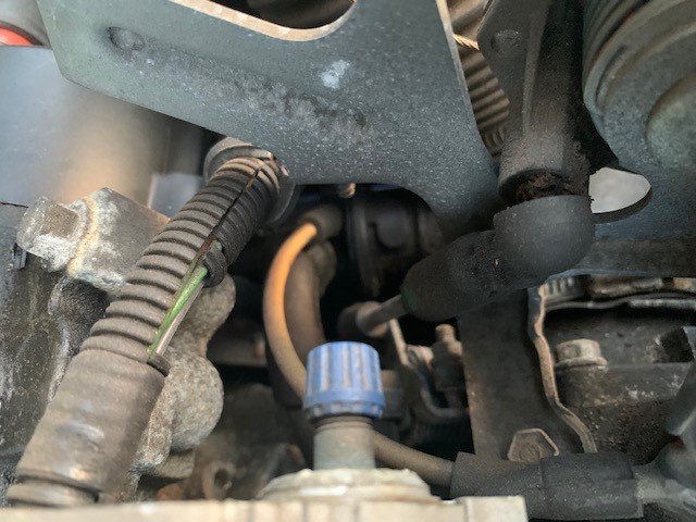

Here is the same part in my '96. The heavier end of the rod is on the "top".
It was installed the same way on the '98 n/a intake.
