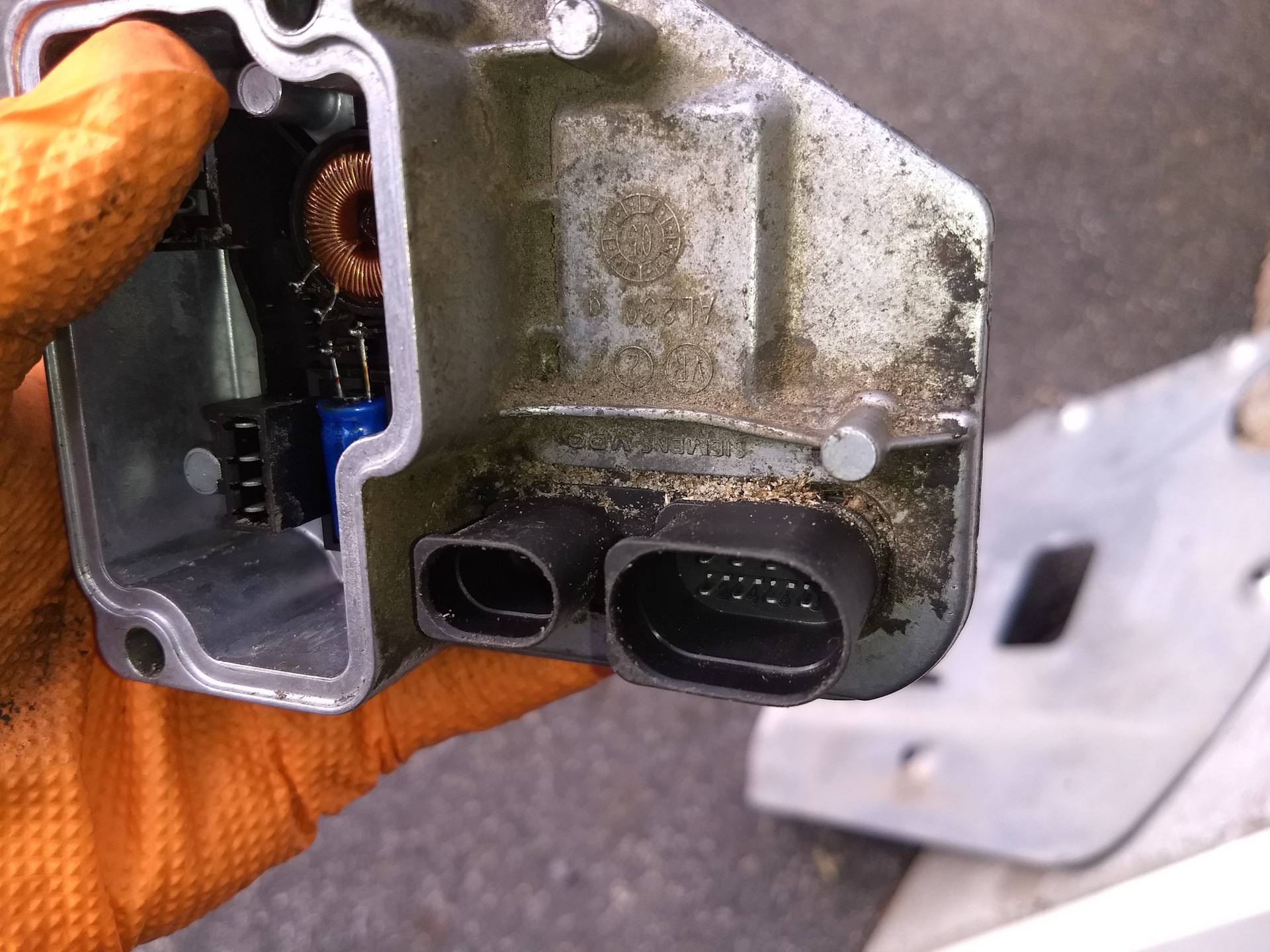

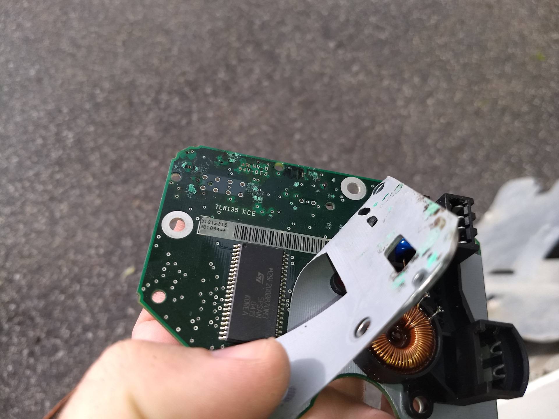

Mechanically these Haldex'es are very sturdy, they easily outlive the rest of the car. I've heard maybe about a couple of Haldex'es with clutches FUBAR.
Pull the connector out of DEM (Haldex computer), clear the codes and see if problems go away.
My DEM had a contact pad on a very small (sub 1 mm) resistor rotted completely, it brought down the BCM (brakes computer), which knocked out the rest of the car. 4th gear, no torque converter lockup, no boost, no engine power. The water intrusion was through rubber seal around the connector that was compromised by road grime. Fixed with donor resistor from parts motherboard, cleaned everything, resealed, added an IPD DEM cover to keep exhaust heat and water splashes away.

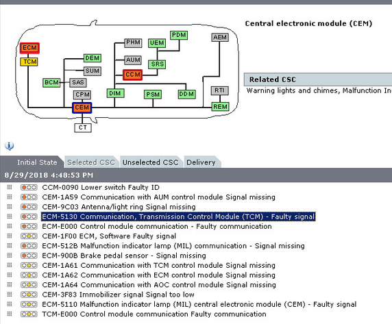

My codes were:
I.e. high speed CAN bus crapped out. The repair:
My codes were:
