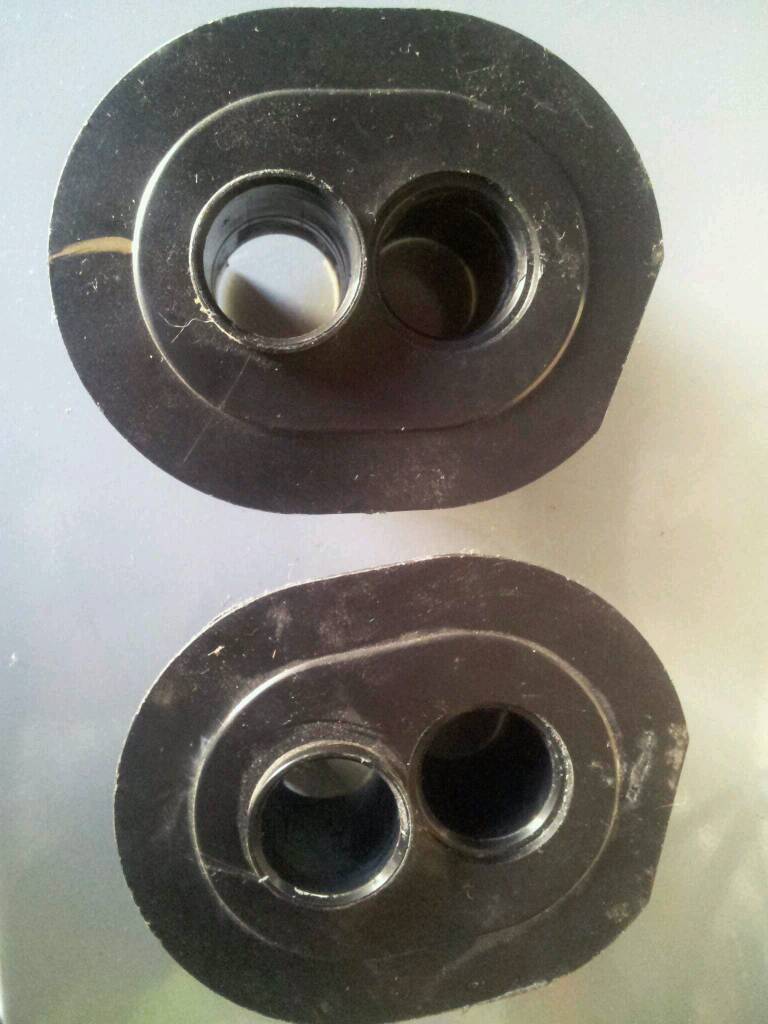

Sorry to nitpick but you forgot the price of 2 extra hose clamps for the cabin side costing about $1.50 each so around $49 all up. These couplers below are ready to protect hose.
You can cut the metal pipes a little shorter and get a great looking noise cancelling grommet which looks factory made. Fits 5/8 hose perfectly.
With a bit of pulling and penetrant spray they gut very easily.
