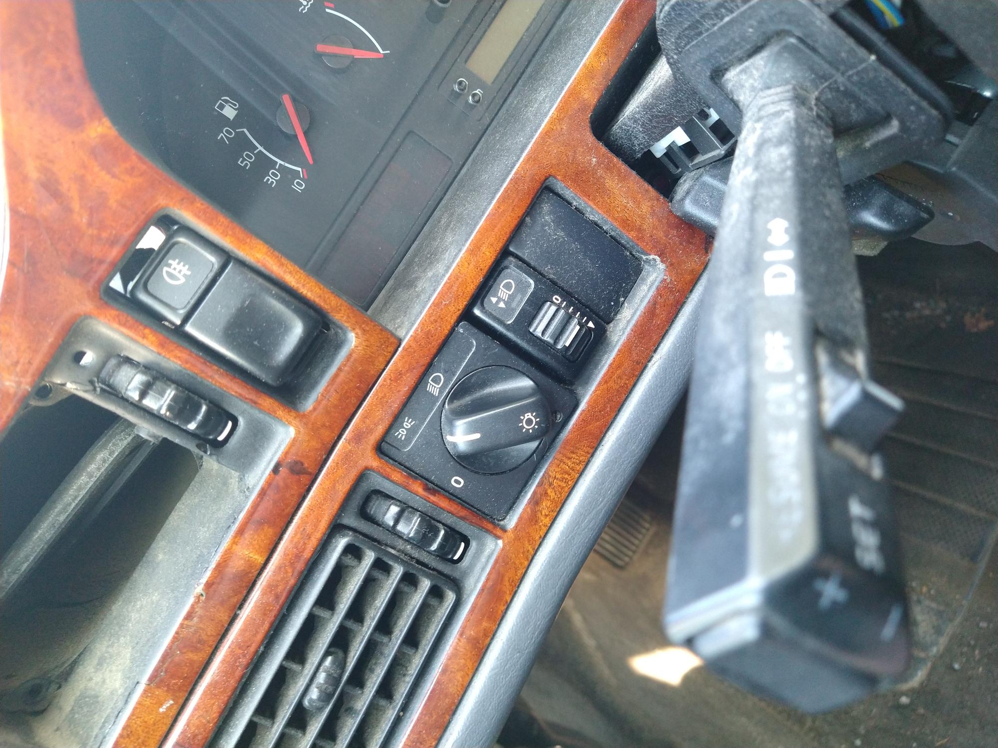

I want the cool headlight adjuster on the dash as well as a p80 AWD m56
