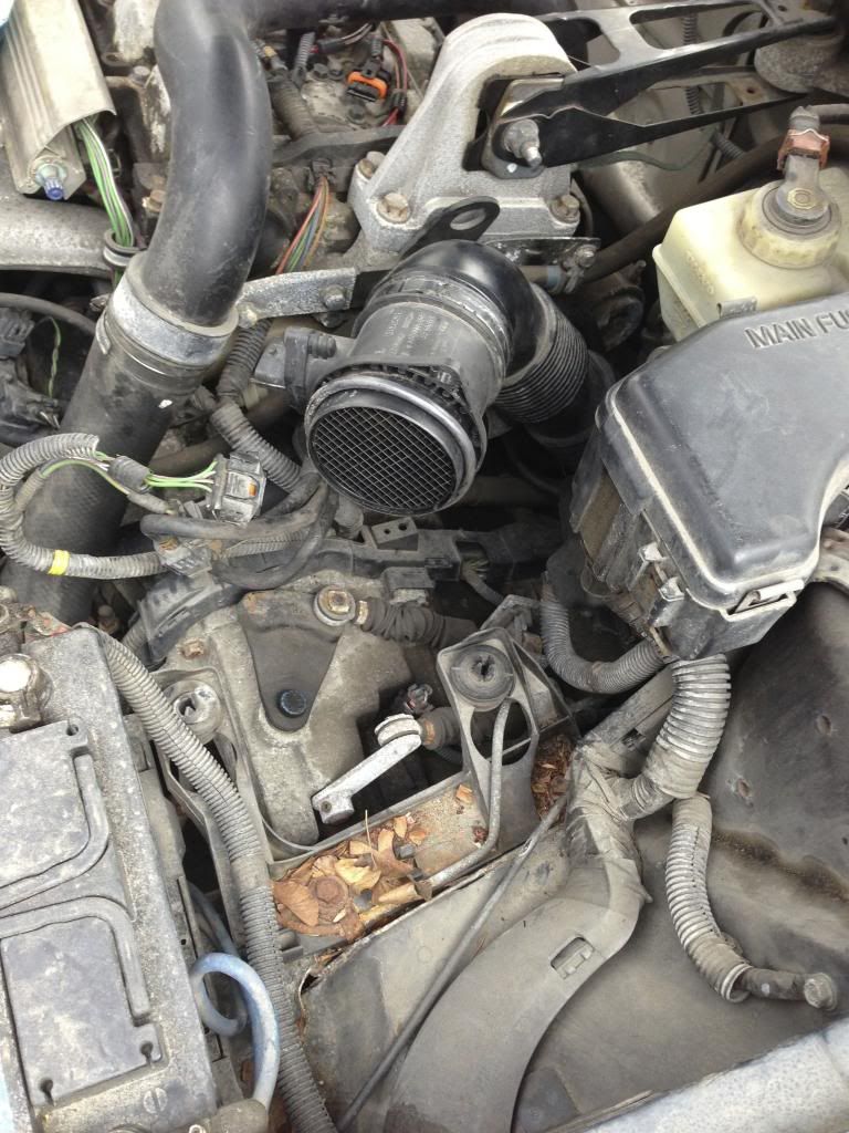

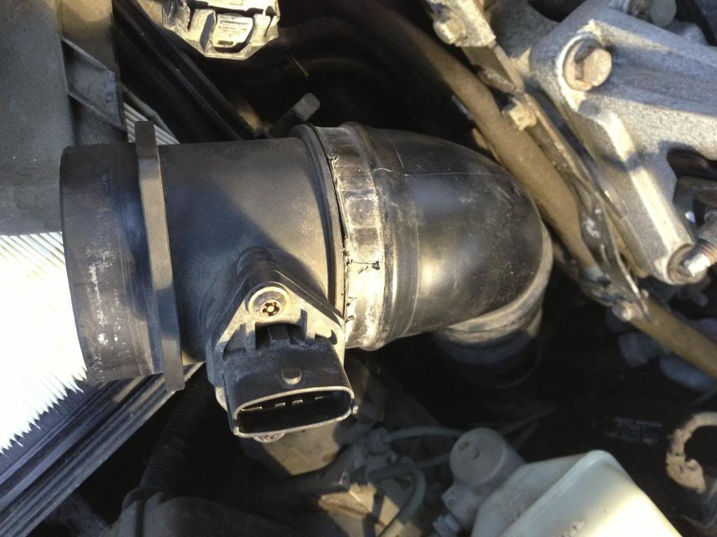

Thread to document and picture my cleaning of Mass Air Flow Sensor on my T5
Thinly veiled attempt to get some respect (R Dangerfield) on this forum.... :lol:
One special tool needed - Volvo part 31415926535 - light green turbo hose fixture ( see pictures)

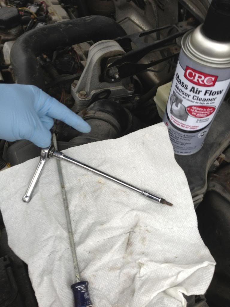

Tools and cleaner required

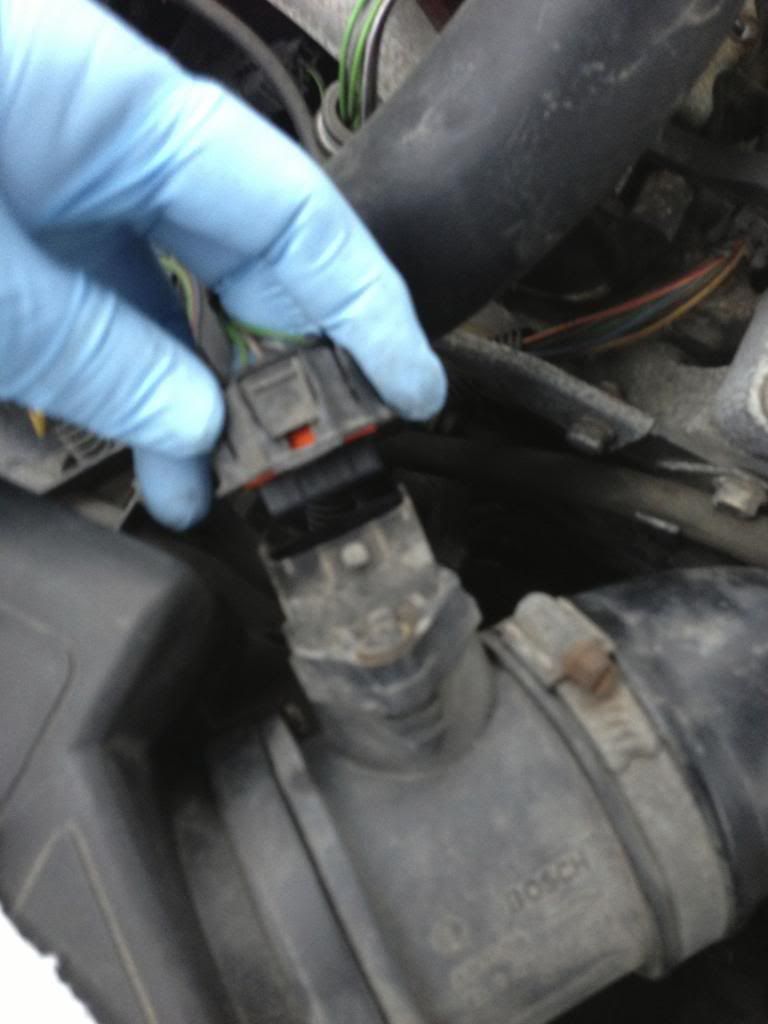

Remove connector from MAF

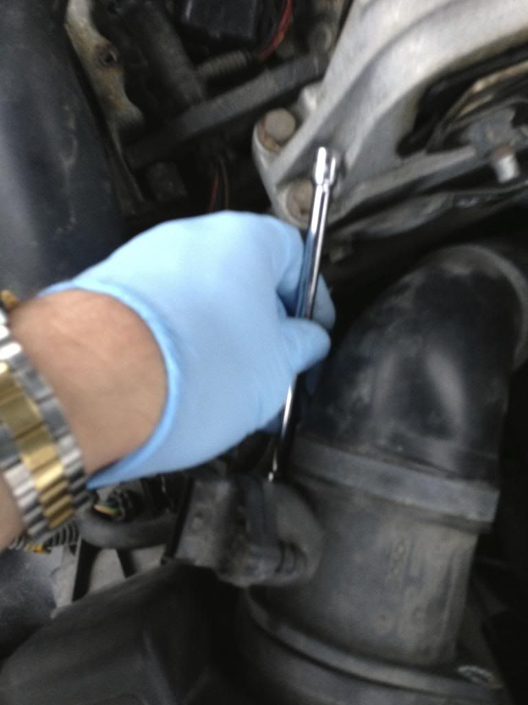

Remove 2 Torx Screws from MAF to Air cleaner housing
Remove MAF and Air cleaner housing from car
Leaving behind MAF connected to turbo hose (note large O-ring on MAF may stay in Air cleaner
