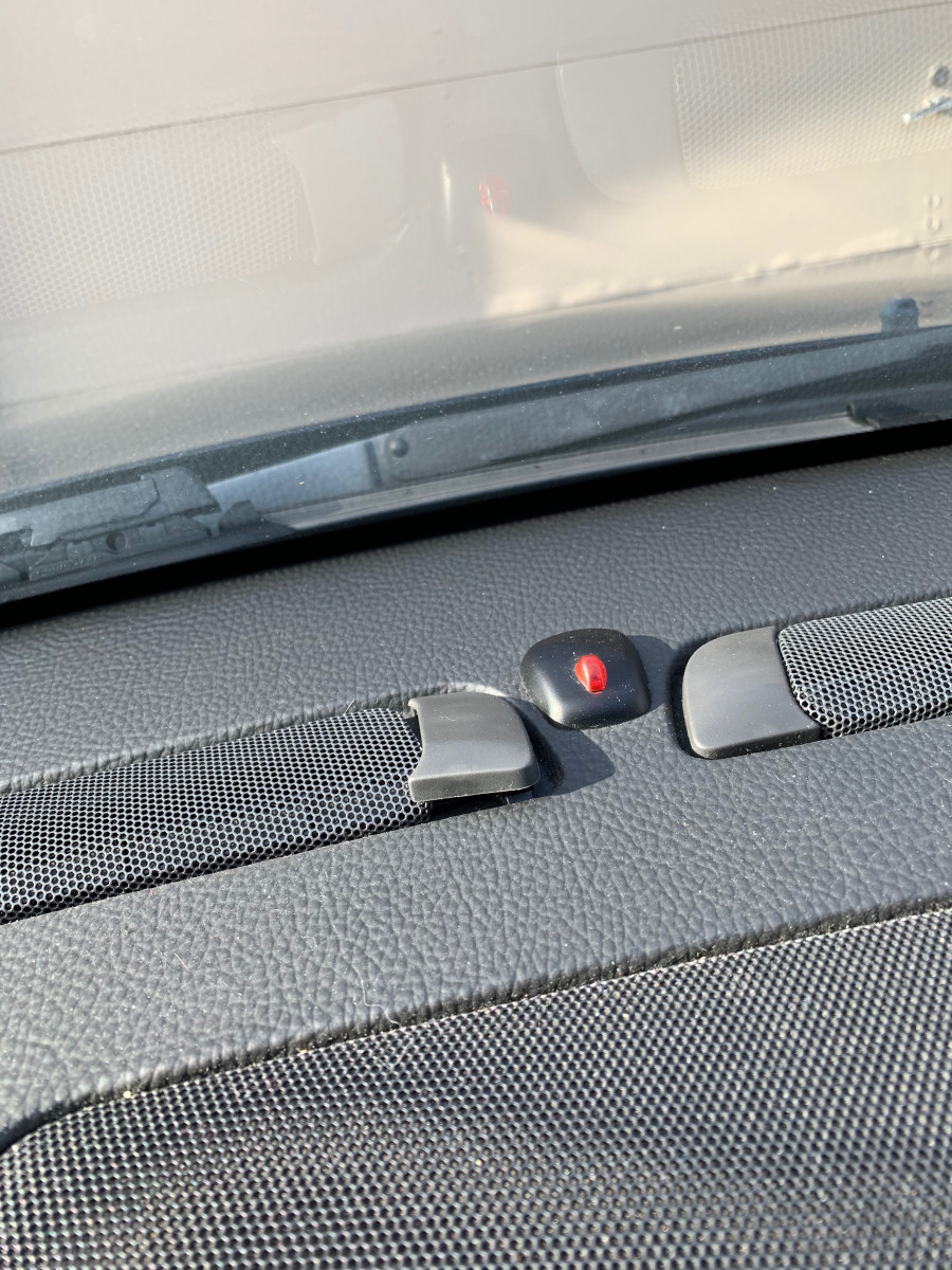

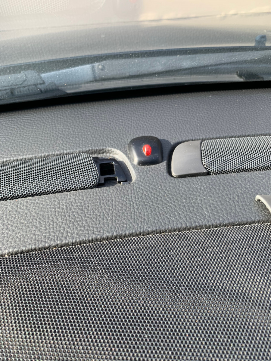

If you decide to junk it, I need one of these (left side of the diode) in black Image

erikv11 wrote: 10 Mar 2020, 14:47 If you decide to junk it, I need one of these (left side of the diode) in black Image
Hot Glue Gun and quick setting in place will hold you till the diode or you lose the part.
You would be out of luck again. Both are missing on this one.
I can keep an eye out for one in black when I raid the local self service yard.

MoVolvos wrote: 10 Mar 2020, 15:47 ...
Thanks, good idea to put it in place temporarily.
RickHaleParker wrote: 10 Mar 2020, 18:21 ...
If you get to it, thank you! It's on my list but trips to the yard are very few for me.
