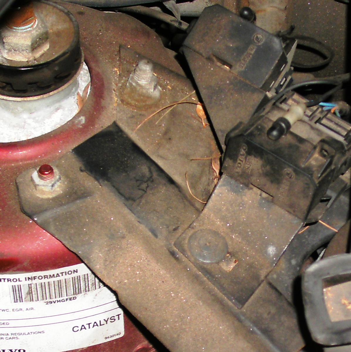

Problem2 is I still can not locate this "code box" (excuse my ignorance) - there are so many gadgets along the drivers-side fender and since I don't know what this box is suppose to look like I'm still clueless. I am going to take some pictures and maybe someone can tell me what to look for....Thanks

- I am thinking this may be it (codebox)?
- 001.JPG (409.88 KiB) Viewed 1238 times
- 002.JPG (272.67 KiB) Viewed 1238 times

Let's get it running properly then you can clean it.Wow! after looking at these pics my engine seems pretty dirty

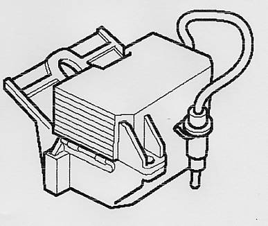

The diagnostic box is mounted in front of the left strut tower and looks like this:
The top cover lifts up to expose 6 holes for the test lead.
Bill.

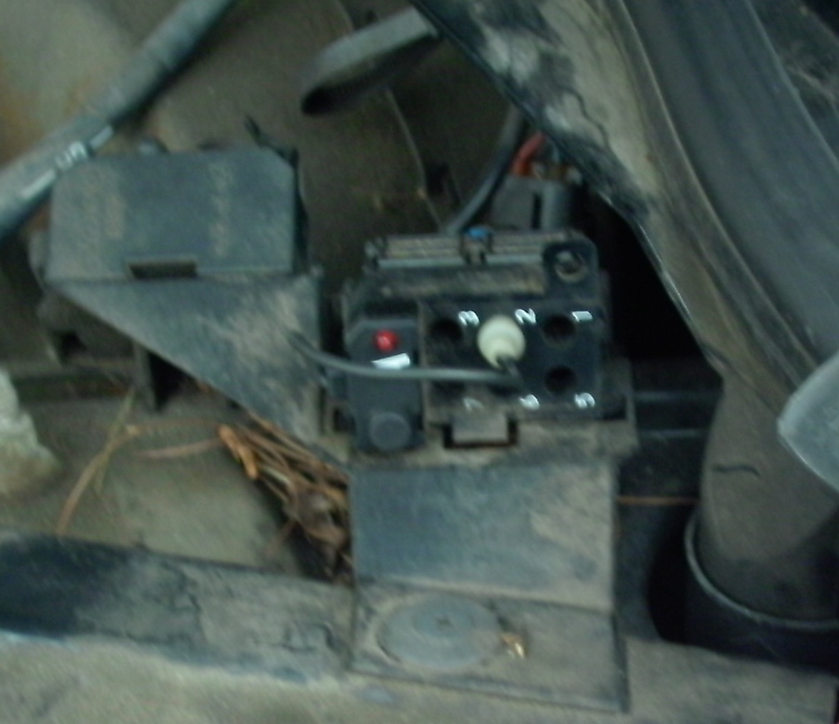

Thanks! in the last 2 pics (in attachment) is this the box? and where can i obtain the tool for pulling these codes?

It certainly looks like it. The 'tool' is attached to the box. It is a fly lead that you insert into the appropriate hole in the box - #2 for the fuel system and #6 for the ignition. The instructions are in the attachment in my earlier post.

Thanks again!! billofdurham..I located and open box and plugged lead into #2 & #6..but ...do I hold the activation buton down until I get 3 (3digit) readings ? or press it 3 times to get the 3 number code?
- Thanks again!! billofdurham..I located and open box and plugged lead into #2 & #6..but ...do I hold the activation buton down until I get 3 digit reading ? or press it 3 times to get the 3 number code?
- 001 (2).JPG (206.46 KiB) Viewed 1225 times
