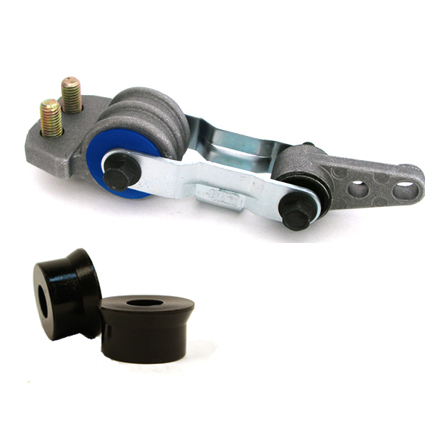

Post by rbodor3 »
does it feel like a bad shift from the transmission?
Sounds like a bushing to me.
Check the upper engine mount (upper engine, driver's side, black rubber bushing). If that's not it then lift the front end, remove the plastic catch pan (12mm IIRC), and check the lower transmission mount. As soon as you drop the pan you will see a bushing similar to the picture. Both of these are common failures for the s60. Shudder would likely be worst in low gears and bad shifts with the transmission, and would vibrate at idle if the engine mount. Any sort of cracking, or breakage at all would mean new ones are needed.
trans mount.jpg (119.22 KiB) Viewed 7852 times

Thank you for the reply. Hopefully I can reach these mounts myself. The engine does seem to vibrate more when I put it in reverse.

Post by mikod4 »
Checked mounting bolts and bushings..everything is fine: however when on road, car still shudders at low acceleration to 35 to 40 mph, only. When I'm on the open road or the highway, no problem. In the city or going slightly uphill, it seems like it is coming from transmission.
