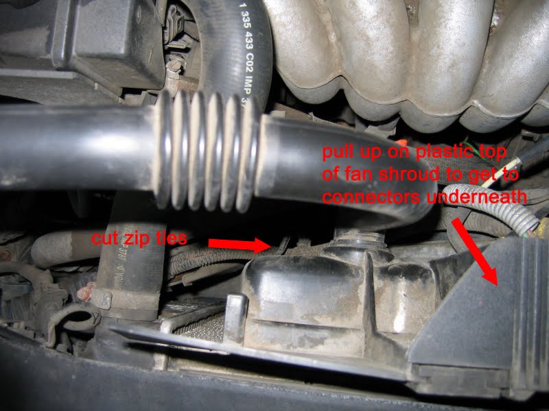

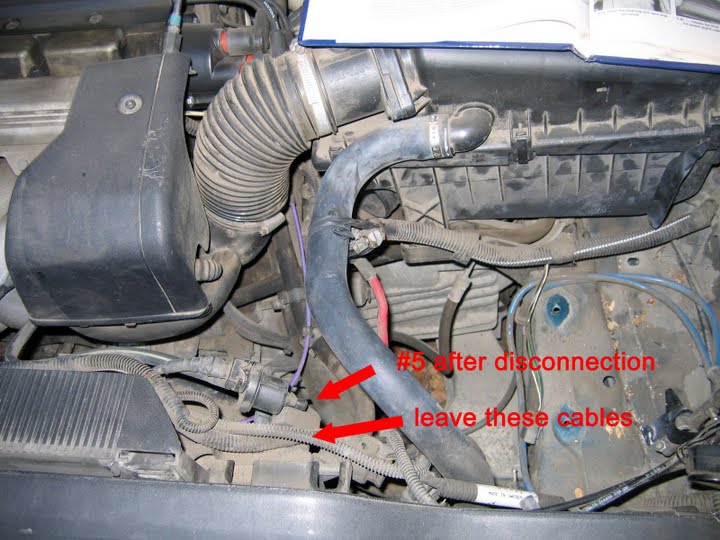

5. First, remove the torx screws show here. There are also 2 hex screws to remove about 3" directly below the torx screws. Pull up sharply on the top shelf of the fan shroud to separate it from the fan shroud body and access the electrical connectors below. Disconnect those. Cut the zip ties that secure the cables to the fan shroud so the cables can remain behind when you pull the fan out. Disconnect all the cables that are shown in the picture. Basically you want to get them all off of the fan so you can leave them in place and take out the fan. The one labelled #5 is held on to the shroud by a metal bracket, once the hex screw (#2) is removed the bracket can be snapped off from the fan. Disconnect the rubber connector below the area held by the bracket.

6. Once the fan is disentangled from the cables you can lift it directly up, leaving the top part off to the side still attached to some connections. The hose at the left going into the box with the timing belt diagram on it can be detached close to that box. Remove the fan from the engine and set it aside.

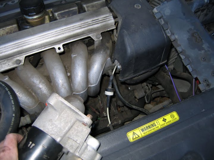

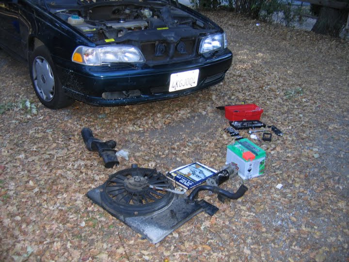

Picture of the fan shroud and air intake hose out of the car.

Picture of the engine compartment with fan shroud removed and the top portion moved to the side, and the connections that need to be removed from the solenoid.

New starter going in

FYI, #5 is an electrical valve that is part of the Evap system that routes vapors from the fuel tank first into a carbon canister and then into the engine.

holler1 wrote:FYI, #5 is an electrical valve that is part of the Evap system that routes vapors from the fuel tank first into a carbon canister and then into the engine.
Ah, good thing I hooked that part back up then :) I didn't know what many of those connecters were, I had names for them in my head but I should not repeat them in public :lol:
