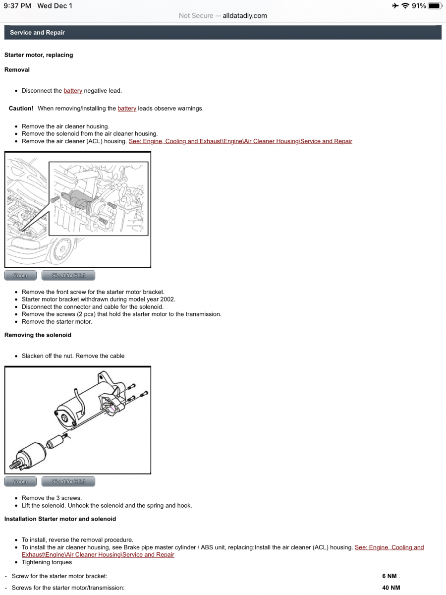

Here is the procedure fir swapping the starter on the T5, good luck with this.

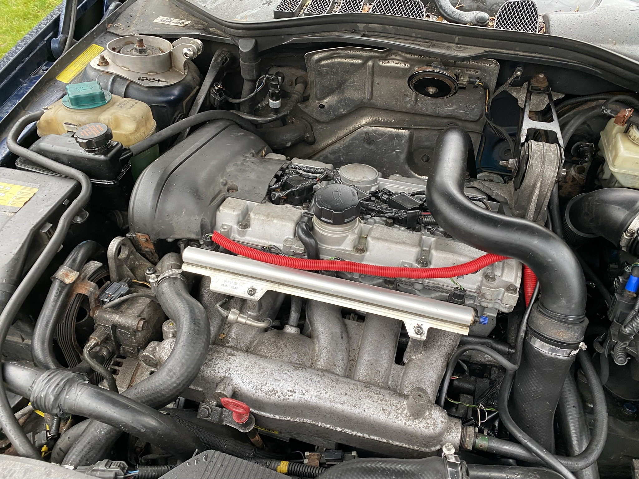

.and here is the harsh reality. On the T5 the charge air pipe badly blocks access to the starter, most of this work is blind.

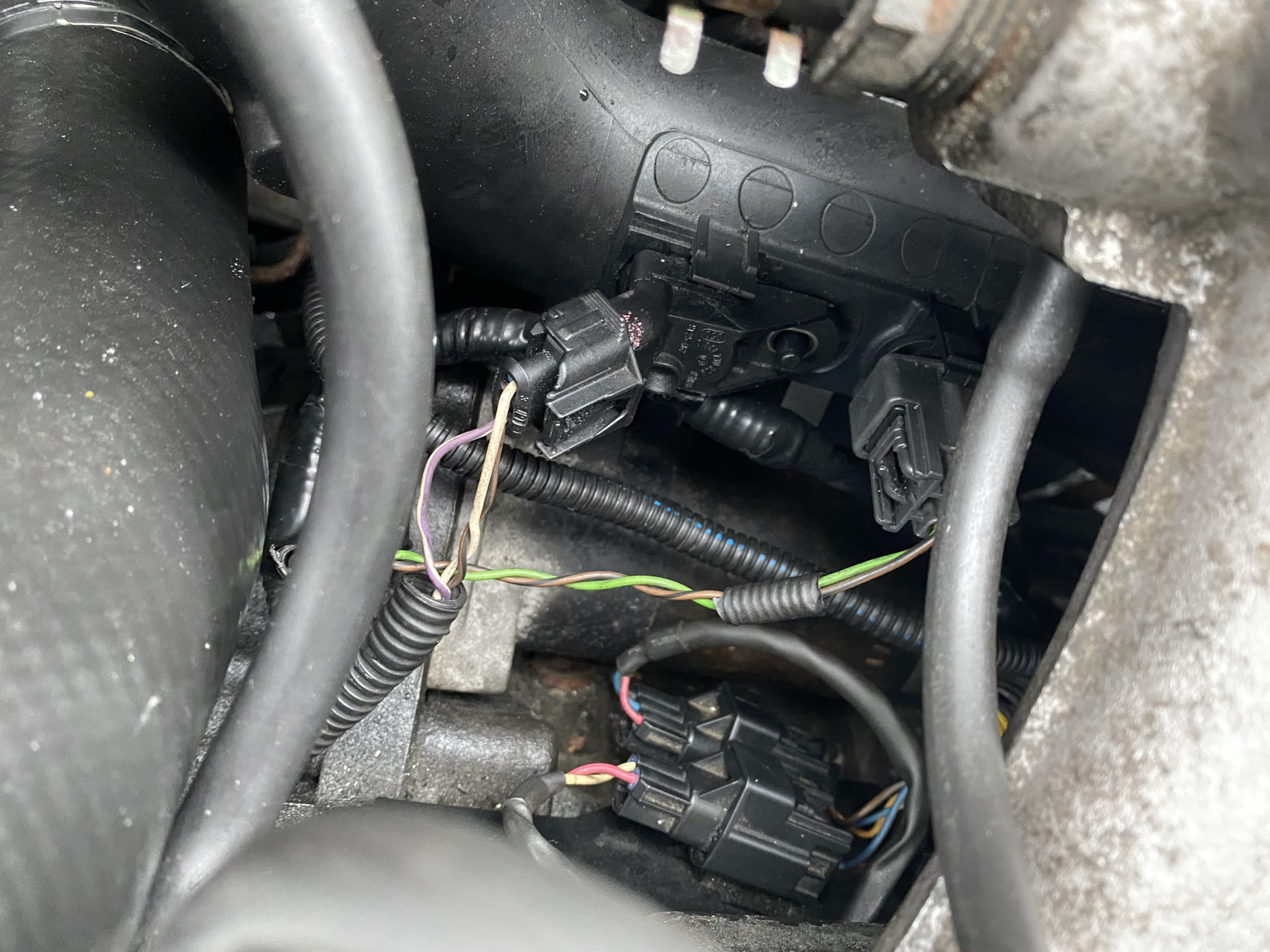

Remove the connectors for the IAT and MAP on the hard pipe, then remove the sensors. These puppies are not cheap so you don’t want to break them. A touch of silicone on the oring on the MAP makes it easier to install. The IAT sensor is fragile so keep it safe.
Remove the battery cable nut by hand, it a bit tight so work deliberately. You have to install the solenoid push in connector by hand, blind. It sits vertical just below the battery 12V nut
I clip the two connector for the crank sensor and cam sensor by easing them to the left, then tucking them out of the path.

Self rant. You can make this job much easier for yourself if you can remove the hard pipe from the electronic throttle body. If you plan ahead next time it’s off, leave the clamp head (7mm hex) pointing to the left side of the car so you can reach it blind under the intake manifold, then this job, and access to a lot more stuff , becomes simple.

Paradoxically, I think the best place for the clamp is with the hex in the rear, facing to the left of the car
With a 7 mm hex on a long extension, you can tighten it pretty easily.
Here’s the real world “view” of the starter on the 1999 T5 - see how those sensors and plugs block starter removal
