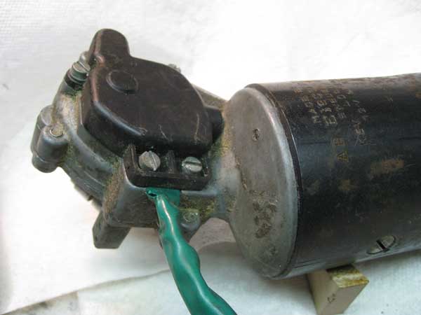

VADIS is of no help as the pictures for both motors are identical. However, after a little digging I came across this which may be of some help:
wiper motor - electroluxl.jpg (19.13 KiB) Viewed 1585 times
Electrolux: In addition to markings on the motor itself, later Electrolux manufactured assemblies are also recognizable by the molded black plastic cover which protect the Parkswitch and harness connections, and they typically have a green sleeve protecting the harness running to switch. These are, in my opinion, the nicest design of the three early type wiper motor assemblies I have seen.

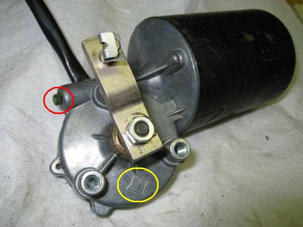

wiper motor swf.jpg (31.89 KiB) Viewed 1585 times
SWF: I was not able to find any manufacturers markings on the motor itself, but after cleaning grime away, I finally spotted the manufacturer's definite logo in the maingearbox casting (ringed in yellow). SWF supplied assemblies typically have a black sleeve protecting the harness running to switch.
The above is taken from an article on this site.

bill, as stated before, i am working on my brother's volvo, but with all the help you give i would be tempted to trade in my ford for a volvo! i am hoping to come to the end of this project this weekend and will let you know how all your and my work has turned out. i ordered the electrolux motor saturday evening hoping the more expensive one would be the correct on (it usually is). thanks again for your help--you are wonderful! dawn
