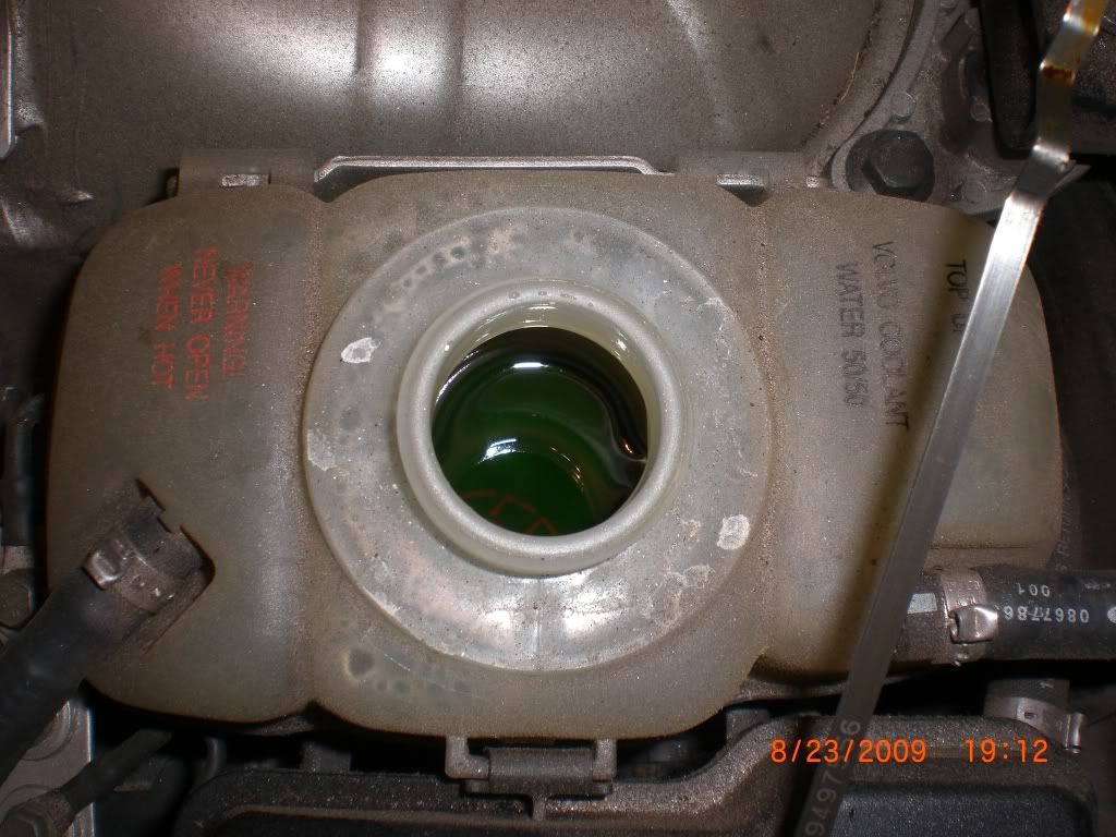

White smoke is usually an indication of water/anti-freeze getting into the combustion chamber. Have you checked the coolant?
This link exhaust troubleshooting will lead you to more about different coloured exhaust smoke.
Yes, we have the steps to do the jobs if you still need them after checking the coolant.

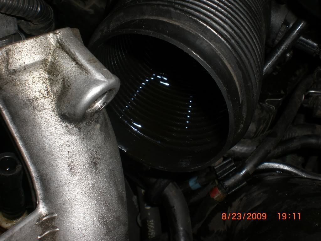

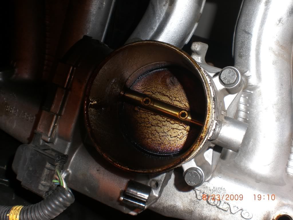

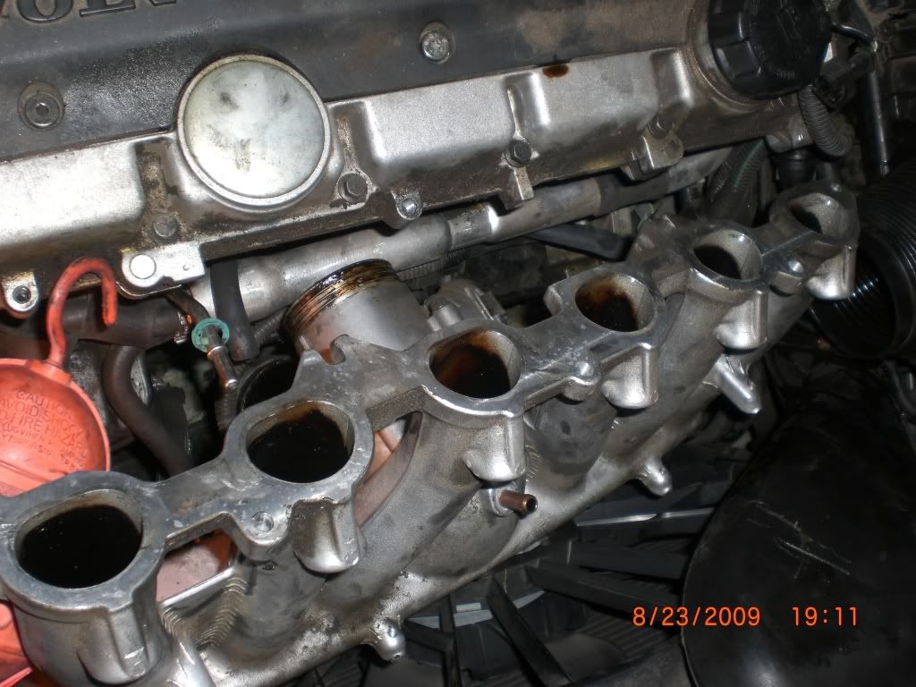

Hi Guys,
I took the intake manifold off and literally there is oil everywhere, (Intake, turbo lines, rubber hoses, etc) does this point to a faulty turbo, oil trap or PCV system? The coolant looked ok to me. I believe the smoke is more BLUE in color also. My apologies there. It is definetely oil burning, but from where??
Pictures added
Pictures added

Could be a blown seal in one of the turbos. Is there oil in the tubes going to the turbos? After the turbos?
I'd bet my butt that it is one of your Turbo's. I just purchased my first Volvo an 04 XC90 T5. I paid $4100.00 for a car that blew smoke out the back that would make the Batmobile blush. The dealer and a local Volvo shop had told her that she had a bad engine. I suggested she had a Bad Turbo. She just wanted to get rid of it. Lucky me.... I kinda like it.
Same symptoms, turbo whine, smokes like Crazy, oil pooled in the turbo inter-cooler and inter-cooler hoses. The Inter-cooler hose that is wet is the turbo that has the problem. Another way to check is to look under the car at the Turbo's where they meet the exhaust manifold. One turbo will have oil on the housing and outlet pipe.
Once removed, the shaft on the turbo will have endplay where there should be none.
I located my Turbo through car-part.com, a wrecker locating service for $200 with only 60k on it.
One thing .....that almost made me think the dealer didn't lie. After you replace the turbo, plan on it burning off the oil buildup in the inter-cooler hoses, PVC, and Catalytic Converter. This could take 5-10 miles on a freeway.
Do this at night..... somebody might freak out and call the "Gross Polluter" hotline.
You may also notice an apparent oil leak near the left front. This is normal, there is a seap hole in the inter-cooler for just that purpose.
