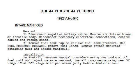

I'm curious about how long it should take to replace the intake gasket on a 1992 940T. Anyone have an idea.

I looked this up in a workshop guide and found 1 hour to be the time allowed. Fast worker or octopus? However, when I read what is entailed that would be right for a trained fitter. Allow a little more for a novice.

Thank you Bill. I did the job a week ago and it took me about two hours as I tend to work slow. Easy job for anyone to do though. Thanks again.
