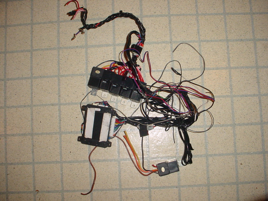

Unfortunately with something that is aftermarket it becomes a real guessing game. My son had aftermarket remote start and keyless entry on his car. The starter went bad and killed the system. This is what I wound up removing from the car to get it to start again:
It was all under the driver's side lower dash panel.
