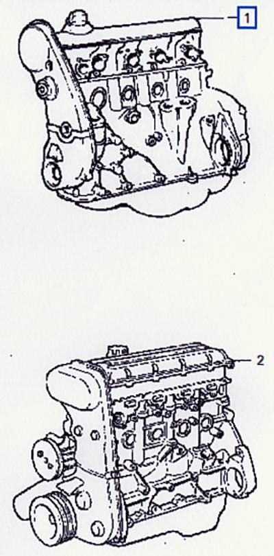

put in gas, oil, fuses. general things. now this car had a new motor put in when i don't know was told that when i bought the car. everyone is asking (repair places) me if it is SOHC or DOHC? I can't find it so I do I know?

#1 is SOHC, #2 is DOHC.
The DOHC is an interference engine.

my car has been sitting for a week and I went out today to get the #'s and i couldn't get the hood open. it is tricky to get the hood latch to open it. by guess which i know isn't good it looks like a SOHC. I will have to find a way to get the hood open. Where is the best place to take it that isn't going to charge a crap load of money to fix it? or is it something you can do yourself?
