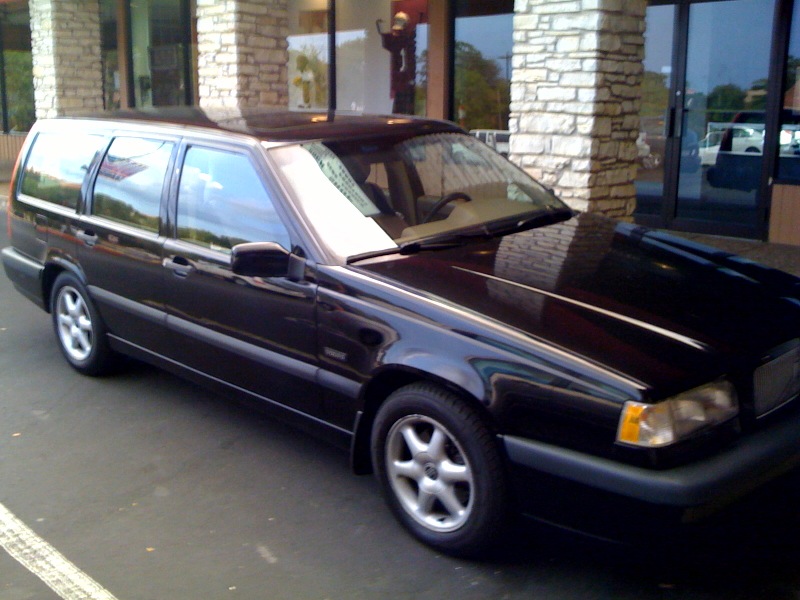

VERY TRUE!!--is it a Black color or is it purplish ?---looks reallly NICE...don't junk it!
