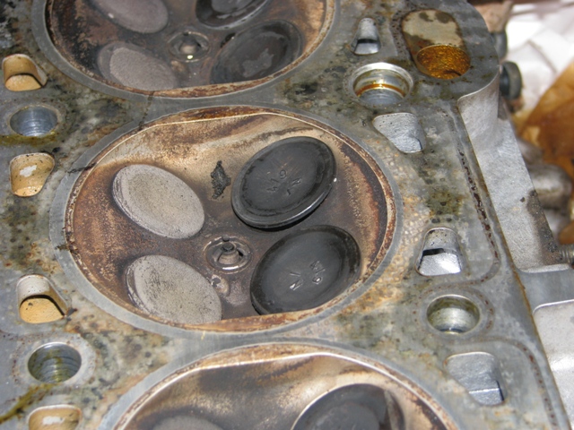

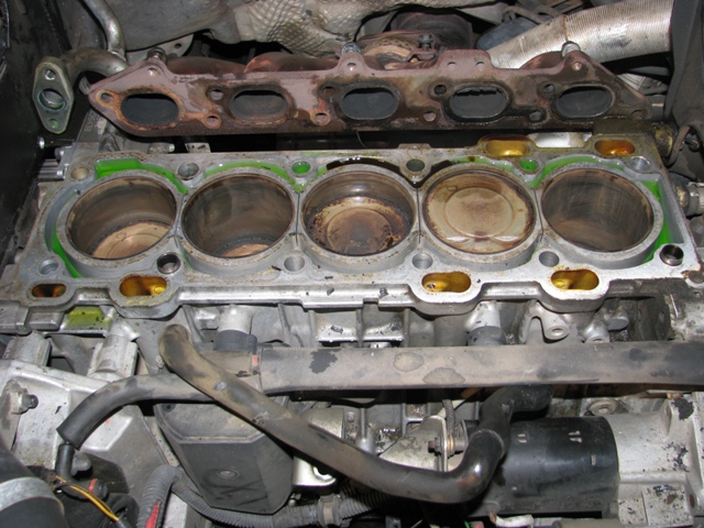

Spent the morning(well most of the day actually) tearing down the engine. And there it was two nice little dimples in the top of each piston on the intake side. Bent valves on all 5 cylinders. Now to find a used head or have this one reworked. Any more suggestions?

The dimples on the top of the pistons are by design. What you need to look for is sharp gouges since they will create hot spots. If you have them you can use an Emory cloth to smooth them out.
You might be best of just getting a rebuilt head. Clearwater Cylinder Heads has a great reputation for quality and price. www.cylinder-heads.com Hopefully you have your lifters soaking in oil and in their original order.
Pictures will help us help you.
...Lee
...Lee

firstvolvoS70
- Posts: 11
- Joined: 17 February 2010
- Year and Model: S70 1998
- Location: Atlanta, GA
Pictures are attached... You got me on the lifters in oil and in original order. What are those consequences? I've already called and priced the head from the source you suggested. What else do you recommend replacing while I am in this deep? As I hope you can tell i am somewhat mechanically inclined just a little(or a lot) short on the technical knowledge side. Any and all information is greatly appreciated.
