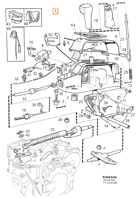

Not the parking pawl (that's in the gearbox), the detent (which is in the passenger compartment). I've never repaired one, you might want to get a junkyard shifter assembly and swap the whole thing. Otherwise, hopefully this parts diagram will help you diagnose the problem...my guess is that you'll find part #24 broken.

Yes, I think you're right. Part #24 is actually totally missing because I can lift #23 right out of the shifter and there is nothing going through the slot where I see #24 is supposed to be. Maybe if I open up the passenger compartment housing I will find it there, or in the worst case, yes I can get a junkyard one from somewhere.
