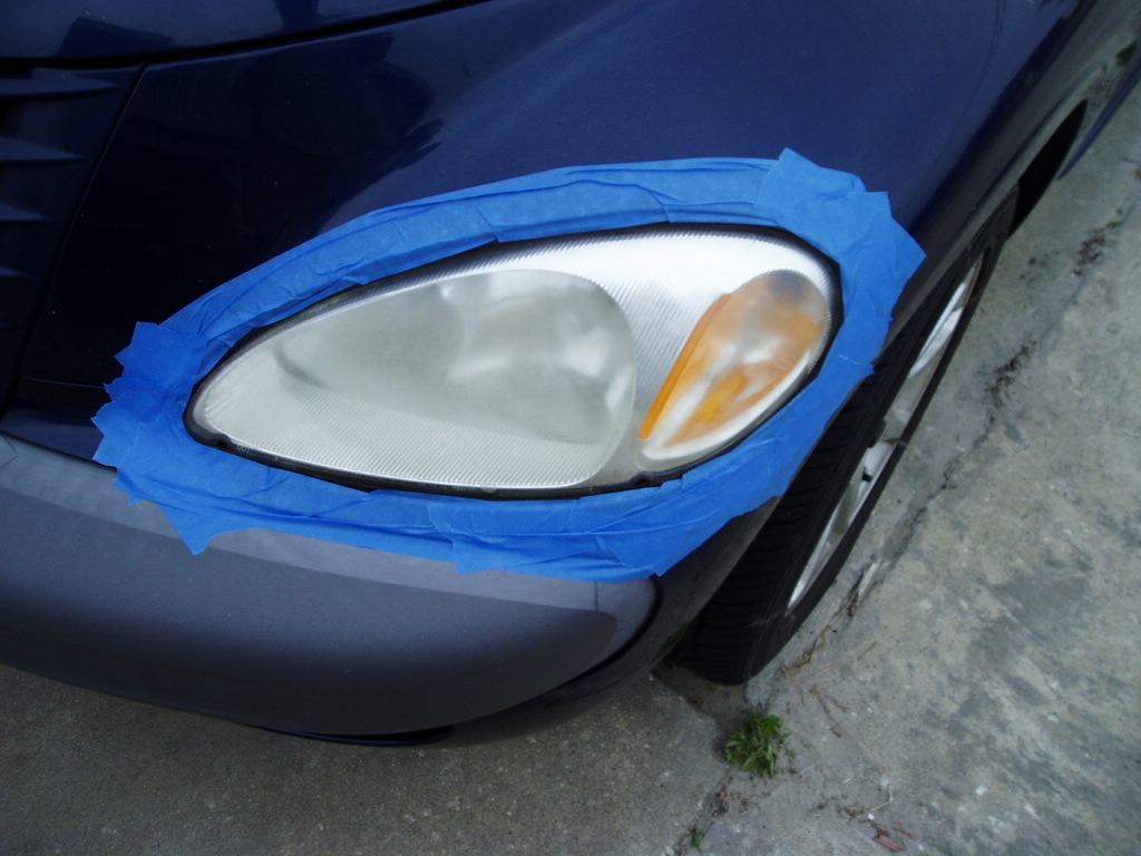

Here's a "before" pic of one of the headlights that has turned cloudy (presumably from UV from the sun):

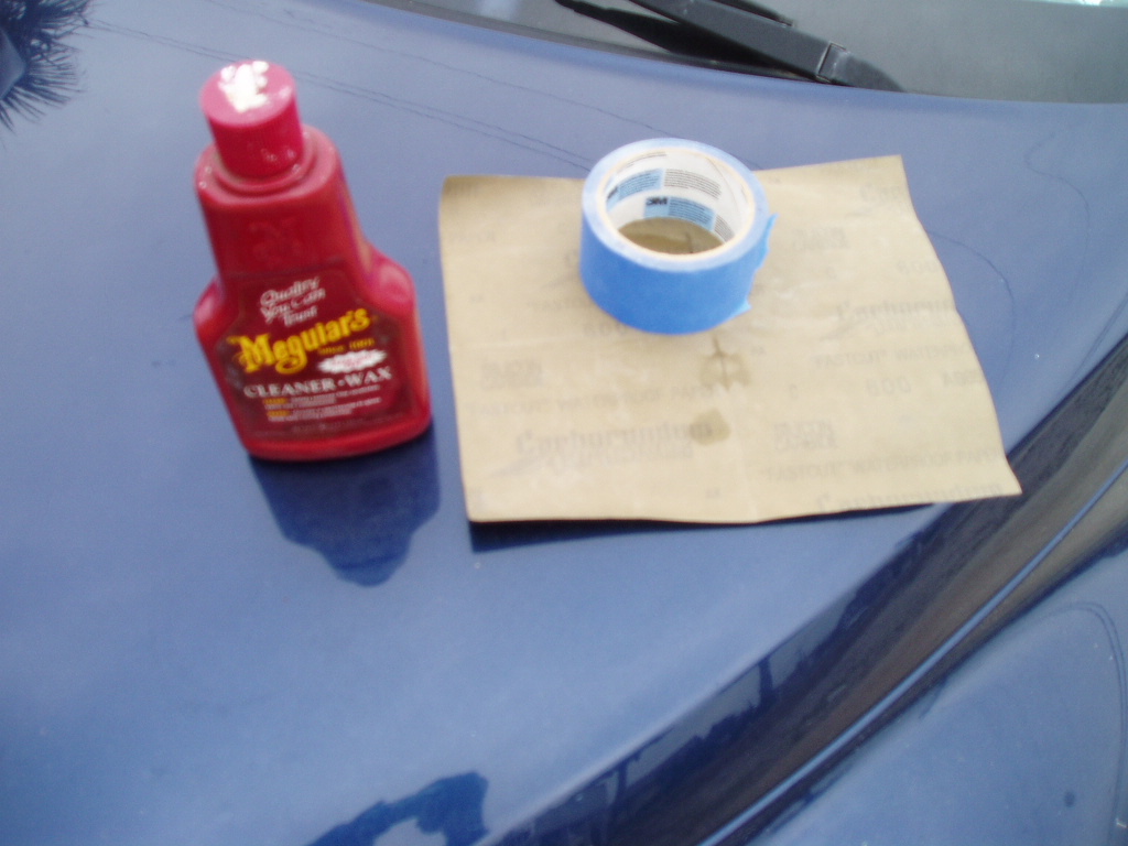

Here are the materials I used (3M 600 grit wet-or-dry sandpaper, blue masking tape, and Maguiar's Cleaner/Wax):

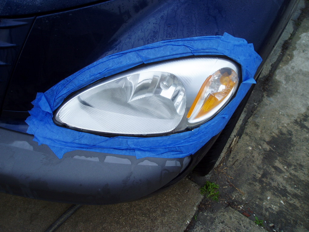

Start by taping off any surrounding paint so you don't scratch it:

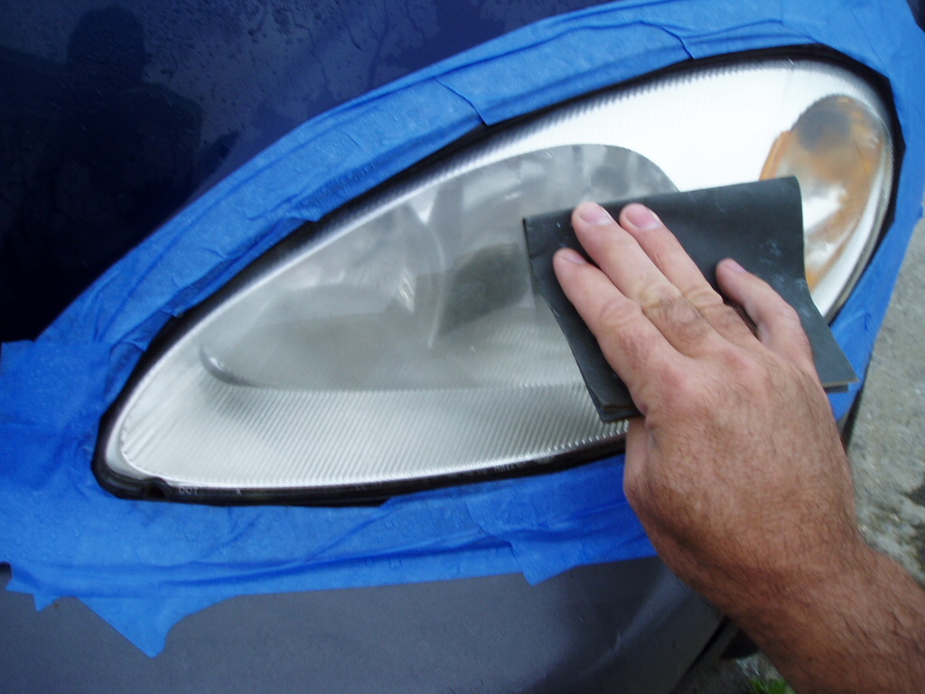

Turn on the hose so you have a slow flow and direct it over the light while you gently sand the surface with the sandpaper. Alternatively, dip the sandpaper in the water bucket periodically while sanding to maintain a film of water on the headlight surface. This keeps the sandpaper from loading up with debris:

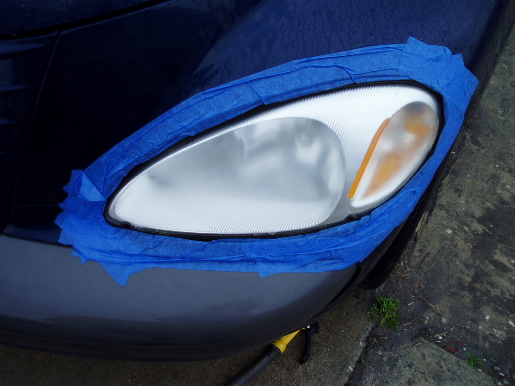

This is what the light will look like after sanding:

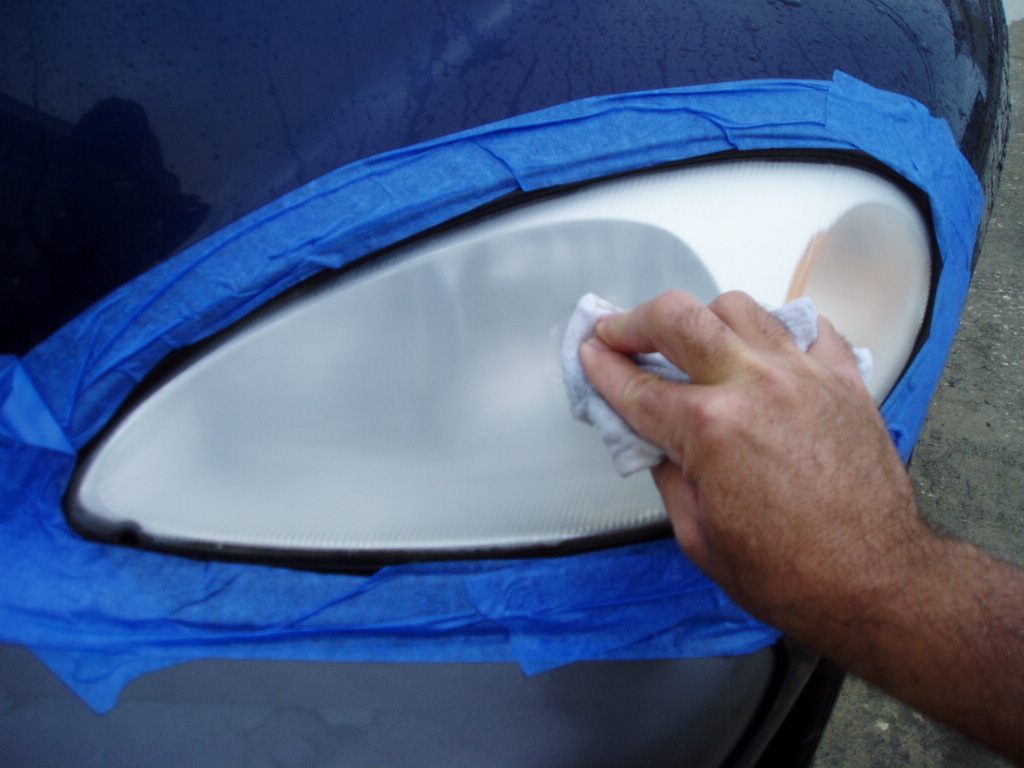

Apply a small amount of the cleaner/wax to your cloth and polish a small area of the light:
Continue until the entire light has been polished:
