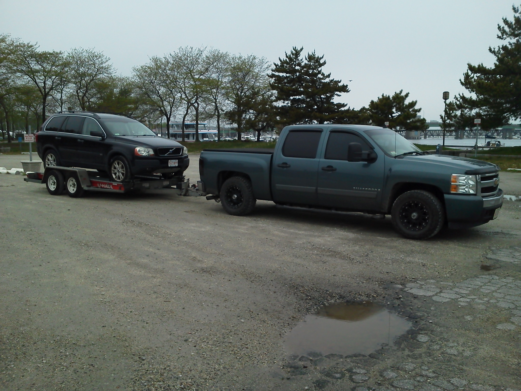

My wife and I have decided to sell the XC90 as-is with the slipping transmission. The mechanic who we sent the car to gave us an offer, and, though it was less than we wanted to get for the car, we decided it was time to part ways with the Volvo.

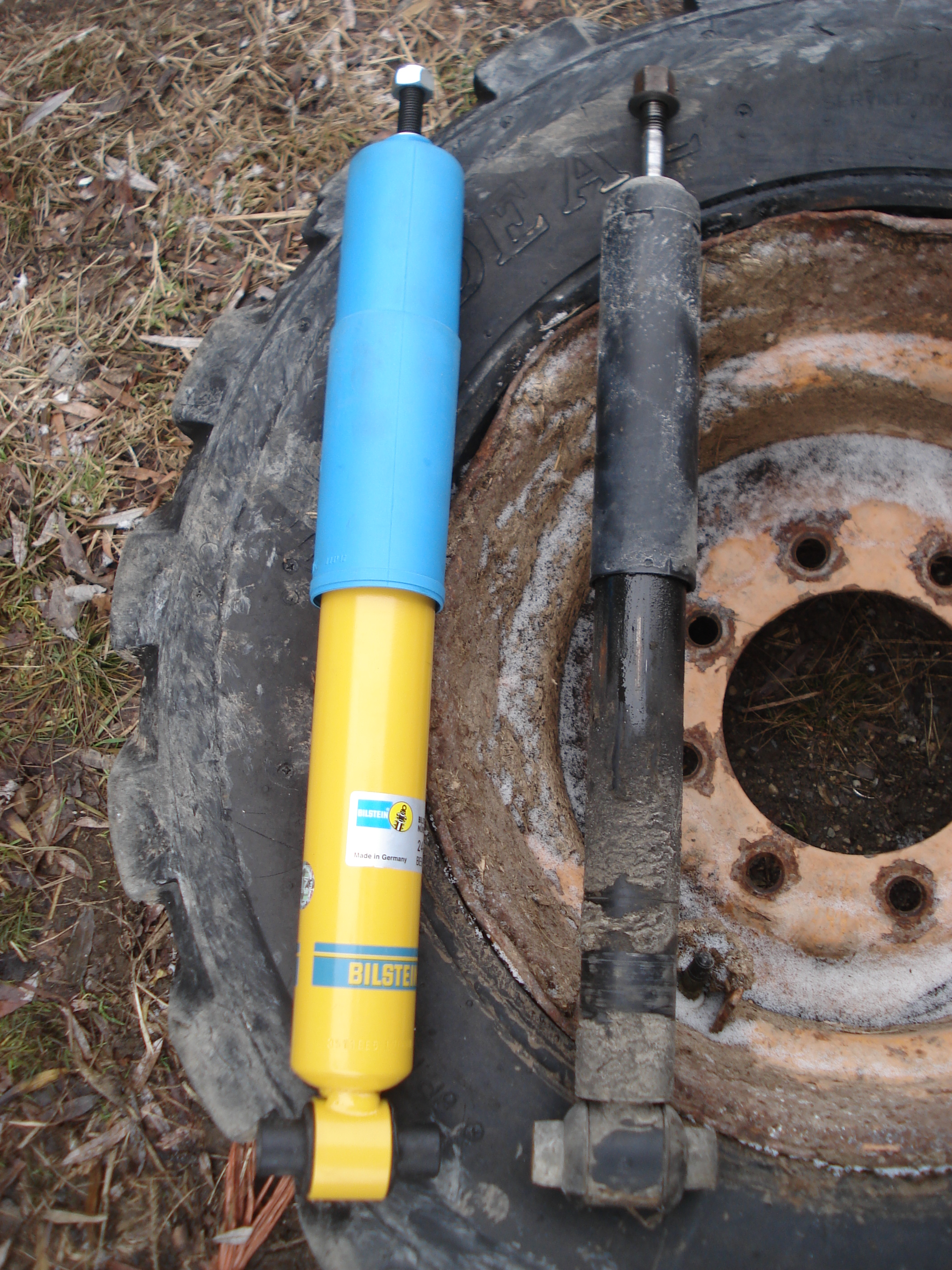

December 26, 2012, new shocks:

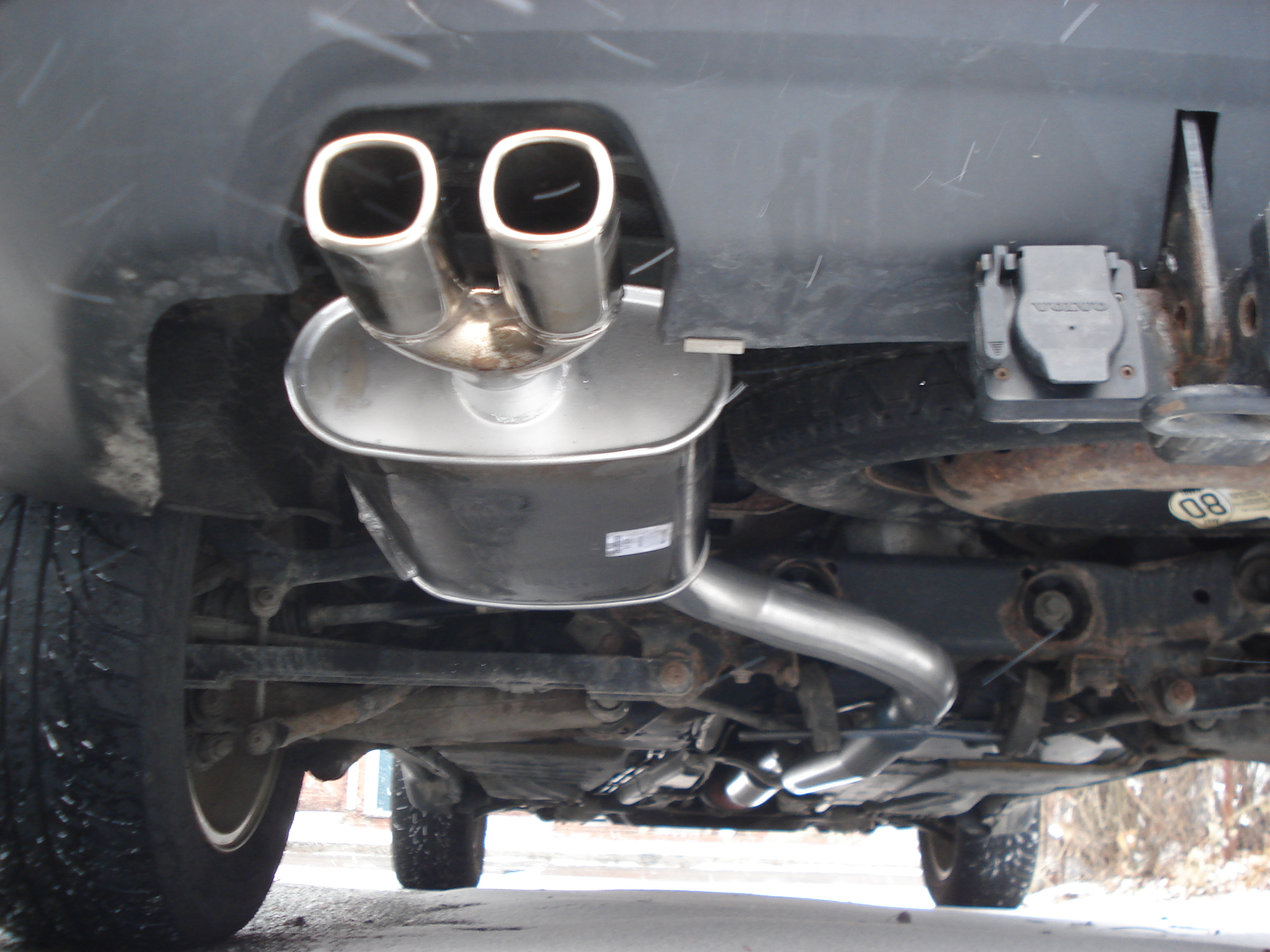

Here’s an update. In order to pass the MA state inpection this past week, I finally needed to address the exhaust. i had Lou’s Custom Exhaust in Portsmouth, NH fabricate a custom cat-back exhaust with a dual square tip for the euro-look. I am really happy with it and it has a bit more of a throaty sound when you get on the gas, and is quiet at idle without any drone.
