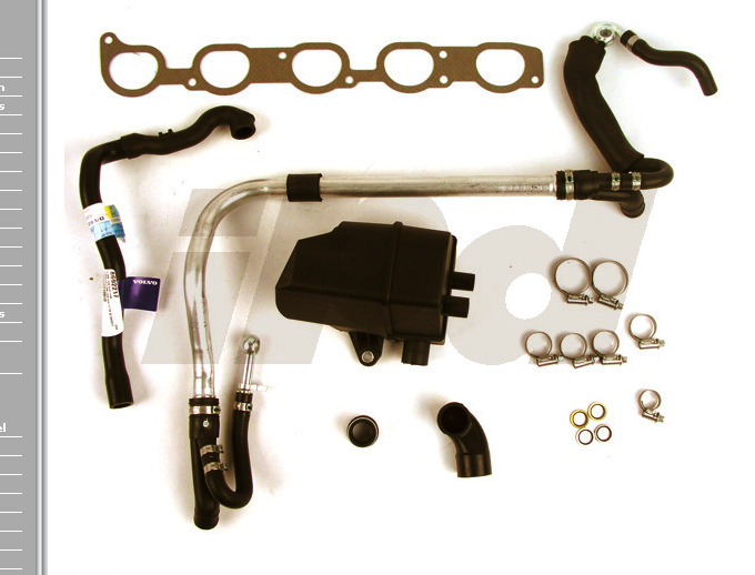

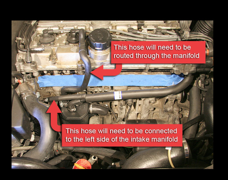

3) I changed my plugs and noticed a small amount of oil in some of the casting cavities toward the back of the head. It looks like the source is the rectangular section of a hose (I assume it's PCV related) that runs out under the plug/coil pack cover and down through the intake mold runners. It's broken. I've attached a couple of photos to help clarify which one it is. One photo is from an IPD catalogue and shows an IPD PCV replacement kit. The hose in my car that is broken is the left most in the image under the intake manifold gasket. In the second photo (although this is an image from an 850 engine bay), the hose is the one pointed at by the upper caption.
