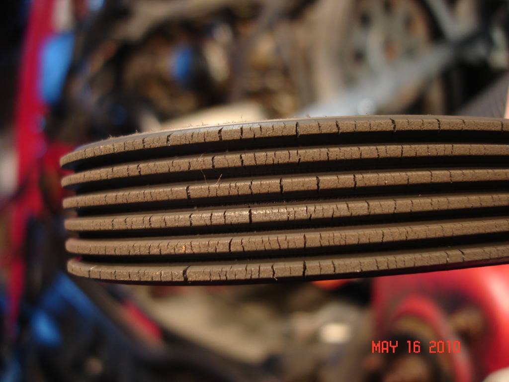

My serpentine belt (BELOW) looks like another bullet...

You have to change your belt, water pump (is near to fail), and review your auxiliary idler, ( try with wheel bearing grease), and move with your hand, if it feel better you can try putting again on the car..
