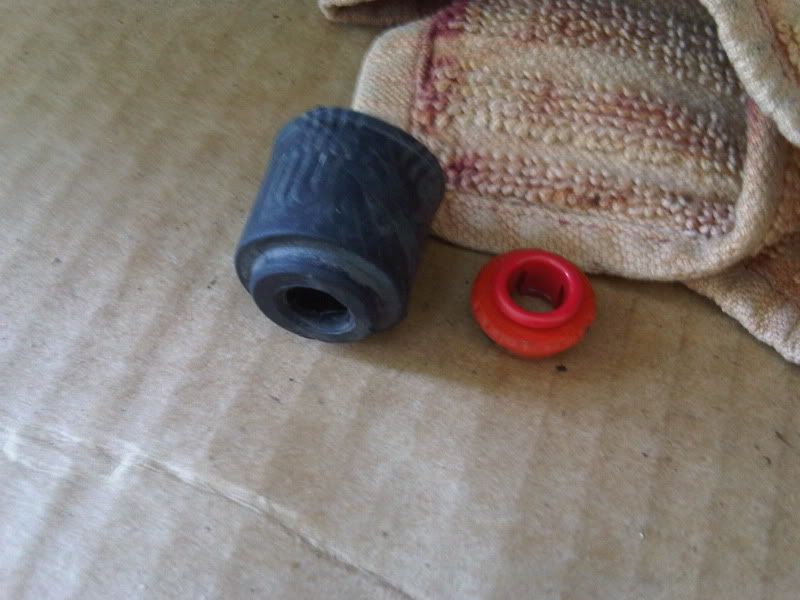

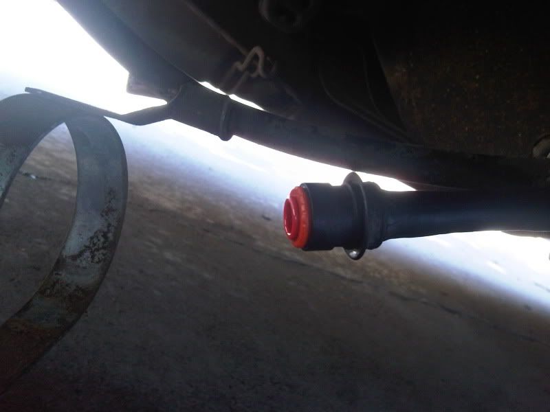

While replacing the fuel filter, I am having a rough time installing the new one without leaks.
Perhaps during the course of removal, there was damage to the little orange lock ring that slides onto the filter?
This orange ring has remained on the "outlet" side of the line connection, but was dislodged and has now fallen out of the 'inlet' side.
Is there sealant that keeps this orange ring in place?
Here are some pics that help show my little issue here.
1. Outlet with Orange Ring in Place.
2. Inlet with removed Orange Ring
3. Orange Ring Removed with Protective "Boot" (As I will call it. :) )

same happend to me after a filter change the locking mechanism wasnt holding on or sealing..
had to buy the gas line from filter to engine.... but at least i wasnt a hard job, and part wasnt that expensive i tend not to gamble on gas issues
dealer told me t'was way to go
maybe someone else has other ideas
best of luck

Also - Do you think that one could use an adhesive to glue / super glue that orange O-ring back into place to fix this issue...? Just a thought.

Don't ever fool around with gas line.
Get new gas line!
Also, does anyone know if the O-ring or the Orange thingy is sold separately?

i bought the gas line directly from the volvo dealer this line has also a pulse something device thats on that line
if i remember its was about $70 to $ 80 cheap insurance
dealer told me no the line comes as a whole no repair kit or parts just for the o rings, prior to buying new i tried to mend it but it just would not hold. tried a worm clamp and if you pull too much to the rear the line might partialy disconnect from that pulse device thing and you will get leaks close to the cat way toooo dangerous
lesson learned get it from dealer its plug and play and no bad surprises and safe
i would not gamble on gas issues this line is too close to very hot parts such as the muffler an catalyc converter

Okey Dokey. Thanks for the advice. Looks like I'll be going over to the Volvo dealer. Can't seem to find the gas line online anywhere. Thanks again!

As far as I'm aware you cannot buy the orange part, or not in the UK At least Volvos system doesn't list it just the entire pipe. When I damaged the fuel line on my previous 850 from miss understanding the instructions on how to change the filter I replaced the entire pipe with 1/8th or 3/16th 12bar fuel line with a pair of nickle screw up clips cost less than £8, pipe from Volvo is around £80.
