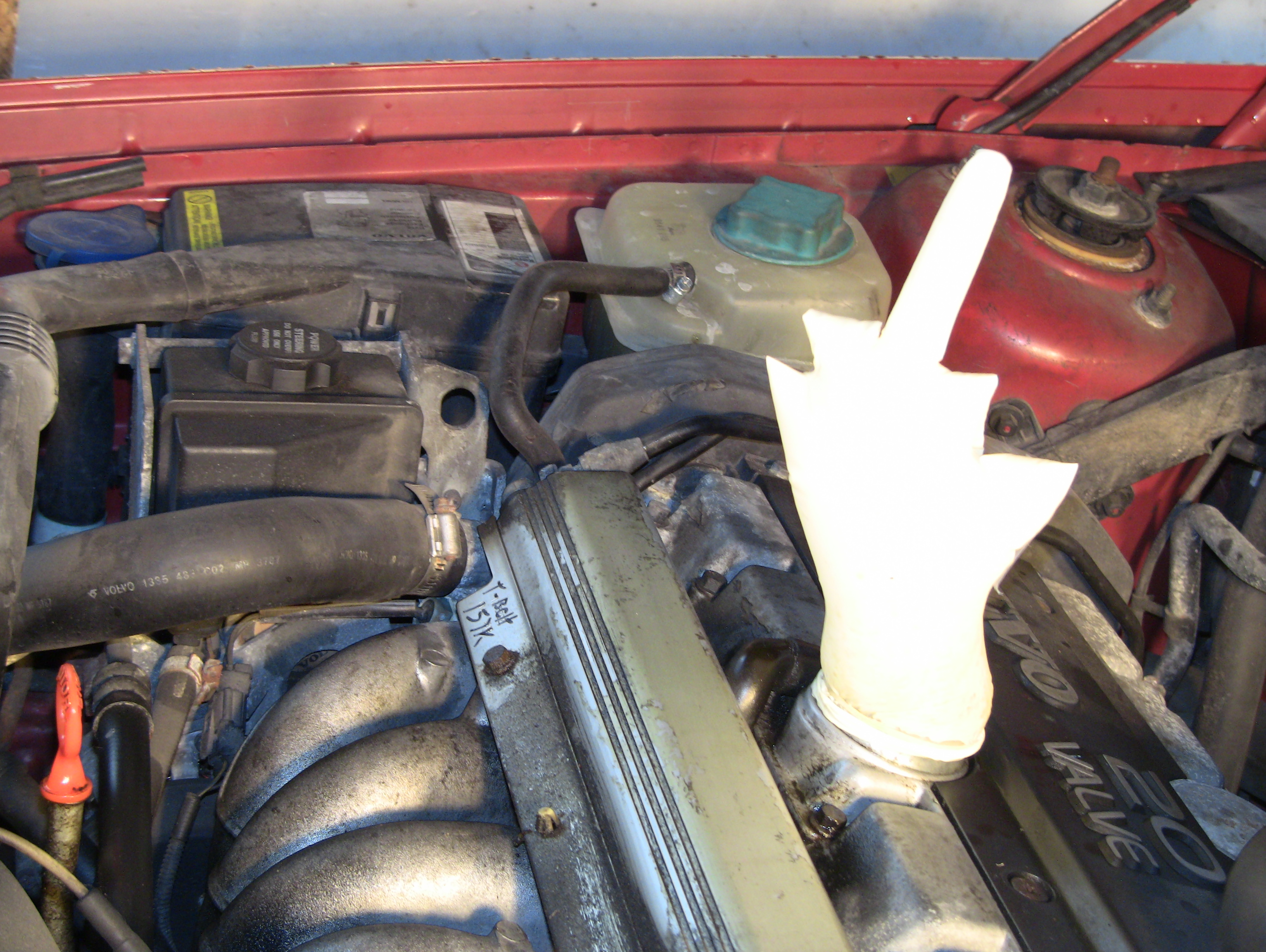

I played around with my PCV system today.
I hooked a vacuum to the exhaust hose that goes from the oil separator to the PCT valve.
I was able to feel the vacuum at the oil dipstick tube and at the vent on top of the engine.
I believe there are no obstructions in my PCV system but I am not able to check the vent
under the intake manifold to the right of the oil separator.

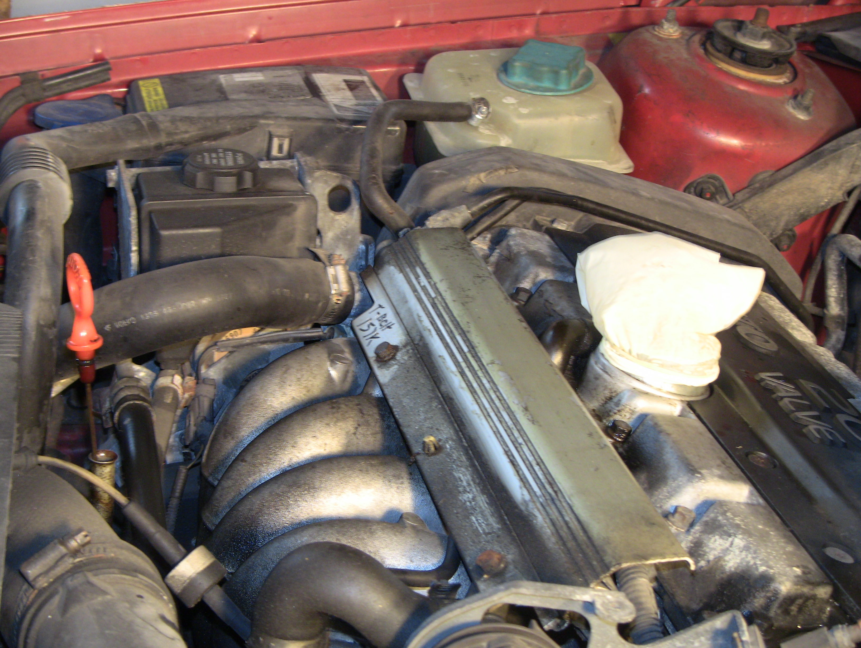

I tried attaching a balloon to the oil dipstick tube. Some exhaust went into the balloon but
there was NOT enough pressure to make the balloon rise. I believe this means that my recently
cleaned PCT valve is helping to reduce pressure buildup in the engine.
Correct me if I'm wrong, but the balloon should stand up if there is significant pressure, right?
I did increase the size of the PCT valve exhaust hole by about 1/16". I did not see a reduction
in exhaust from the oil dipstick.
I will try to increase the hole a little more the next time I have it out. I suspect the gases are to voluminous
for the PCV system to eliminate. This may be because of more blow by or bad rings.
I think I'm going to hold off on installing the PCV kit right now. I need to determine where the white
smoke in my exhaust is coming from. I did check my plugs and my plugs and pistons were covered
in carbon. I may try to Seafoam my engine next.

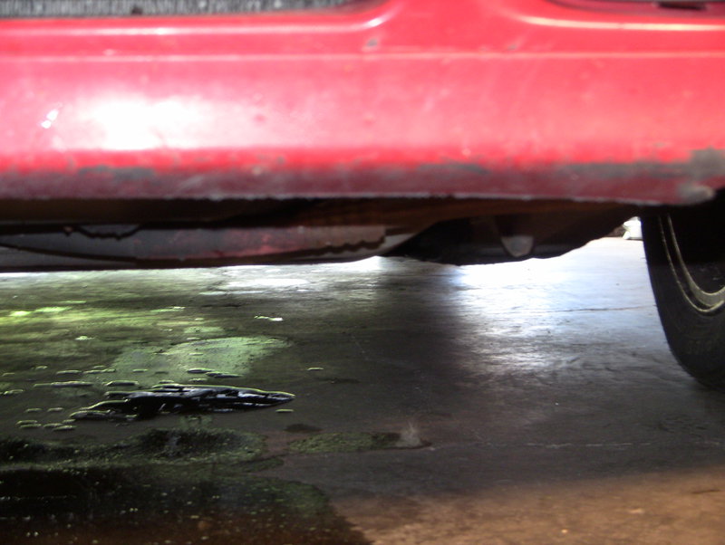

I checked the PTC valve and it was blocked solid. The tiny vacuum line to the intake manifold was blocked solid and broken off. Where it broke off was completely solid with gunk. The large hose to breather box broke off just inside the thick insulation near the PTC valve. It was not blocked. Only the PTC was blocked solid.
One question I have is why are materials that don't hold up to heat/oil used for the critical PCV system. I believe the Volvo OEM parts eventually get brittle and fall apart too. Metal lines seem like they would last forever and you could simply clean them every 60K miles.
I'm coming to the conclusion that a clogged (under appreciated) PTC valve has the potential for causing a massive amount of damage to our vehicles. If the rest of the breather system is fine a clogged PTC can blow out any number of seals causing serious amounts of repairs costs.
To think a clogged opening the size of a pencil eraser can result in blowing out the rear main seal is impressive!!
I'll stick to PTC issues here and plan to research this a bunch more before I write some differing opinions of the PCV and PTC recommendations on this site.
Update: I stopped by Dave's in Ithaca and he replaced the rear cam exhaust seal. I lucked out big time on this one.
