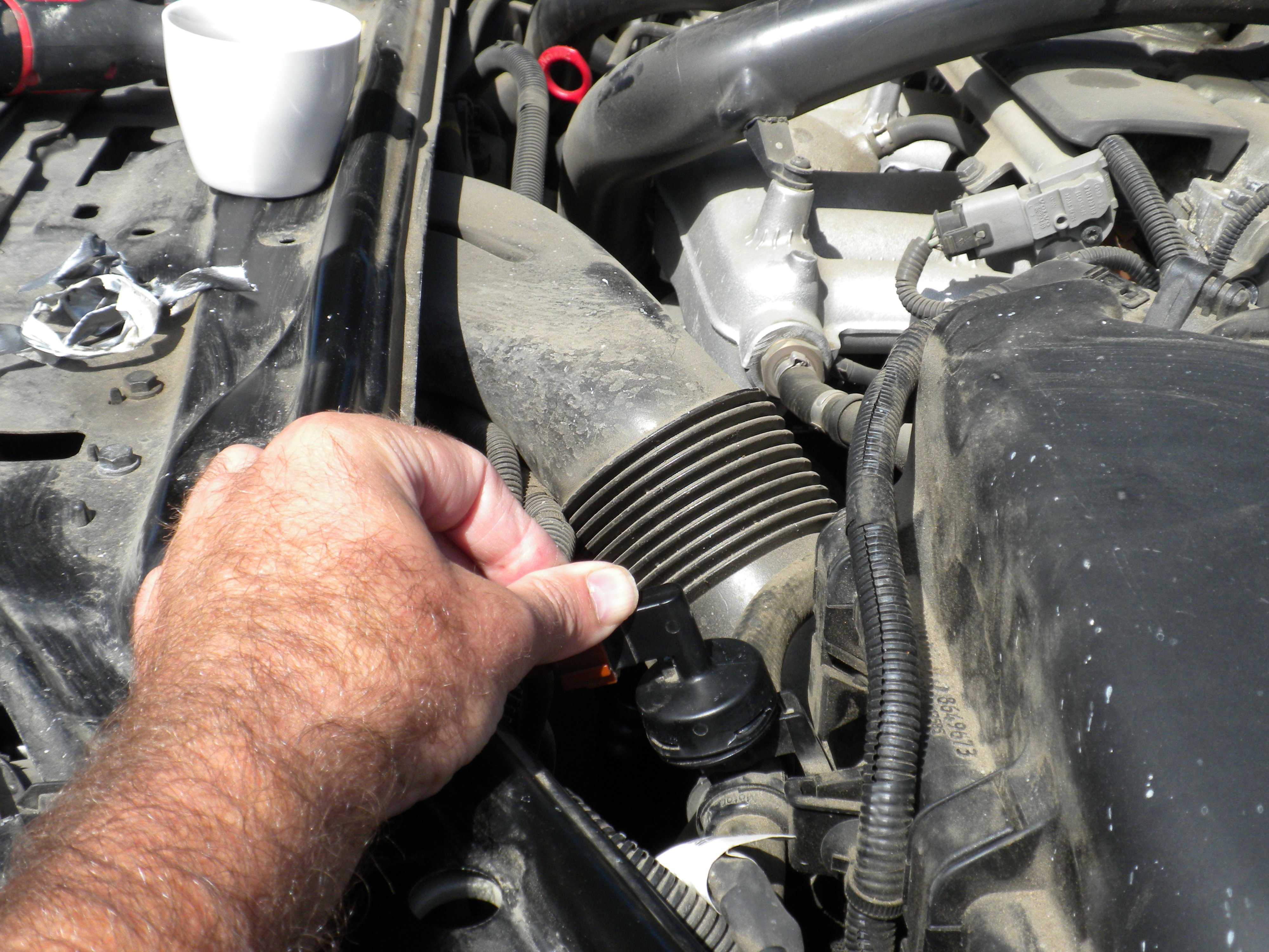

Help ! I seemed to have cracked some sort of gizmo (PCV valve ?) that is in front of my air filter compartment when I was changing the filter. I've got a few pictures of it if you want me to send them along. It basically is a valve, switch or sensor of some sort. As you face the car looking at the air filter compartment - the gizmo is between the filter and the chassis. It has two tubes into it and some wire running out of it. It apparently can twist open, revealing a long spring and a diagraphm. It wont lock when I try to twist it closed - the plastic broke. I've got duct tape holding it together now.
What is it ? Where can I get another one ? Will my duct tape work until I can get a new one ?
This is the gizmo in question.

Not a PCV valve.
I will get you the proper name for it later and post back

A bit hard to tell, but it seems like the aux. vacuum switch is what you broke.
That turns on the aux. vacuum pump
You know that little bzzzst when the car is turned on.
It's a Volvo part so you're going to have to order it from somewhere
