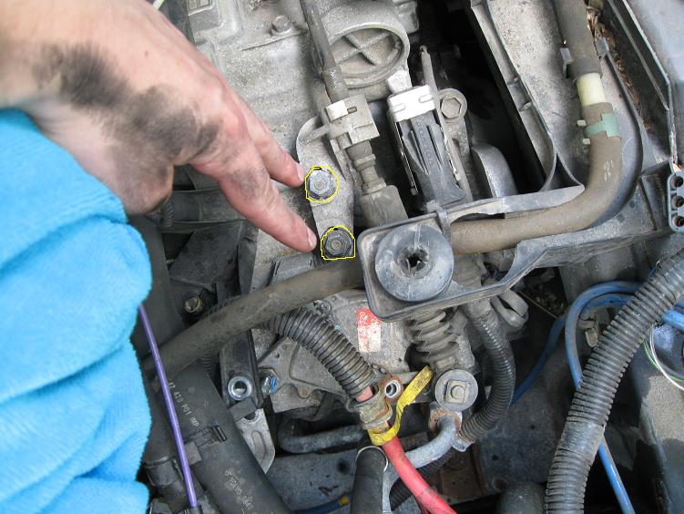

I'm thinking there may have been some serious damage done here. Take a look at the engine bay end of the shift cable and see if seem loose or if it is still tight.
To the right of those 2 bolts is the cable
This write up shoes you how to get to the cable -> https://www.matthewsvolvosite.com/forums ... =1&t=29930
