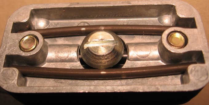

These are Roof mounted with a safety breakaway. A pretty good idea from these Volvo guys.
You may be able to remove the plastic cover with the map lights in it and pop it back into it's mount.
It looks like this inside:
Mirror spring mount.jpg (45.43 KiB) Viewed 12872 times
But, it's probably gonna be a real pain to replace while the mount is installed.
Those spings are pretty tight and it's not an easy reach for applying pressure.
You may have to resort to removing the mount, taking the cone-headed
screw out and putting it back together that way. Best of Luck! :wink:

I followed these steps and removed the mount, but I can't get the springs back in. Are there any tricks to this?
thanks
