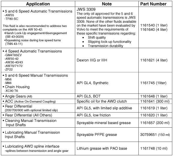

With proper friction modifiers certain ATF's can be made to perform within JWS3309 spec.
From what you have said the ATF used was not JWS3309 spec.
I included you owners manual and the Volvo spec sheet for reference.
If the repairer can not show that the oil is performing at JWS3309 spec they should replace it with the proper oil. In your case the proper ATF is JWS3309. If you have the option between a synthetic and non synthetic JWS3309 oil I would recommend the synthetic.
