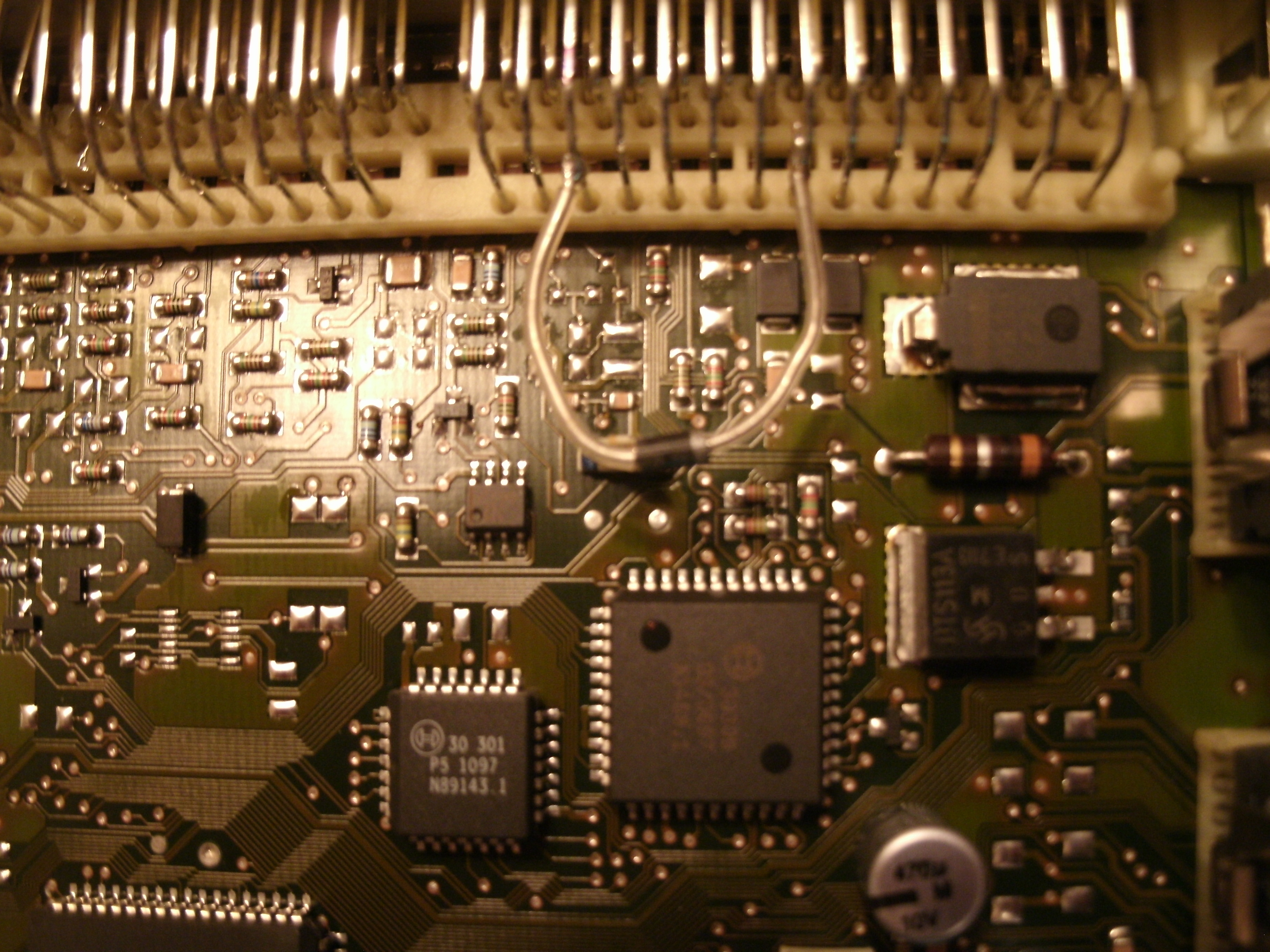

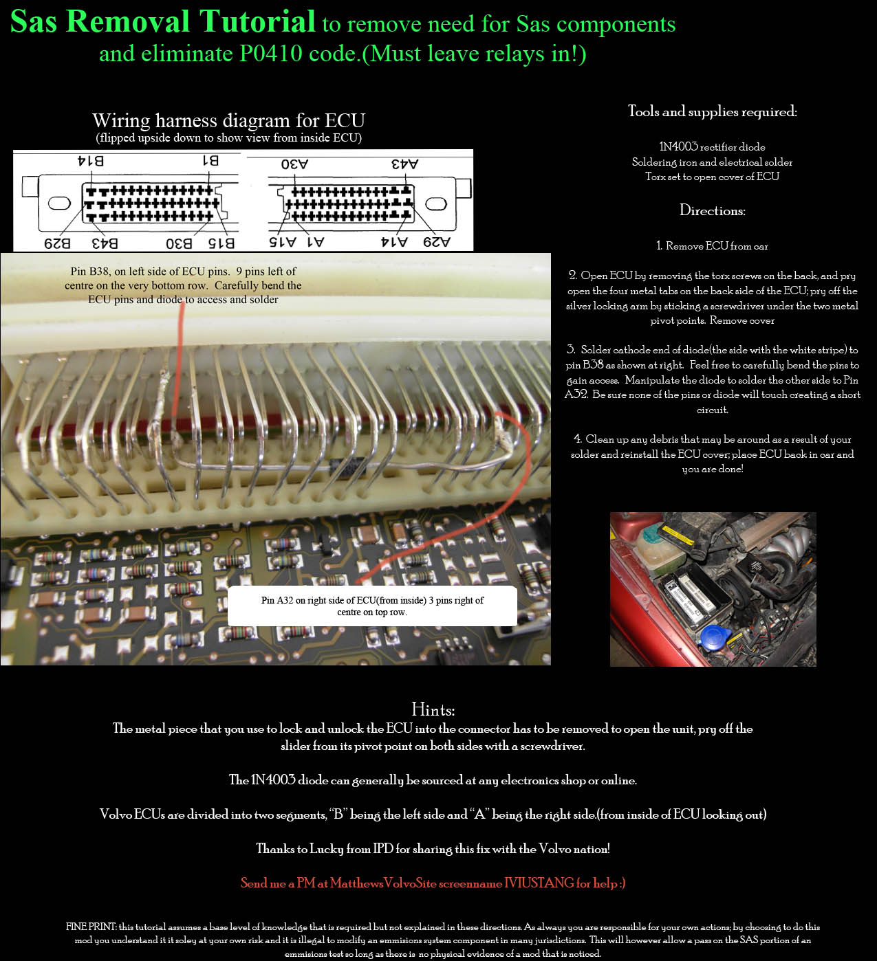

Here you are people after a bit of revision and suggestions from people this is my latest version of the how to.
- Jesse
EDIT Groupthink here at MVS and Volvospeed points to A32-37, not A32-B38! The image directly below is incorrect in this regard.
A32-A37, not A32-B38!
Moderator Edit:
Albeit a bit blurry, this is correct.

Does this mean that the check engine (DTC P0410) re: SAS prob. will no longer appear once this procedure is done? Currently I
have this DTC on my car. I replaced the SAS valve 2 yrs. ago so could it be bad again. Checked all the vac hoses and found no
cracks or disconnected tubes. Will do more test then report back here.

Yes, this does get rid of the P0410 code completely.

Well I just finished as we speak... so far it looks like i did it right. first time ever soldering too! anyways Radio shack has never heard of the 1n4003 but they had plenty of IN4003 which as 99cents U.S for two! so i am going to go out and install the ECU and pray it runs! :?

Check engine light came on after 2 days. Had the codes read and found the SAS fault code. So this is not working for me. Any suggestions?

I did not look super carefully through everything in the linked pdf, but does it say to use pins A32 and B38? If so, there is the problem - those are the wrong pins.
SAS delete requires pins A32 and A37. Go to the source where this was figured out, the instructions are crystal clear on the two ways to do this right:
http://volvospeed.com/vs_forum/topic/14 ... with-pics/
