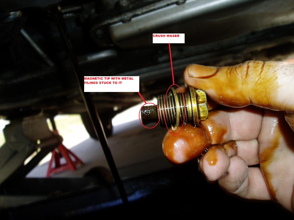

One more questionI just changed my oil and found a small amount of metal on the magnet just as in your picture. Is that normal or does it indicate a problem? I'm considering getting a compression testing kit since I have no idea about condition of the engine.
It's normal to have some metal on the magnet. I wouldn't worry about it.
