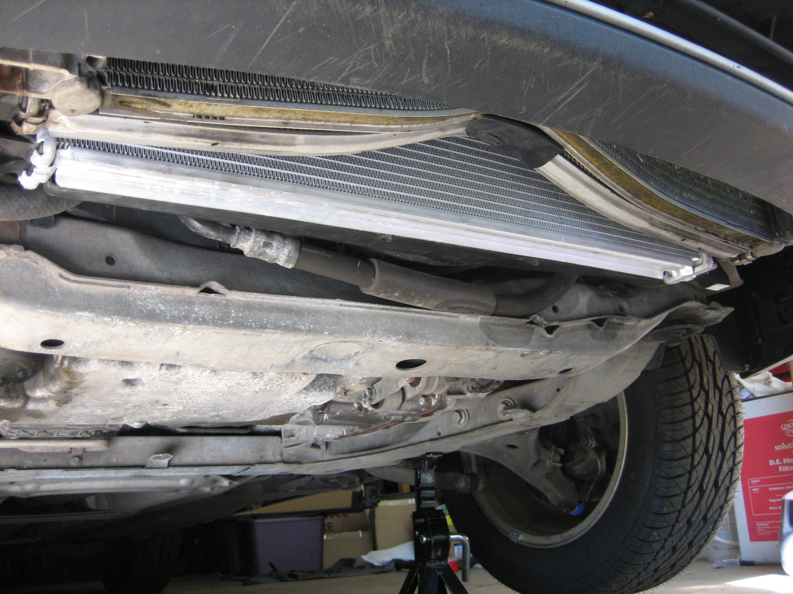

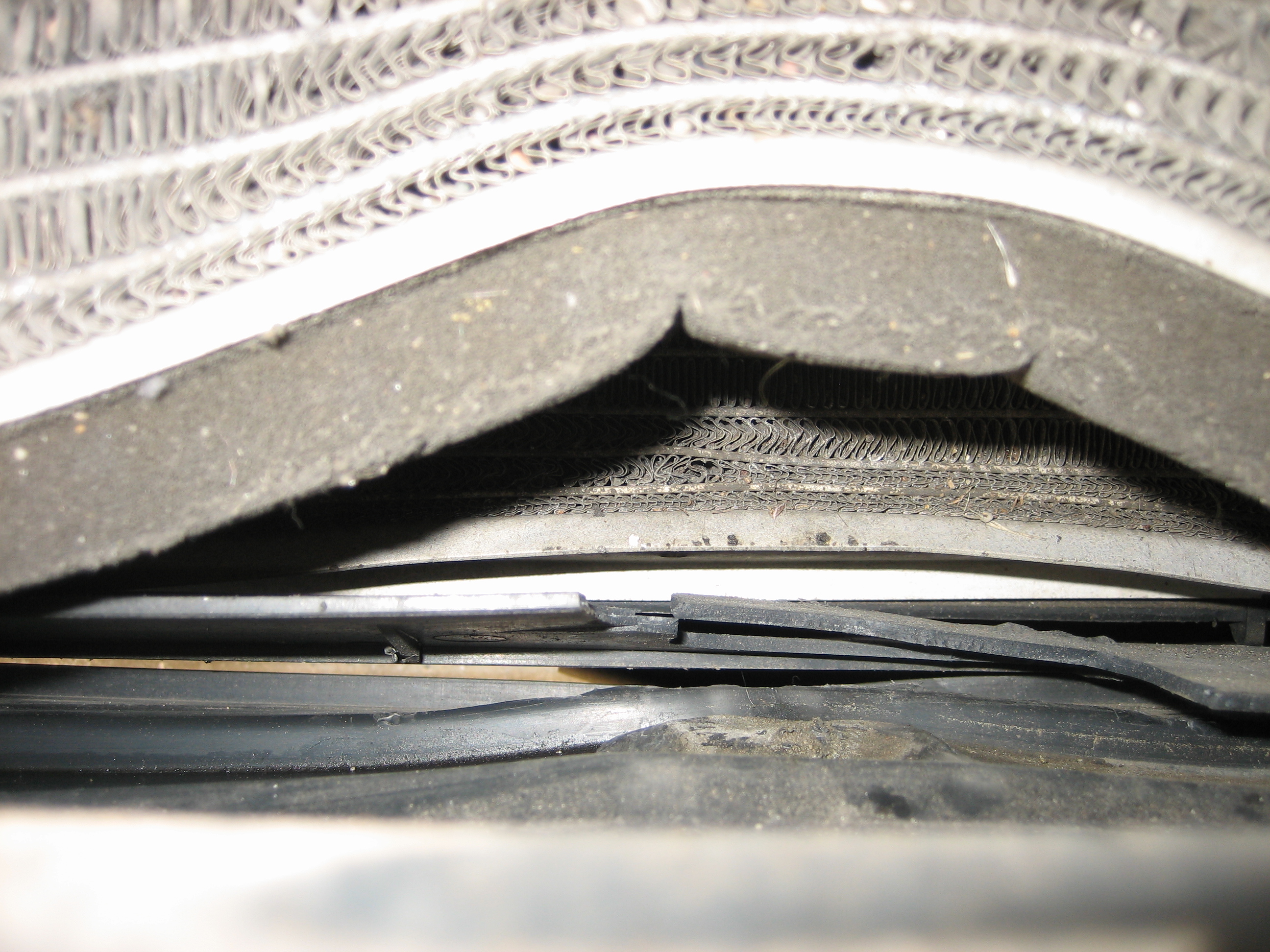

I wanted to relay a very embarrassing and expensive lesson learned. I was about to do brakes and suspension and the first jacking lift, which I've done dozens of times now, went badly. I used to jack up the car directly onto the engine sub-frame (right behind the radiator), but the subframe was starting to bend slightly where the jack was making contact. As a solution, I use a wooden plank that distributes the weight across the entire front portion of the sub-frame. This particular time, however, the jack did not roll towards the back of the car as I jacked it up. I don't know why the jack did not roll back, maybe a pebble behind the wheels on the jack... I just don't know. Since the parking brake locked the rear wheels (does anyone else do this?), the wooden plank rolled off the front end of the sub-frame just as the jack was at its highest position. The car came slamming down and the radiator assembly took the brunt of the car's weight on the fully raised jack. The condenser and intercooler bent more than the radiator, which I guess is stronger. No gushing fluids or catastrophic R-134 leaks – all the aluminum radiators bent without breaking. I finished the brakes and suspension jobs and the car still ran fine with the bent radiators. The right lower end of the radiator leaked a little more than it usually did (it always had a very small leak). I was afraid of an internal coolant to transmission fluid leak, so I used the car sparingly last week and decided to replace the radiator with a new Nissens. (FCP initially sent me a cheaper OEM radiator in error, but after I called customer service they overnighted the Nissens. Thanks, FCP!) I just completed the radiator replacement and am kicking myself for not doing the intercooler at the same time – I didn't realize you have to completely remove the intercooler to remove the radiator. I also did a transmission fluid flush just to be safe – it was only about 20k since the last one, but what the heck – it is easy to do and I have good piece of mind that there is no radiator fluid in my transmission.

Before the repair.
Before the repair.
After repair.  Still have to replace intercooler and condenser, but at least the car runs without fear of internal radiator leaks.
