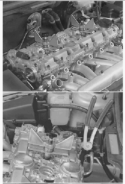

Vadis has 3 specialized tools needed to remove cylinder head.
Tool: 999-5452 timing gear puller
timing gear pulley.gif (49.85 KiB) Viewed 10891 times
999-5452 (x2) wing nut camcover puller
999-5670 pliers for removing cam cover.
cam cover removal.gif (94.78 KiB) Viewed 10892 times
Are these really necessary? Are there alterntives?

I did not need any tools replacing the timing belt, but the cam cover tool can be made using the came principal.
