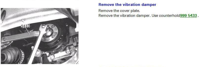

I hope you can post photos, it would be interesting...While I do not favor using the tool hole at all for removing the nut, I would think that to tighten the nut, you could rotate the shaft 360 degrees and contact the tool from the other direction...
My concern is about where on the crankshaft the tool establishes contact...Is it against a counterweight, which is probably OK, or is it against the crank-throw on the connecting rod bearing?...I would not like that, it could damage the bearing...In my mind I feel that Volvo did not intend this hole for holding the shaft while the nut is removed, I think that they meant it only as a location point for timing purposes...

Not sure if it will work for clockwise. I'll try it on the weekend. This is what we should be using to hold the crank. Part number is 9995433 It's in Vadis under Oil pump removal. Also I've included a photo of how the (incorrect) tool would be used and also a makeshift flat bar in the starter hole for preventing clockwise rotation:
