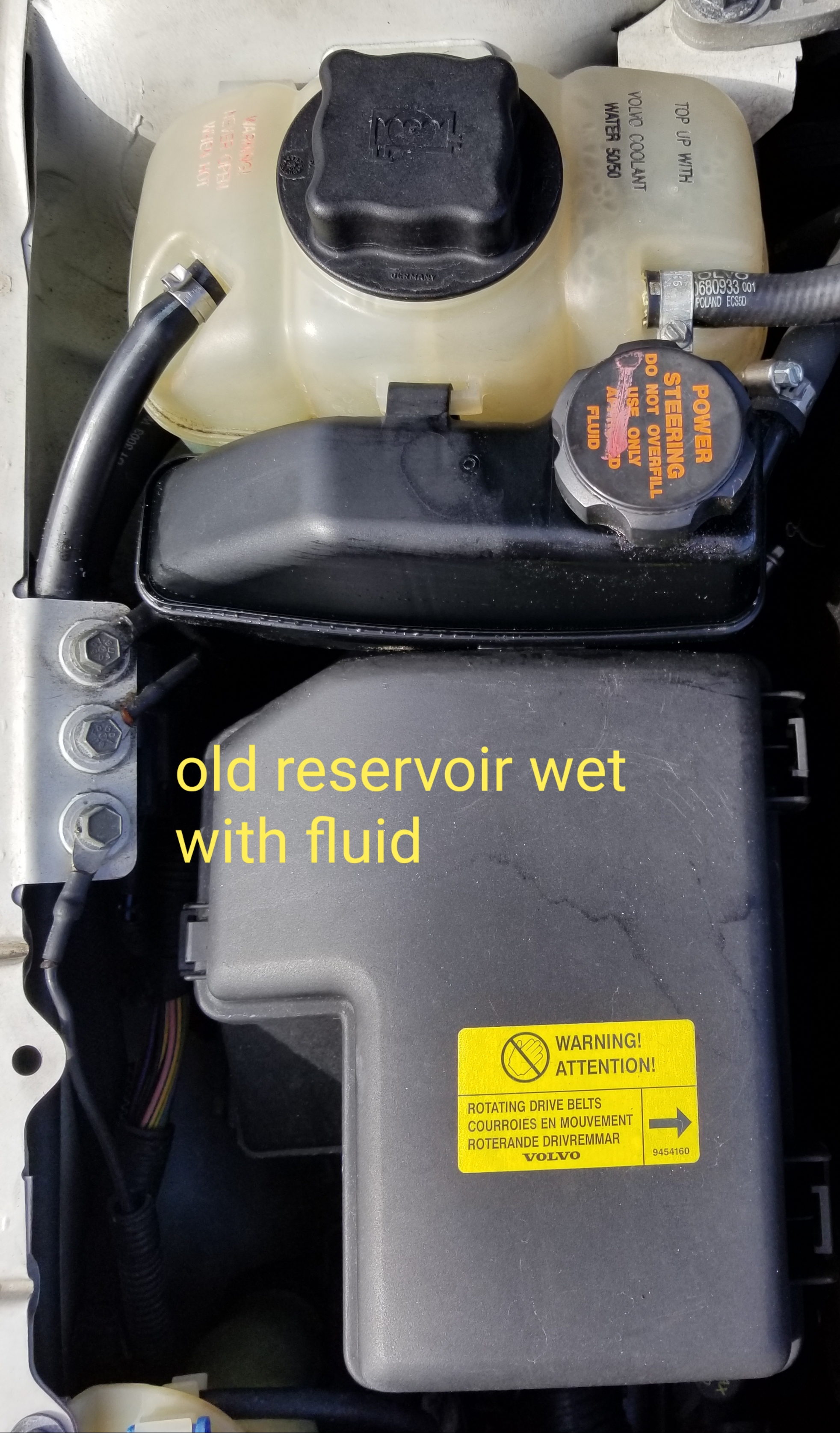

Be aware there is a part that breaks in the reservoir causing pump whine and fluid to push out the cap. My cap was leaking too on my 2004 and I had the dealer put a new reservoir on and suddenly all is fixed. No leaking out of the cap and no noisy pump. I posted a thread on here about it. Here is a photo of the old reservoir. The new one is still dry and the original pump is silent. June
