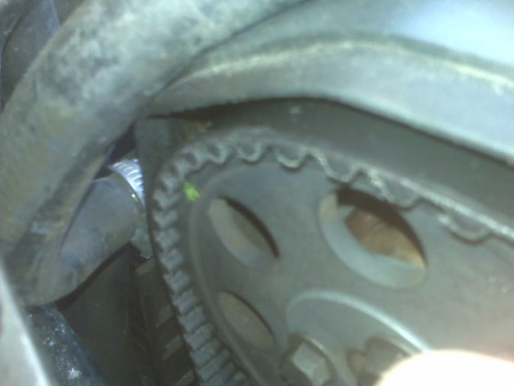

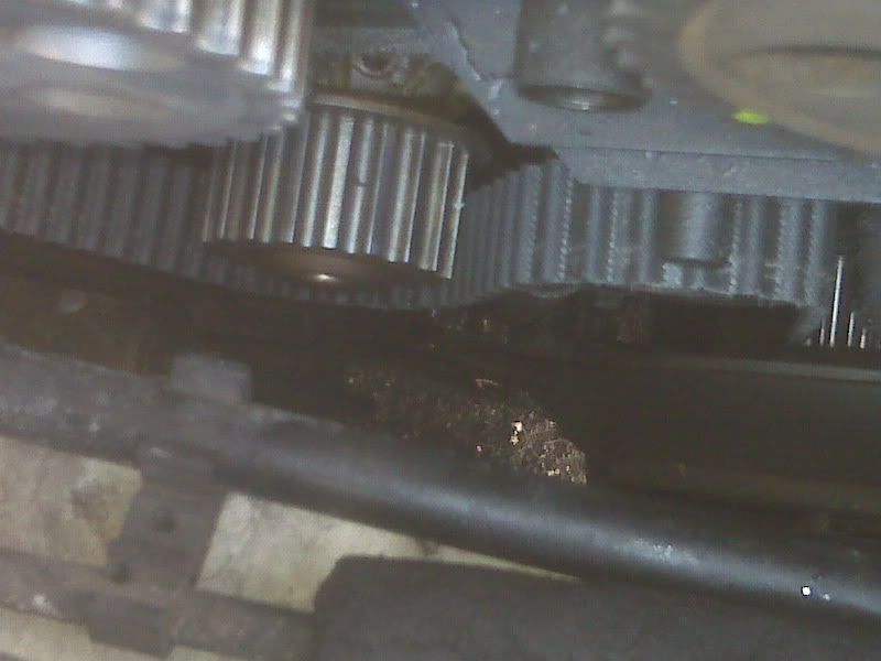

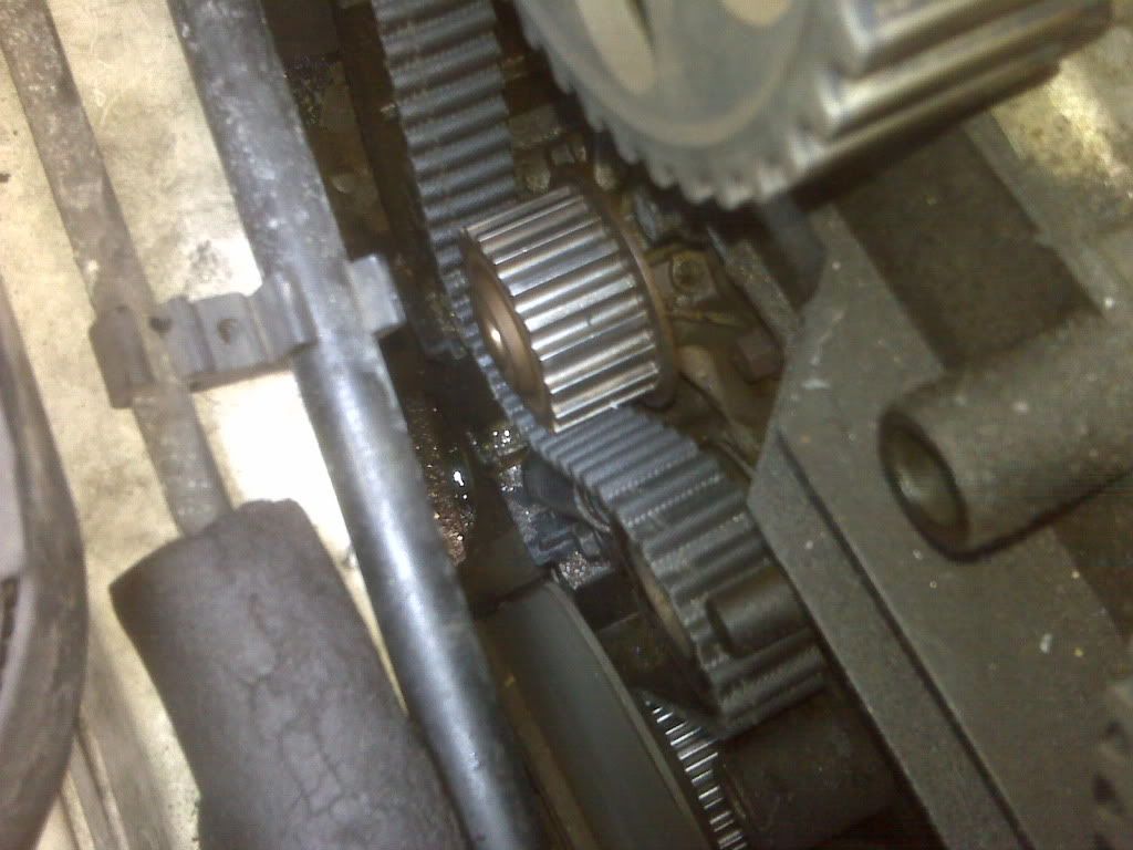

I got the belt cover off, and, while it's still hard to see down in there, I'm content (loosely speaking!) to surrender that this is probably the water pump. After getting the cover off, there's a slow, steady drip--as if the cover itself was helping to hold some of the fluid, which is probably true!
I took some pictures I wanted to show, because of some other bits of strangeness that may or may not be related:
The shiny blob to the right of center is where the drips are coming out. Based on what everyone has said, that's why I'm figuring it's the water pump.
Here's another good view of the drips. You can see the green pool on that lower cover...

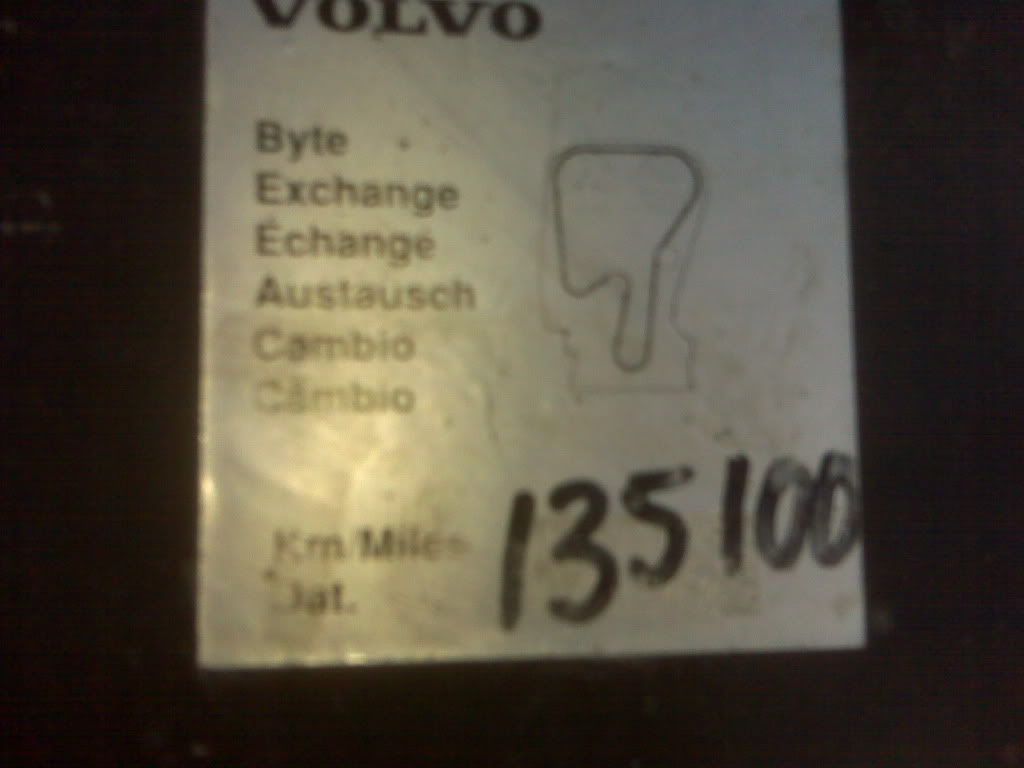

But here's the weird part: The sticker has, in Sharpie, 135,100 mi. as the last belt change, which is fine. BUT, beneath the Sharpie, in pen, it said "102,448" for miles, and "1/14/98" for the date. I can only assume that the belt was changed at 102k, then again at 135k? The belt looks pretty fresh, not that I'm an expert; but it's not frayed or raggedy-looking.

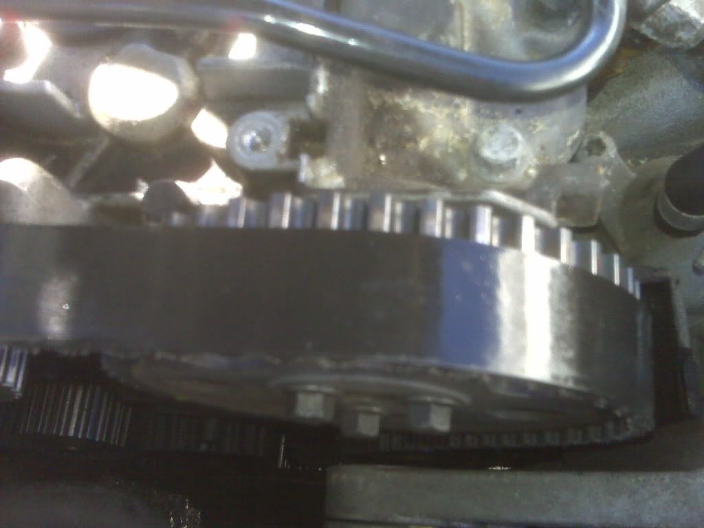

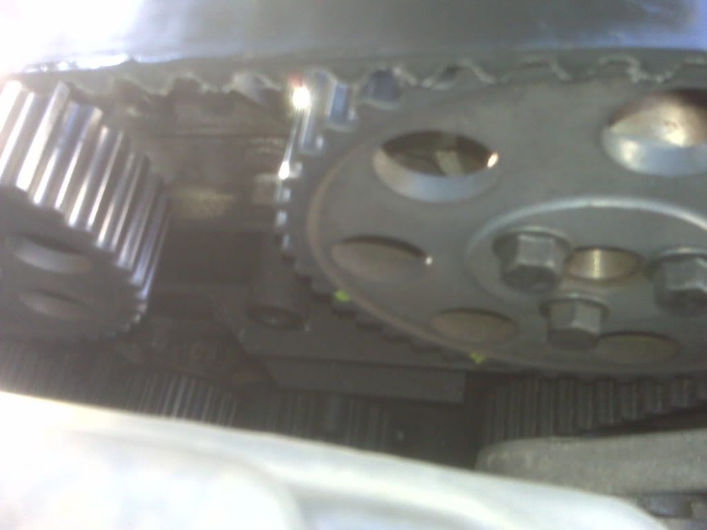

Here's a timing mark someone made on the left-side timing gear...
...and here's one on the right-side gear, EXCEPT that there are TWO marks; someone goofed up the first time? Don't know... That's why I'm here seeking opinions... :lol:
But here's what bugged me: See how far off the mechanisms the belt looks to be? Is that right? I mean, granted, there are bigger fish to fry here, perhaps, but is this how it's supposed to look?

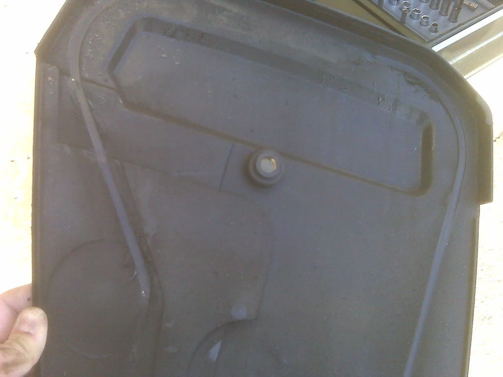

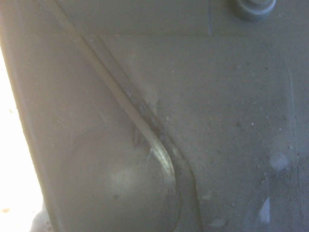

Here's a picture of what I can only call "scoring" on my timing belt cover, which, I assume, was caused by the side of the belt rubbing up against the plastic.
...and one more shot of that.
The mileage now is about 151k, so if the belt was changed out at 135k, is buying a new belt (and rollers and stuff) necessary? And how about that protrusion of the belt? It's not coming off of the rollers; it just looks like it wasn't pushed all the way in. If I do end up taking it to someone, I can point that out, I guess...

you need to get your belt changed too! the leaking coolant has probably got onto your belt and is making it slip off the gears. the 1993 has a different size TBelt which is wider than the older ones so make sure you or your mechanic get the right parts. check to see if the belt feels loose. it should be very tight. your lucky you noticed the leak and took a look before that belt slipped off. you would be shopping for a new motor if it did. I think you should get the whole system replaced to be safe. (belt, tensioner and pulley, idler pulley, and WP)

You need to address the belt immediately. I had one that didn't track correctly as well and it was due to a bad (I'm convinced it was counterfeit) INA tensioner roller. I replaced that roller with a genuine blue box Volvo part and the belt tracked properly after that.
From your picture the belt is in the process of destroying itself and, as you know, if the belt fails it is "Game Over" for that engine.
