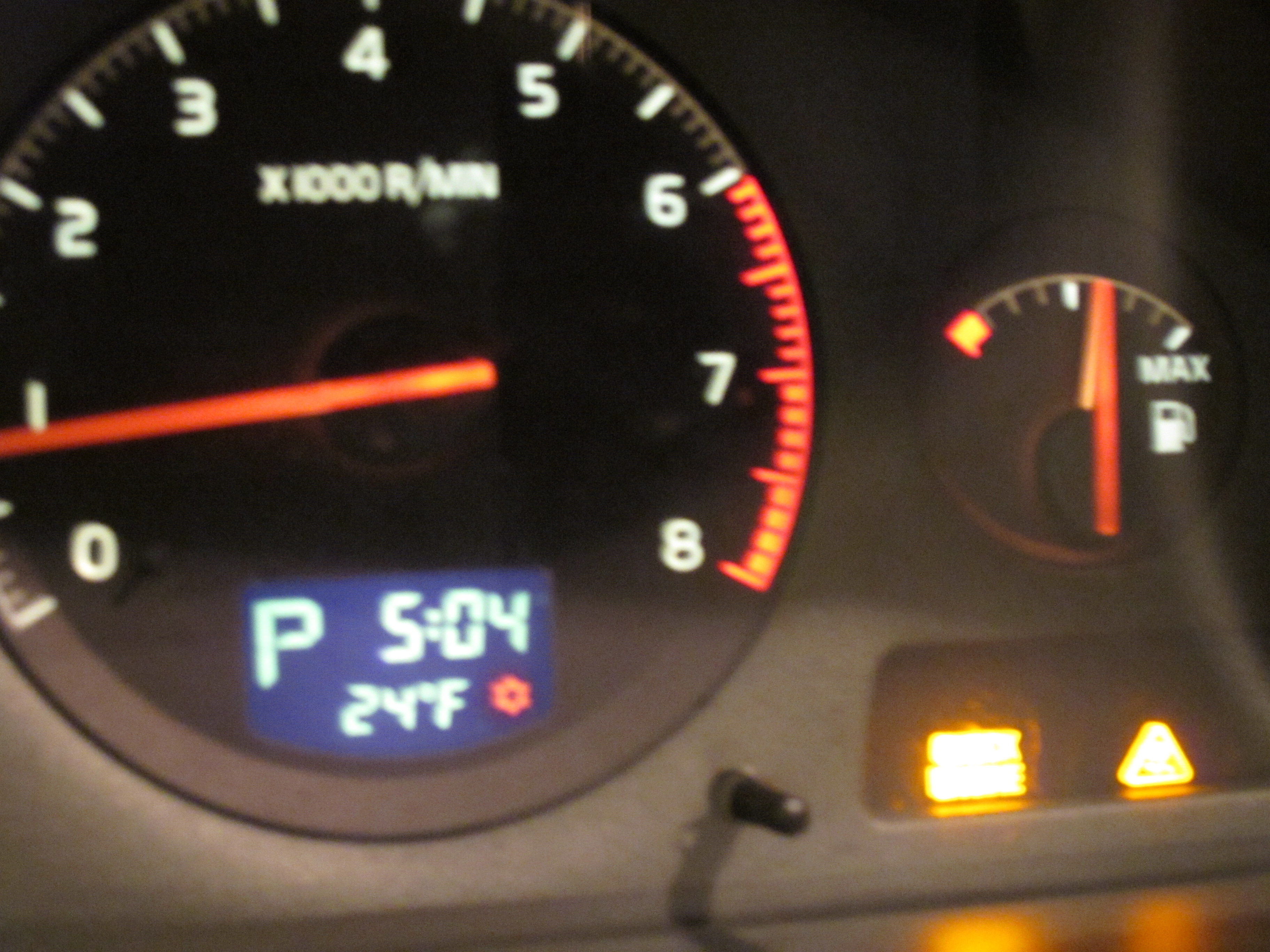

So I don't know weather or not my car came equipped with DSTC/STC but it definitely has the TRACS light associated with DSTC/ STC. When the TRACS light comes on, after 1km or so, it doesn't blink, it just stays solid. I don't feel any pulsating with my brakes or anything that would resemble the car trying to regain traction. In fact nothing changes when the light goes on...it just becomes annoying.
So today I was taking some photos of my TRACS light and the console.
File of where the stc button should be....
While stopped on the side of the road and taking the photos of the dash, the TRACS light turned off :o So it seems that the light will come on around 1km, then disappear if in park for a few minutes.
Tracs light on!
Tracs light on!
TRACS off one minute after being in Park!
Maybe this can help in the diagnostics.
