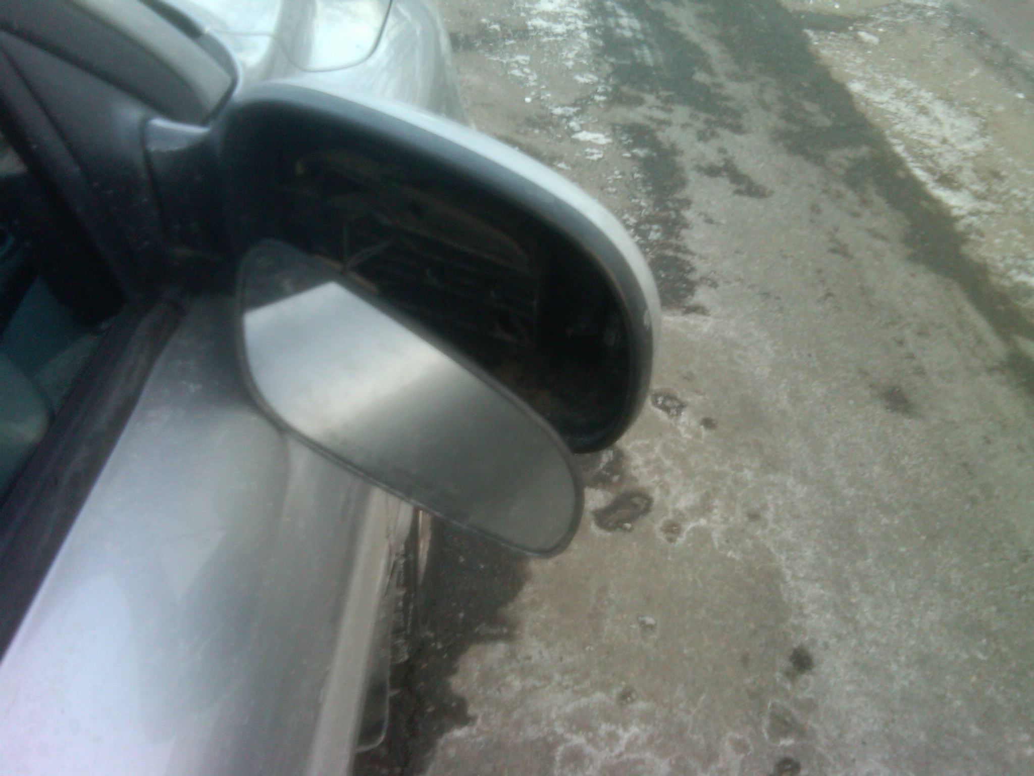

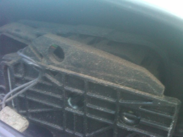

Hello, I was recently forced off of the road and in the process damaged my passenger side mirror. The mirror is not cracked and the motor still works but the mirror it self has come out of the passenger side mirror housing I guess. I apologize if I am not using the proper names of the parts. I have two photos of the damage which are are below. I am looking for a way to fix it or at the very least a repair manual for my volvo.

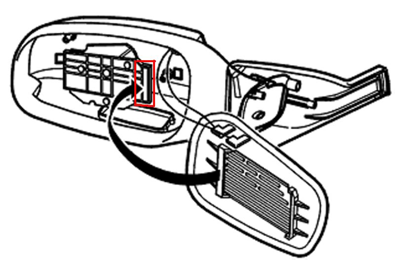

The glass should hook onto the outer edge of the mounting. When I said "unless the hook has been damaged" I was looking at the jagged edge on the right side of your first picture. It looks as if something may have broken off.
I have enlarged the picture from the .pdf to show what I mean.
S80 door mirror.JPG (48.18 KiB) Viewed 1522 times
It looks to me as though the part marked in red is missing. If it is you have two alternatives:
1. Buy a drive unit, either new or used.
2. Attach the mirror glass to the drive unit with either a very strong double sided adhesive tape or adhesive hook and loop fasteners.
